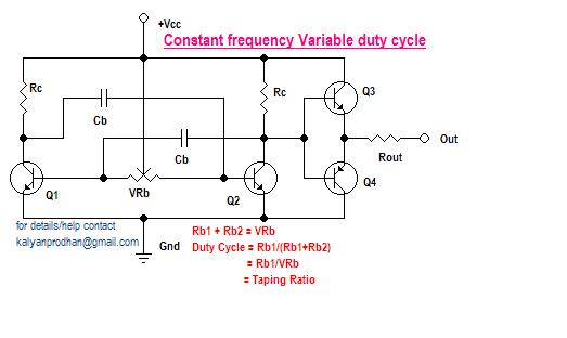

You should propably go with a pulse-width-modulation circuit, I googled "transistor pwm circuit" and got plenty of results. One is in the attachement. You will need to work out the parts values, not too hard, once you understyand the principle. E

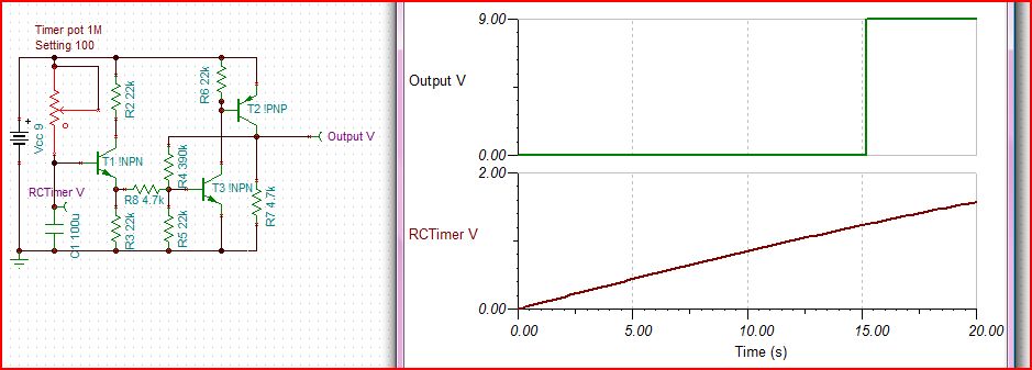

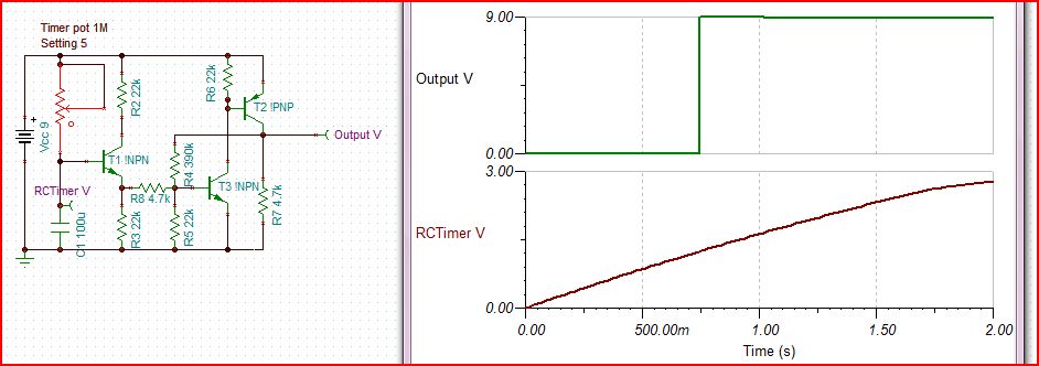

If I understand the competition parameters, you could use transistors (which are arguably NOT ICs), configured as a Schmitt trigger comparator (plus, perhaps given your current requirments, a transistor switch):
https://en.wikipedia.org/wiki/Schmitt_trigger
With an RC timer input circuit, you could control the interval between a "start" competition command and an instant transition from zero to full power to the motor.
Here are some sample schematics (note output delay intervals):
This circuit will need a diode protected transistor switch at the output in order to handle the current load of the motor.

Canadaelk: When I look at the PWM circuits, they seem to be good for speed controls which would essentially be a thrust adjustment. If so, I didn't mention the other problem with the rheostat and other "thrust adjustment" methods in my original post. At the long end of the required time (above, say, 9 sec), a weird thing happens. The amount of thrust required to move the vehicle at all (i.e. overcome the static friction of the car) will then move the car way to fast to reach the required time. Conversely, the setting of the Rheostat that will provide the precise amount of thrust needed would then require a slight nudge of the car (a big violation) to get it moving. Therefore, we abandoned the thrust-adjustment methods.

The circuit would, of course, have an on/off switch. That said, we could just add an LED (a "System ON" indicator) for the judges?
I I may not have made it clear that the delay between circuit power on and output power up is infinitely adjustable (by the "Trimmer pot") between 750 mSec and 15 Sec.
