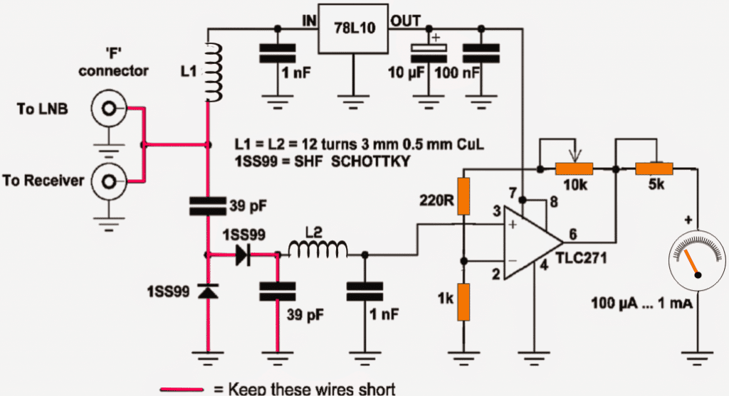

Satellite signal meter Schematic
arvinfx
Will this schematic work? what do you think?
The circuit might work for you to aim the satellite dish to the correct alignment.
The circuit is missing an important 1M resistor to ground at the +input pin3.
It is powered from the DC that powers the LNB at the dish.
Considering you can buy such crappy designs for VERY little money, why would you want to make one?. I'm also a bit dubious about simple detector diodes on a low level UHF feed?, I'd presume the cheap units have an RF amplifier?, but I've never taken one to pieces (or indeed owned one).
They weren't 'too bad' in the analogue days, but you really need something much better for digital, as a minimum it needs to tell you which satellite you actually pointing at - the Clarke Belt is stuffed full of satellites, and it's pretty tricky to find the correct one.
I've got the "commercial" version of that circuit - $5 on Ebay.
It works (but then we have a lot less metal in the sky to point at being Downunder) :)

For this idea, a 78L08 can be subbed with two 1N4001 diodes series-connected, cathode grounded to its ground pin.

If you have any serious plans to invest in such a "project", why be crappy in a getting a decent Signal meter?
