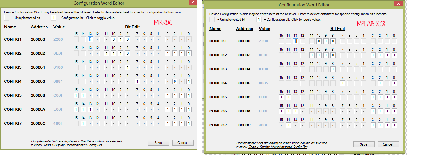

I have written an LCD display project for 16x2 LCD. The code is based on third party library. When the code is compiled on MPLAB v8.10 XC8 Compiler the hex gives output on ISIS but not on Hardware where as if same code is compiled in MikroC (replacing __delay_us with Delay_ms and removing XC8 Header and config bits) the project works fine on ISIS and also on hardware.
Controller is PIC18f452
Crystal is 8 MHZ

The config bits preceived for different hex files by pickit2
What may be the difference? cant understand that. The attachment contains the Project file of MikroC and MPLAB along with ISIS schematic to do the test. Please help me out

no problem without you i could not do this.............. Love your response. Another question that why does this happen i mean if it is for in system programming then why it does not allow system to run properly
When you select low voltage programming... You can't use that pin for anything else...
ISIS doesn't sim this AND!!! Most compilers, including XC8, expect you to set this value yourself..
If your not using the PGM pin if you pulled it low with a 1 k resistor it still should work on real hardware.
Without it pulled low the chip will not start.
