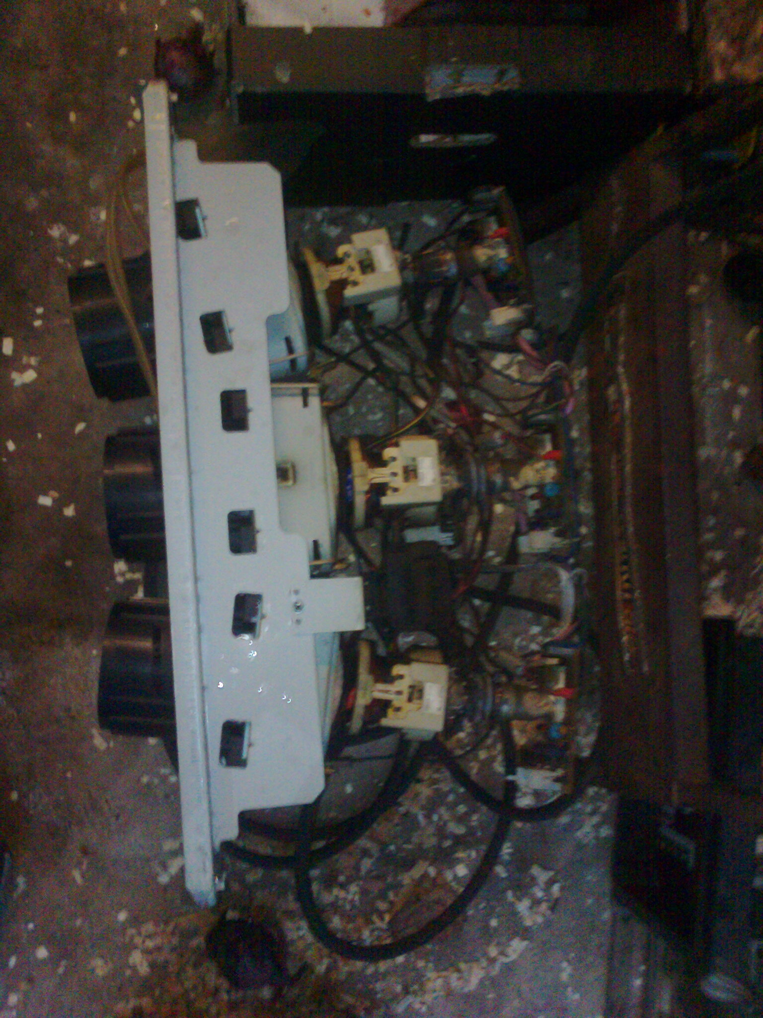

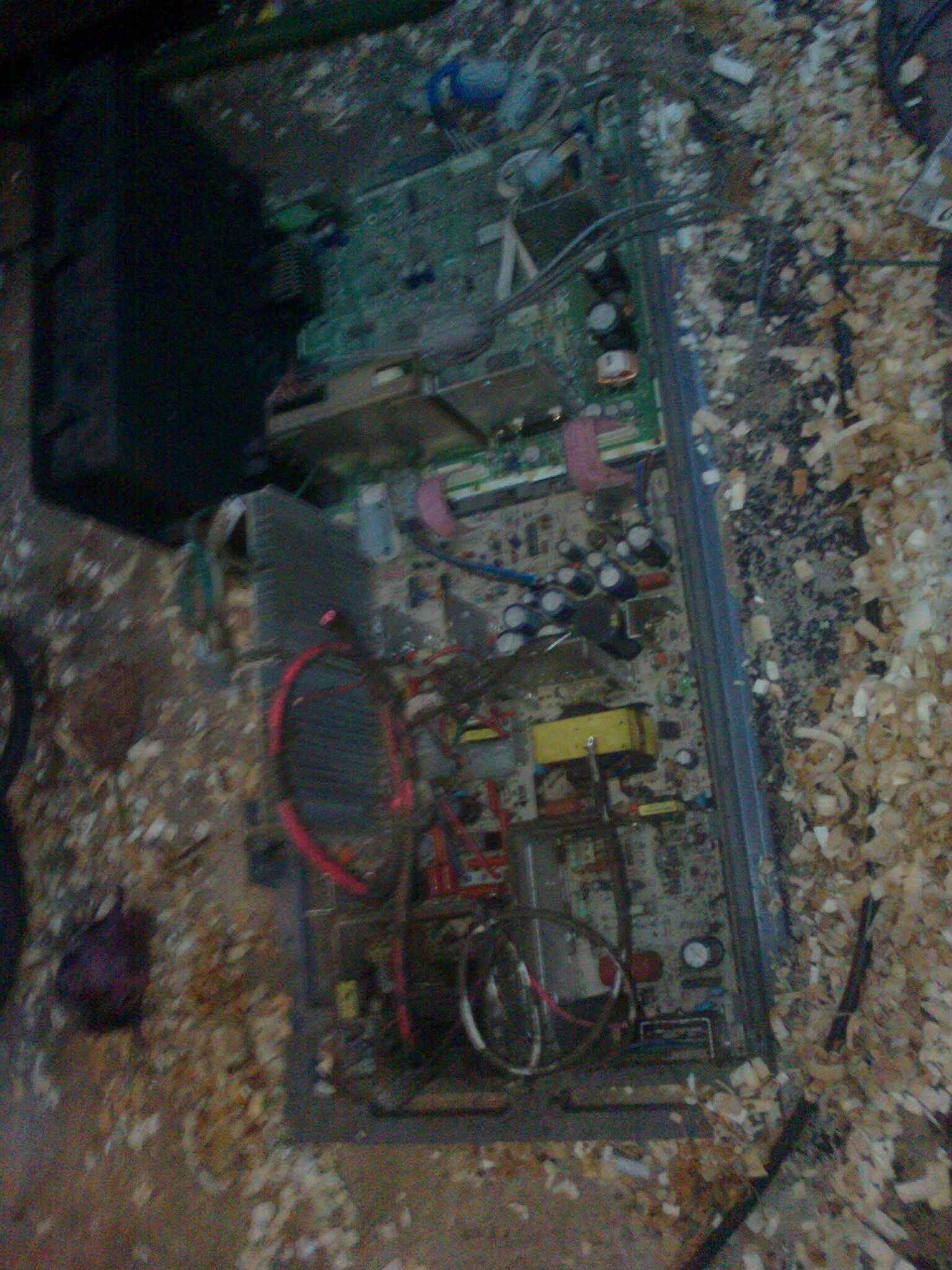

I just picked up a enormous rear projection telly, I'll be busy salvaging from that.
Could you show just few pictures?
The last one I pulled to bits busted, I'll be a bit more carefull with this lens.
My mrs had the same tv before we were married, one night while we were courting and tucking into our McD's the stupid thing blew up, I ended u[ stripping it so I know what sort of stuff's in there.
I'll take a couple of pics yes.
Wasnt all that exciting, just one ferrite of size and thats probably air gapped as it has one switching trans so it'll be a flyback.
The optical assy looks interesting, there is only one lopty, it goes through 2 boxes, one probably a distributor/multiplier, not sure what the other one does it has 6 pots on it, maybe its the usual screen/focus one per crt.
Some high quality lenses in those fittings, I didnt take the fresnel lens or the mirror.
