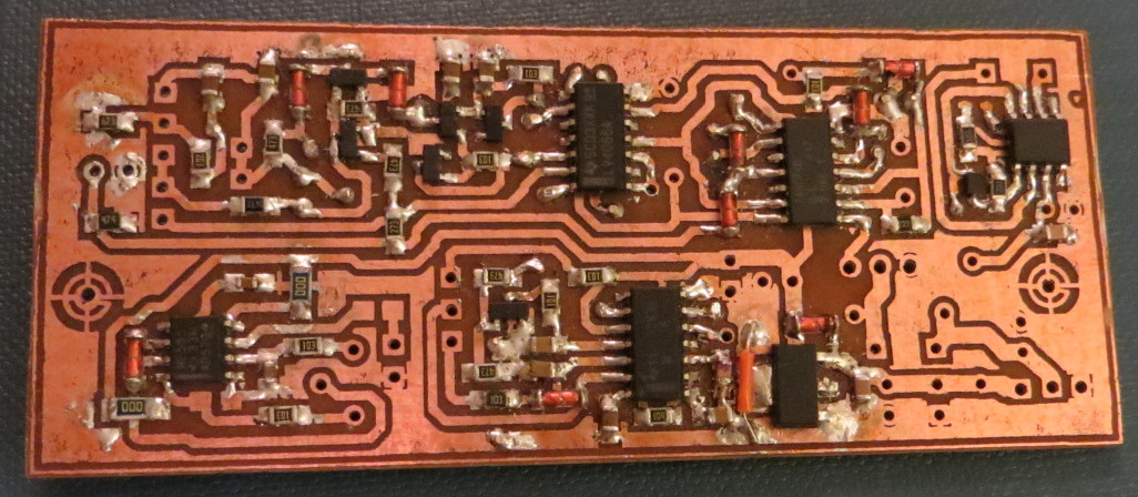

Just having great success re-using some SMD components I removed using a heat gun a couple years ago, been keeping them in a little pot. And now I have a soldering iron with a bit that has a long straight edge I can desolder individual devices from scrap boards, to use. I'm using Mr RB's small cap meter to find the cap values I want. Made myself a tweezer probe so I can find the caps I want in situ on the scrap boards.
One good thing I've discovered about using scrap smd's compared to new ones is that they are easier to solder, because they have enough solder on them to initially tack down (with a bit of flux on the track). I'll post a photo when it's done.

Just finished building SMD side of this board. Still got holes to stuff. Anyway, there is a 4066 on there which came from a Sky box, and all the R's, C's, T's and D's are board pulls. It is supposed to have 2x 6.8v zeners at the top right, but I could only find one so I'll have to put a wire ended one there for now. The orange thing at bottom right of centre is wire link I had to put in because the pcb symbol for the voltage regulator was wrong, had tab connected to gnd when it should be to o/p. Didn't realise until I started checking connections when building. Had to take reg off again carve around tab. Grrrr.

I would love to do Surface Mount, but I have not found a way. (Old and creaky. Poor eyesight.)
I had thought to change to Brooklyn Style, but It's hard to find 'islands' small enough.
Suggestions?
Suggestions?
I use a big illuminated magnifier so I can see what I'm doing, hold the components down with the tip of a small craft knife so they don't shift easily. Soldering would definitely be easier with more spaced out parts and larger lands, so you could over-size your pads. (eg, I've been making boards for 0805, but occasionally have to use 0604, so there is a lot more room on the pads!)
By Brooklyn style, I take you mean "dead bug with islands"? I've seen diamond coated mini hole saws, a few mm across, so you could use one of those.
