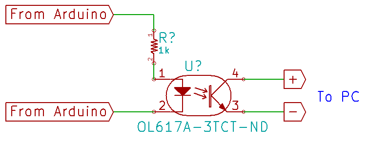

Hey all i am wanting to hook this relay up here:
What i am wanting it to be hooked too (output) is the pwr and reset switch on a PC motherboard to act as a momentary switch:
So i am thinking it would be hooked up like so:
And here is the schematic:
Thanks!
so? go ahead, you have my permission
is this just an announcement to the world that you are ready to connect something or there is a question?
if you ask me, it is safe to connect according to you plan but it will not work.
main problem is that you are trying to use high voltage, high current, AC SSR to drive something that is DC, low voltage and low current.
i would also educe value of R1.
