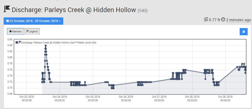

I work to maintain a network of stream gauges to report water levels for flood prevention. We have a couple gauges (meaning everything from the sensor to the transmitter) that are acting really strange...and I'm hoping you can help me figure out why. During evening hours the transmissions aren't making it to the base station, but seem to work fine during daylight hours. Everything in the system has been replaced and the batteries are fully charged, but consistently this problem keeps coming up. Does this sound familiar to anyone? We're scratching our heads over here and I love to buy a drink for the one who can figure it out.

All the Creeks and Rivers in Canada are monitored by a government agency and these graphs are Readily available.
