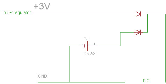

My project is an aquarium control system. A 5V power supply supplies a 5V LCD and then is reduced down to 3.3V to supply the PIC24F. The PIC uses 8 PWM channels to simulate a sunrise/sunset. In addition I am using 4 ADC channels to measure pH, temp, ORP and salinity. I output these values as well at the current date/time to the LCD.
All of the above is working very well. I am looking for something to maintain the RTCC if the power goes out. I do not need to run the LCD or any other features. I just do not want to lose the clock.
I searched online and from what I can tell is to use a CR2032 as a battery backup with a schottky diode.
Does anyone have a circuit they could share? Anyone have code they could share for putting the PIC into and out of sleep?

My latest diagram is outdated, so let me see if I can throw something together. I was hoping to not have to recreate my project and was looking for a solution to reduce the power consumption. Is there a way to see how much power the pic consumes and have bettery that covers that consumption for 24 hours? I would also need a way to disable the LCD.
Bypass the 5V regulator, feed 3V directly to the pic from your back-up battery. Provide a means for the PIC to sense the absence of the 5V (voltage divider to digital input pin?). Modify the code to go into a "power saving" mode whenever the 5V is missing.

How is the PIC powered when the power is up? By the battery? If not how do I prevent the battery from back feeding to the 5V LCD?
Two Schottky diodes?
Any low-current Schottkys. PIV only needs to a few volts. Max current is < ~50mA. If you want 3.3V at the PIC VDD pin during AC operation, your intermediate regulator should put out ~3.7V. A 3V battery minus the 0.3V diode drop will run the PIC, although you might want to read the data sheet about what happens with VDD=~2.7V.
Are both Schottkys the same size? What is PIV? Also so I understand, the Schottky diode only lets voltage travel in one direction. Also because the voltage from the AC is higher than from the battery, the diode does not pass any voltage to the circuit. Is that correct? Will the diode leak any voltage?
