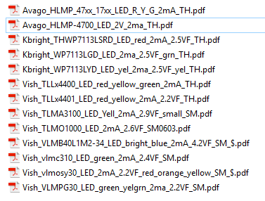

Hy Andy,
Here is a list of high brightness LEDSs (none are white though) which are specified at 2mA and some have a forward voltage (VF) of around 2.5V:
