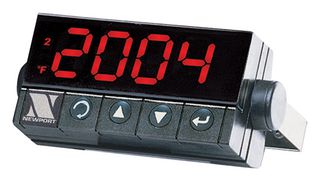

I need to feed the RS232 output from a PRO3600 inclinometer directly to an indicator without using a PC intermediary. It's mostly for cost savings and power requirements I want to eliminate the PC. The problem I'm running into is finding an indicator that will properly display the output of the PRO3600 without having it fed from a PC.
The output of the PRO3600 is a + or - sign, a space, xxx.xx numbers, a cr then a lf. I've bought two indicators but neither will display correctly. I can't remember the part number of the first but it appeared the cr would screw up the on screen display each time. The second, a RD4/N works with the negative sign displayed but it doesn't know how to handle the + sign and never gives me tenths or hundredths on the display when in positive angles. I've contacted the company and they say it's a firmware problem and are unwilling to help.
Short of buying more indicators and seeing what would happen, anyone have useable ideas on how to proceed?

What that means is that you must have some manner/form of computer or microprocessor (w/ an RS-232 port and a display) to capture/display that data. No way around it.
It doesn't have to be a PC (running MS Excel), but it will have to be a "PC-like" device, such as an Arduino or a Raspberry Pi (there are others as well). Any of these devices can be configured with hardware and software to perform as you describe, given the constraints imposed by the rigidity of the data generated by the 3600.

The LF would be a basic problem for even a simple terminal because it would be list. I think you would want to strip the LF and only output the string IF it did not change from the previous value.

Here's a display too. https://www.crystalfontz.com/product/cfa533tmiku-display-module-usb-16x2-character Note that pretty much they all have commands to control them, so a simple monitor is not likely to work.
In this one, https://www.redlion.net/product/225-6-digit-led-serial-slave-display-rs-232rs-485 you need a specific format.

Find a display/displays that fit a basic footprint that you could substitute if necessary, e.g 1/2 DIN so your not locked in to one manufacturer. If you need mounting hardware or bezels, look at that too, What type of power is available?
I just see the basic structure of:
Power up: Display: *****.** or whatever.
Power up reading: On power up, look for a Line feed. Ignore the first stuff.
Now your synchonized.
I'd continue to make sure the data is valid. e.g. the right format until you program a "LF expected" state.
So, LF becomes the synchonization character.
You could make the routine a bit better by clearing the communications buffer on power up and start the state machine with is it a "+" or "-" then continue by processing as though you received a LF followed by a + and -.
So, this method effectively will allow the display of the first number. If there is junk in the buffer, you'll be looking for a LF to reset the state machine.

Run some rs232 snooper software on a seperate pc and see what traffic there is, then it might just be a case of knowing what data to send and emulate the controller with a processor.
As Ian said, this should be a simple task with a microcontroller and a 7-segment LED display.
I have an existing board that has an 8 digit display in 15mm tall digits. If a negative sign only will suffice (negative sign or blank for +), I could easily do this for you using existing hardware.
