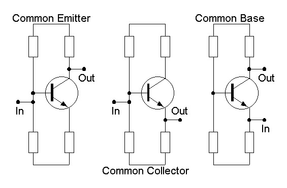

Is there some reason you don't want to use an opamp?, they make it far simpler.
But here are the three standard transistor modes, I would suggest the left one (common emitter), add coupling capacitors on the input and output, and one across the emitter resistor to increase gain (if needed).

Something like this???
Nigel i have no idea how to do it, i'm still learning you know.

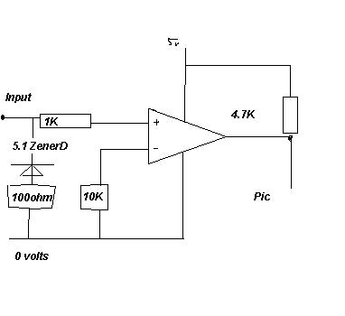

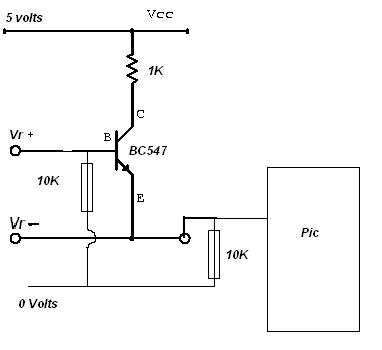

Found this part of emitter common have adapted it a bit..
What do you think??
From Vr+ to ground (o volts) i think i need to bult in a 100ohm resistor in series with a 5.1v zener when the voltage generated by the Vr sensor is higher the zener will keep the base voltage low right??

That's in common collector (again!), and gives no voltage gain. It's also pretty doubtful it would work as it's not connected correctly.

The +ve supply goes to the top, and the 0V to the bottom, it's pretty standard. You would need to work out the resistor values, which is why I suggested an opamp is easier.
