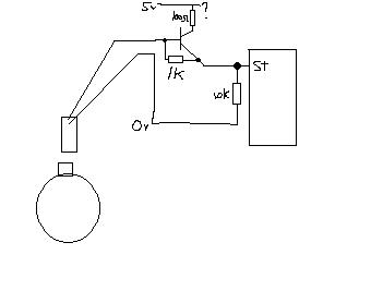

1) Is the sensor JUST a coil, no electronics.
2) What is the output level of the coil?.
3) You may be able to connect the coil through a simple series resistor directly to a PIC pin, nothing else required!.
Ok,
Will determine first you question before asking more,
anyway, here is a circuit i drawnup to test if i untherstanded you,
Nigel

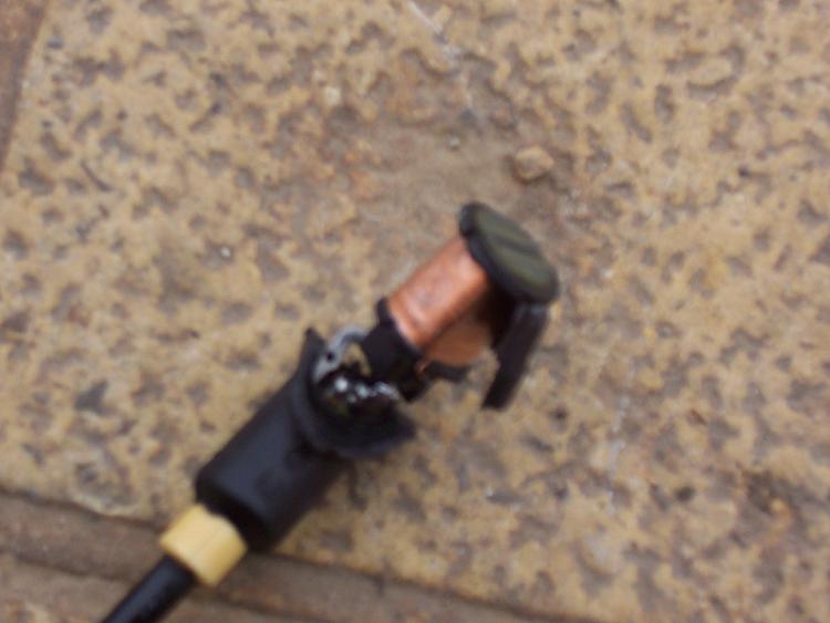

With an inductive trigger sensor for the cars engine, I use a LM1815 to read it. I don't think this helps you though, without knowing more about your ABS sensor.
It's odd that this is a straight inductive sensor. Usually ABS wheel sensors give a square wave signal.
well...
mhh...
This is the picture..
the upper bar you see is in the coil and its a permanent magnet, i think that the pulse coming from the coil is to short to be noticed by the multimeter.
the abs ring has allot of teeth and there are also very small sow think that is the problem for the multimeter.
Tks

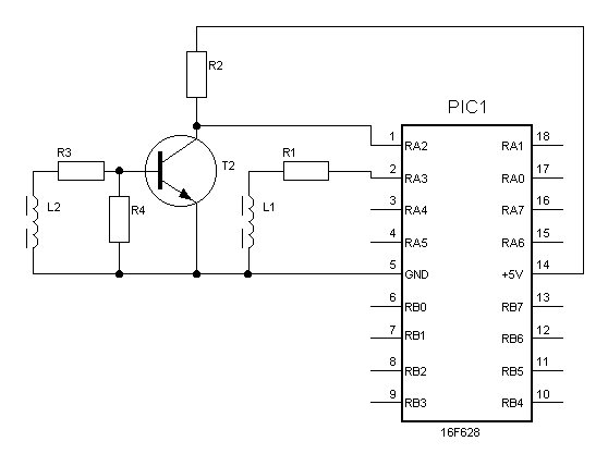

Nigel in you sheme i need some values,
i know that they will depend on the coil output,
but i have to try something right???
alos where do i need to put some pots to be able to adjust everything??
i mean to say to search for the setting??
In your T2 scheme i would like to take for R2 = 1K R4 10K and R3 4,2K
the NPN will be an BC547c do you think it should work????
also if the voltage is lower then 0,6 what to do??
Tks
They sound reasonable values to try, you might increase R2 to 10K, there's no need for it to be so low. A BC547 is fine.
Amplify the signal first!.
