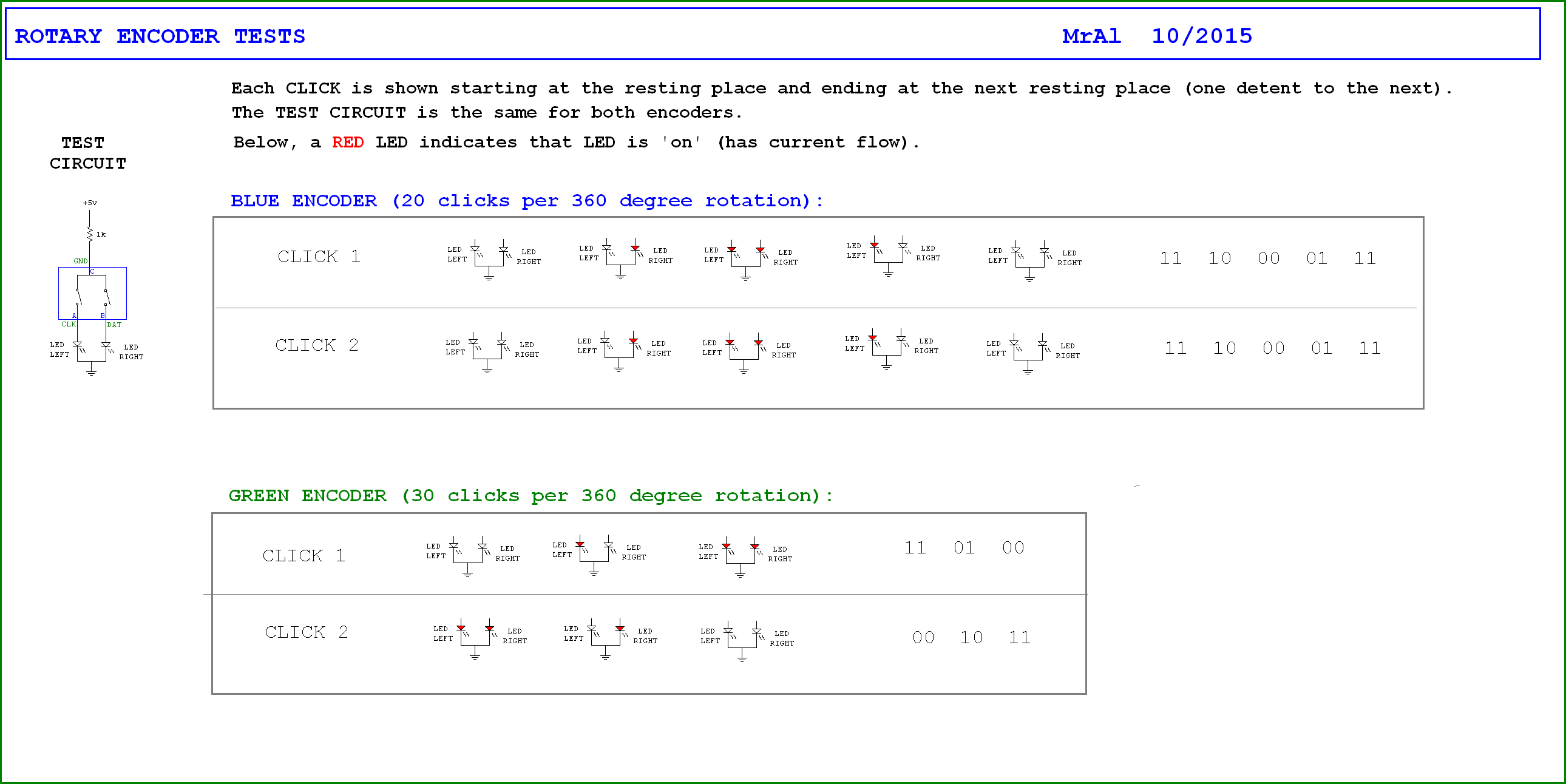

I may have made an error when i reported the sequence 01 10 because there is always an in between state 11, but one encoder stops there and the other encoder does not stop until it gets back to 00.
In any case, i tested both encoders again and carefully logged the LED's that come on and stay off during the course of each click. As the attachment will show, they both go through the intermediate state but one stops there and the other doesnt.
I also converted the test setup LED observations to the actual code the uC chip would see this time. So a '1' indicates that the uC chip would actually read a '1', and likewise for a '0'. So if the code shows 10 for example, the microcontroller chip would see a '1' on the first pin and a '0' on the second pin.
I also show the relationship between the CLK and DAT lines and the A and B data sheet lines, but it's hard to tell if this is accurate because it is hard to follow the traces on the boards themselves. They do look the same however.
The waveshape on the PEC11L or PEC16 series encoders seems to match the BLUE body encoder, which is the top one in the diagram.
So the codes came out to:
BLUE ENCODER: 11 10 00 01 11 for one click, and 11 10 00 01 11 for the next click (same).
GREEN ENCODER: 11 01 00 for one click, then 00 10 11 for the next click.
So the blue encoder always stops at both internal switches open, while the green encoder sometimes stops with both open and sometimes with both closed. Both encoders of course always start from the last code that they put out because that is where they 'rest' after the shaft is no longer turned.
That's really of minor importance, and can be handled with little effort. More importantly, it is good to see that it is a proper Gray code, because the set of transitions: 00 01 10 00 would have led to some ambiguous counting. The transition from 01 to 10 could never happen with both outputs changing at precisely the same time—one would always switch before the other. A make-before-break transition would lead to: 00 01 11 10 00 which would be a proper gray code, and unambiguous. However, a break-before-make type of transition would lead to: 00 01 00 10 00 which could not be decoded correctly without some inference about debounce time.

Yes, i was thinking that too, but then again they are not hard to test, at least not the mechanical switch type. Once you test them you have the code it puts out, and it only takes two LED's and a resistor or two to test them.
True enough. In my situation though, I've written a bunch of encoder routines in assembly language, and I'd rather not have to redo them because of a non-standard encoder code, especially when inexpensive quadrature (Gray code) encoders are readily available. (You may have missed my post #45, because I posted it almost simultaneously with your last post.)

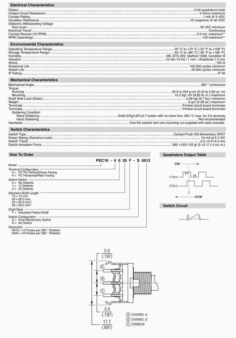

But they seem to work ok once the code is found. And i think they are one of the PEC16 series by Bourns, and their data sheet lists the output waveform.
Unfortunately though, if you look at that data sheet you still wont be able to be sure how the code is output. That's because it looks like they show a generic waveform and they dont make it perfectly clear what each click does. I will post the drawing they give so you can take a quick look. Look at the waveform near the bottom of the page and see what you can make of it...

Hey Al,
I agree with Bob, they both have to be Gray Codes.
The Blue is a full Gray cycle per detent x 40 per rotation of 360 deg or 9 degrees per gray code cycle.
The Green is a half Gray cycle per detent x30 per rotation of 360 deg. or 24 degrees per Gray Code cycle.

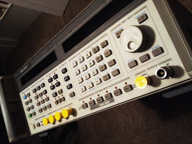

Mechanical rotary dials are no way as nice a user feel as ball-bearing optical jog controls or finger dial-jog controls.
Although I have seen an MP3 player with capacitance tough PCB for a DJ controller in a radial PCB pattern with very nice user feel. The only moving part is the user's finger.
HP has always used high quality optical rotary controls with very smooth bearings with a light weight viscous feeling to control 10 digits with one finger with high acceleration, velocity and fine position control with step size switches.

Yes about the Gray code, first, you are one of the few people that get the spelling right, so congrats to you :)
Second, yes, I had reported the code incorrectly one time. Instead of:
00 10 01 00
it was:
00 10 11 01 00
or if you care to invert:
11 01 00 10 11
or turned in the other direction:
00 01 11 10 00
And yes, one of the encoders only goes half way or something so it does not register any click until after two clicks with the code that works with the encoder that spits out the entire sequence as shown above.

Also, when i plug the half code encoder in where the full code encoder went, it takes two clicks to get it to register one single count. It might be tricky to get both to work with the same code, but if you care to think up some code that you think will work with both types i'll try it out with both encoders as the program code is so easy to change.
