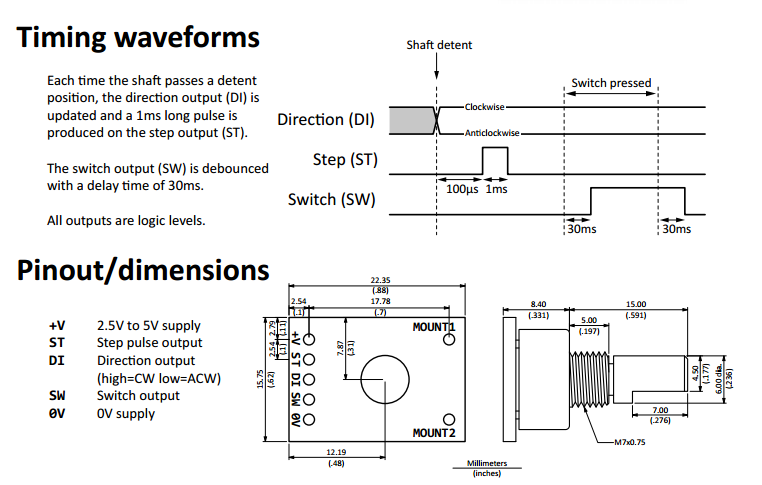

Got the encoder/decoder today and had a play with it.It looks like I misunderstood once more how these things work.It goes from 0 volts when turned anti clockwise to + 0.5 volts when turned clockwise,but stays there when you stop turning.It gives out a 1ms @ 0.5 volts pulse every time it passes a detent,and will give them out even if I turn it as fast as I can.Will this system still work for what I need to do here?
I think your off by a factor of 10. x10 probe on scope, possibly? So, you may own a scope?
A naked encoder basically looks like two switches out of phase. To be useful, it has to be decoded. The encoder you got is 24 pulses/revolution
pulse/direction or UP/DOWN
UP/DOWN
The UP/DOWN interface isn't recommended - it's like pushing one of two buttons on a remote (ROW/COL interface). It has a timing issue. Code is sent for as long as button is depressed.
The CLK/DIR
That's operating lke your seeing except for the levels (5V vs 0.5 your supposedly seeing). The DIRection stays in whatever state it is or was. so, when you stop turning, it stays in the direction it WAS moving. At every "detent" there will be a pulse no matter what direction.
The 1 mS may be too short of a pulse to use directly, but that can be extended.

Gotta somehow make finger turns create pulses that don't skip a beat and are reasonable. 1 to 4 "finger turns" fot full volume control. A "finger turn" is grabbing the knob and turning some distance. Might be something like: one "finger-turn" = 1/2 turn of the shaft.
Yes I do own a scope,and no it's just a basic probe.The specs for the unit which I didn't fully understand before also say it's 1ms for every detent pass and it's delayed by 100us,which is exactly what I was getting,a perfect squarewave with just a touch of overshoot.

So, the idea at this point is to have the DIR control CSEL directly. There is no LED indication on transmit. Do you want that? Do we need that even for debugging?
Then to STRETCH the output pulse from the CLK output from the decoder and make it the minimum length required or minimum code required. If you capture 1 sec or so, you can send 100 mS of the capture, for instance. Your scope can help here. 20 mS has to elapse before another pulse can be sent.
If necessary, we'll divide the CLK out of the decoded signal by 2/4/8/16.
