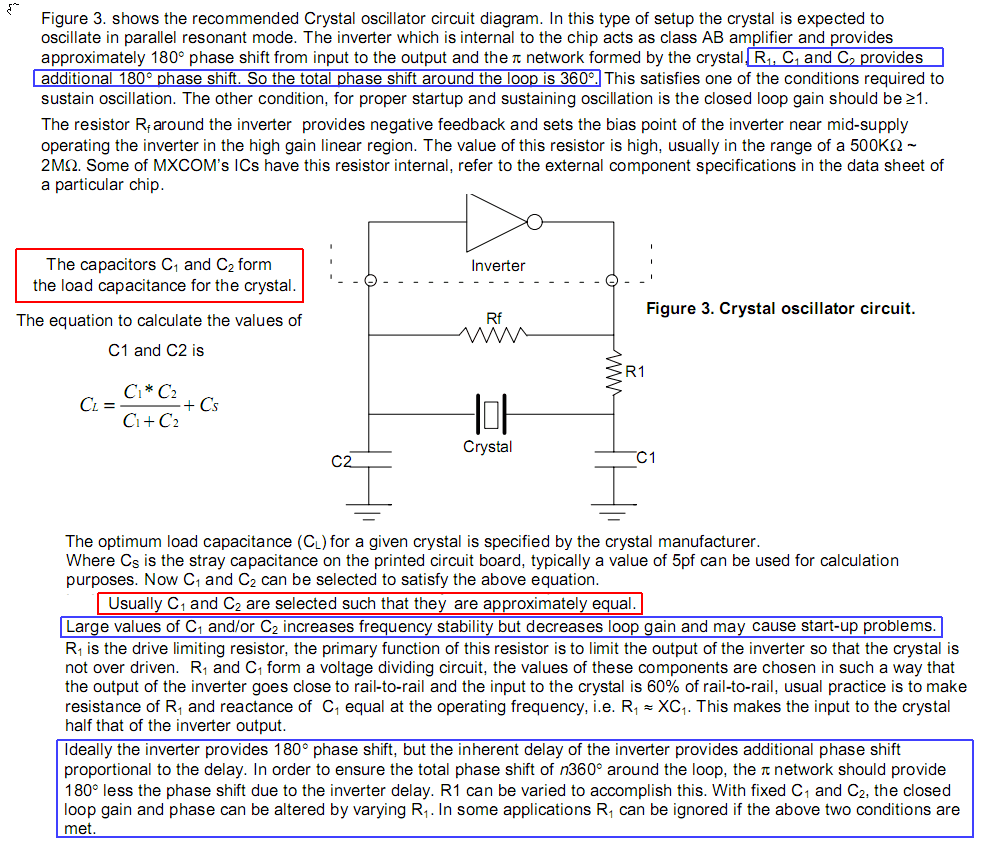

Look at this pdf.
EDIT:
To make it clearer what are the requirements for the external capacitors I have edited the datasheet in order to highlight the importance
of the external components.
Hopefully this will dispel the 'Forum folk lore' explanations for the components.
  • 2001SEP06_AMD_AN.PDF

Nope, that is exactly the OWT that this thread is trying to dispell!
The capacitors are there to resonate with the crystal inductance and cause the crystal to oscillate on its fundamental parallel-resonant mode.
The reason that there are two capacitors in series is to create a network that creates a 180 degree phase inversion at resonance, because the amplifier (inverter) has a 180 degree phase inversion between its input and output. This makes the loop gain have a net phase shift of 360 degrees, which is what causes it to oscillate (look up Barkhausen Criterion).
This is a Pierce oscillator; (look that up, too).

Here is a pretty good explanation of what the capacitors do, and how the inverter inside the PIC makes an oscillator.
  • CMOSosc.pdf
That PDF recommends using a feedback resistor between 10-20meg on low crystal values basically anything lower than about 6mhz. I've never seen that before, but the explanation in the PDF is quiet good. I wonder how much this effects accuracy on something like real time clock crystals because I can't recall ever seeing a feedback resistor in a real time clock circuit.
The 10meg resistor is needed to "bias" one-sixth of a hex logic inverter into the linear gain region when the inverter is used as the gain block of a crystal oscillator. The resistor effectively turns the CMOS inverter into an inverting amplifier (phase shift of 180 degrees), with high input impedance, fairly low output impedance, with a gain bandwidth product of several hundred MHz.
The two capacitors in series resonate with the effective inductance of the crystal at its parallel-resonant fundamental mode. The common point between the two capacitors is ground, so the crystal+2capacitors network has a net 180 degree phase shift between its two ports, which when combined with the 180degree phase shift in the amplifier adds up to 360, which means oscillation (loop gain >1, phase shift = 0 dgrees, or multiples of 360 degrees). That is by definition a Pierce Oscillator.
The inverter integrated into a PIC chip or other similar IC doesn't need the external 10meg resistor because it is integrated inside the chip. The reason that sometimes the capacitors can be left out (and the oscillator will still oscillate) is because the pad/pin capacitance of the two pins at the input and output of the inverter have an intrinsic capacitance pushing ~10pf, but it is not good to expect that the crystal will start reliably if you leave out the external capacitors.
