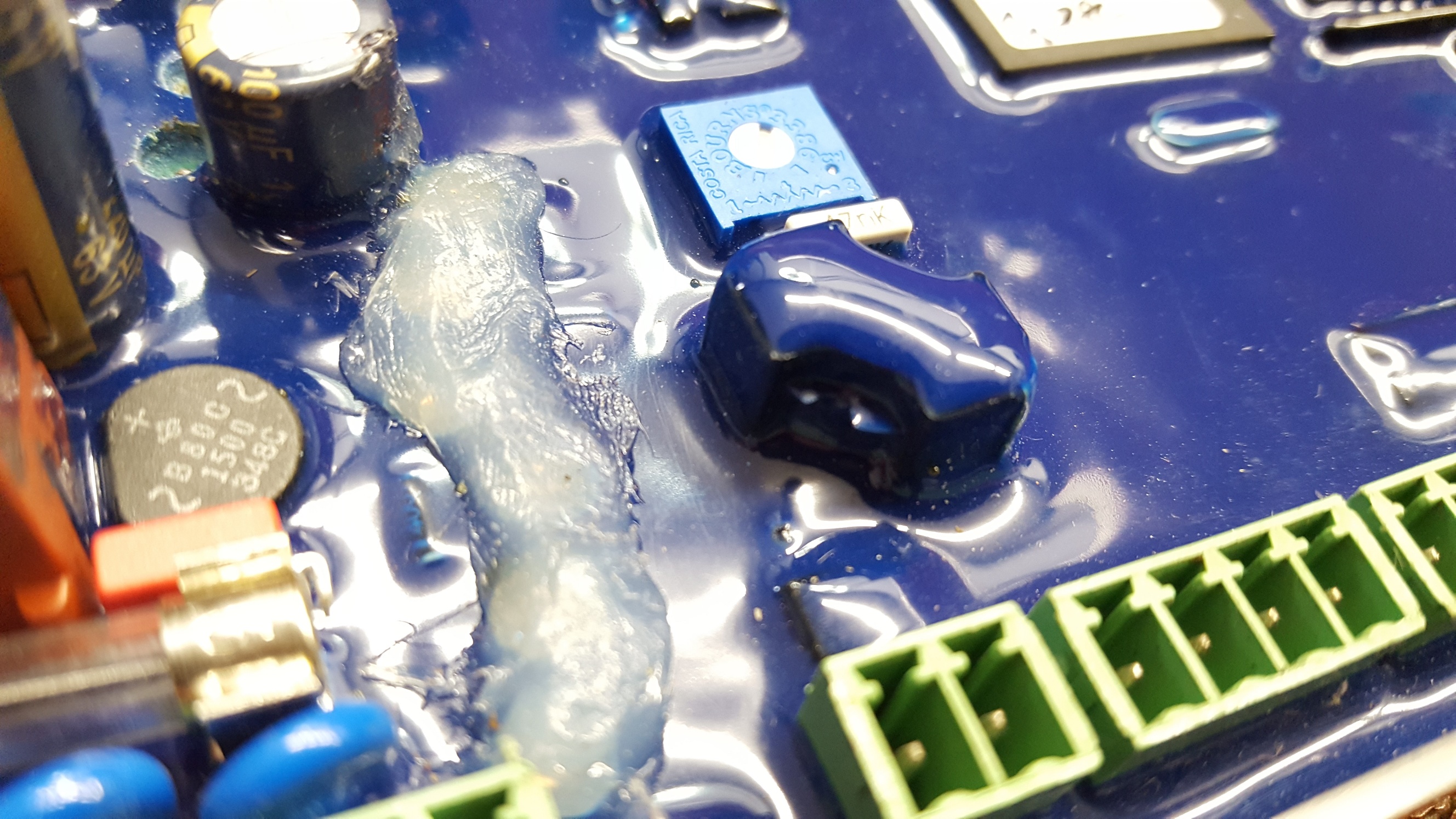

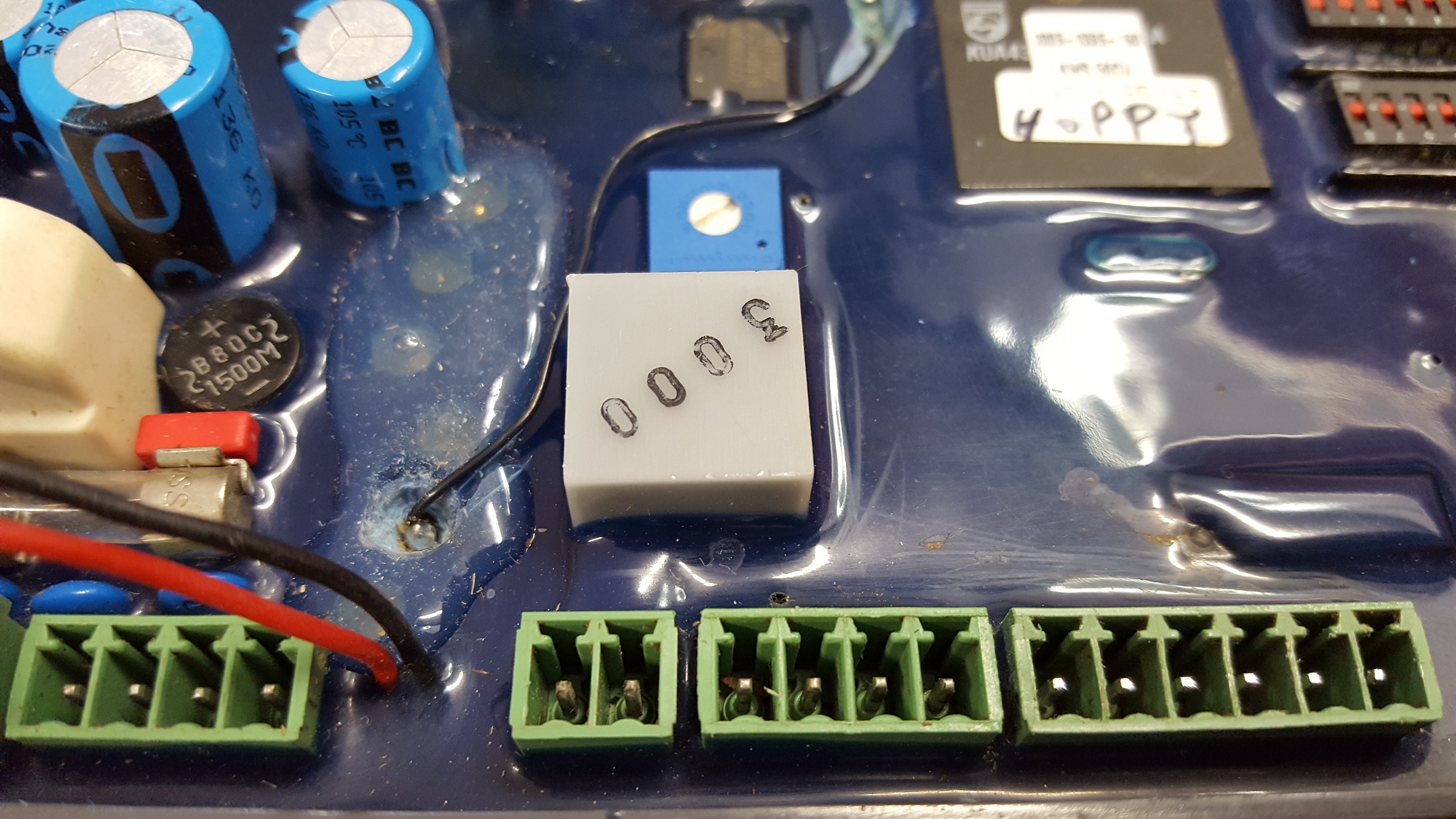

Usually open circuit ... broken wire.
By the time I get them out I have to start again anyway. Of all the ones I've removed, I've never got one fully apart without breaking something else ... usually the core .. or the former pins.
I'll take some photos to show you why.
First photo it's potted in the box with 3000 on top ... and second photo it's just potted with everything else. Really helpful! :)

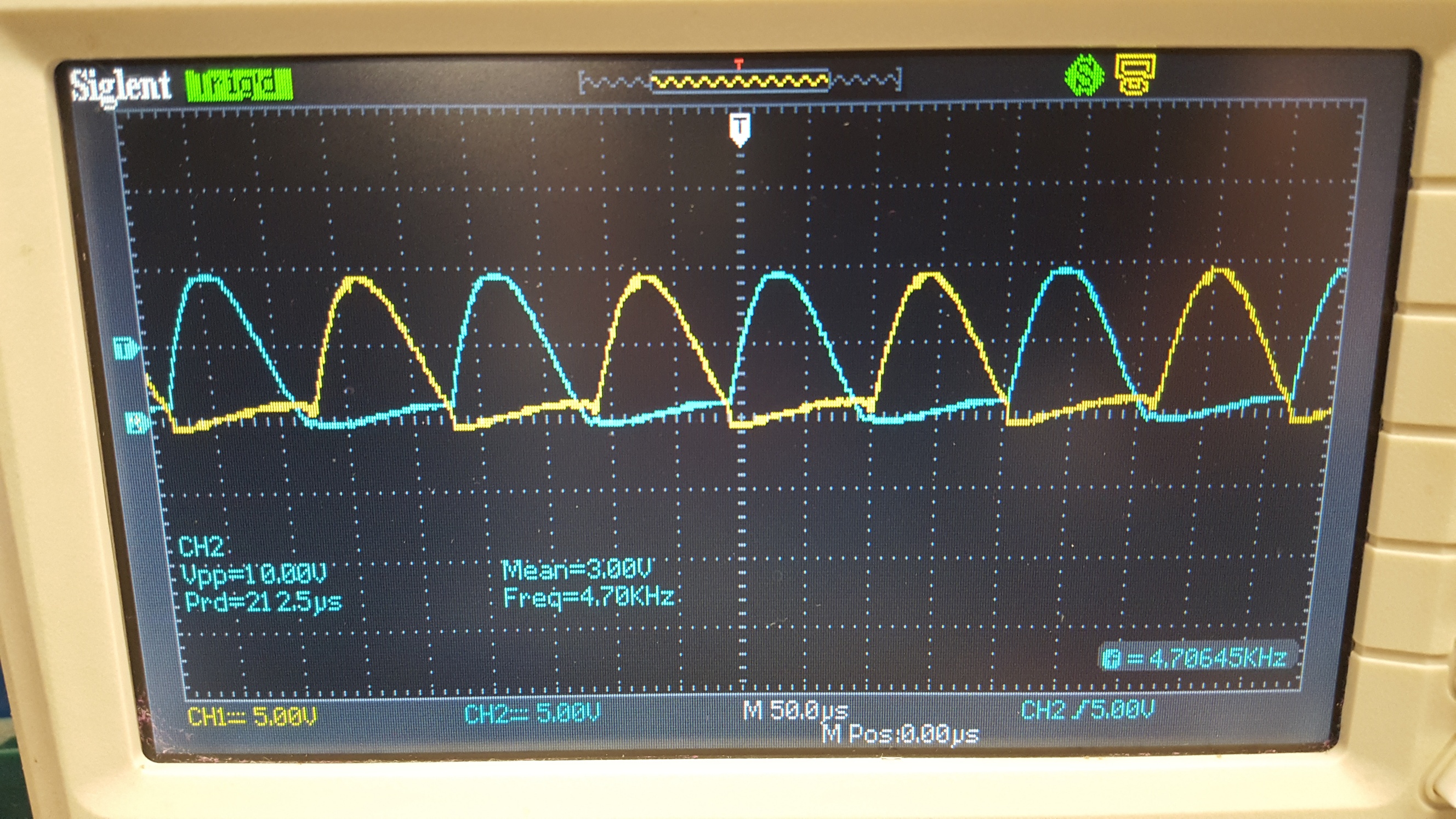

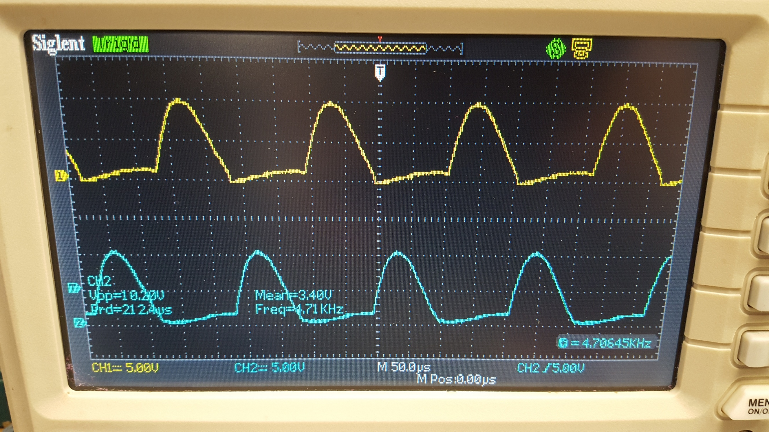

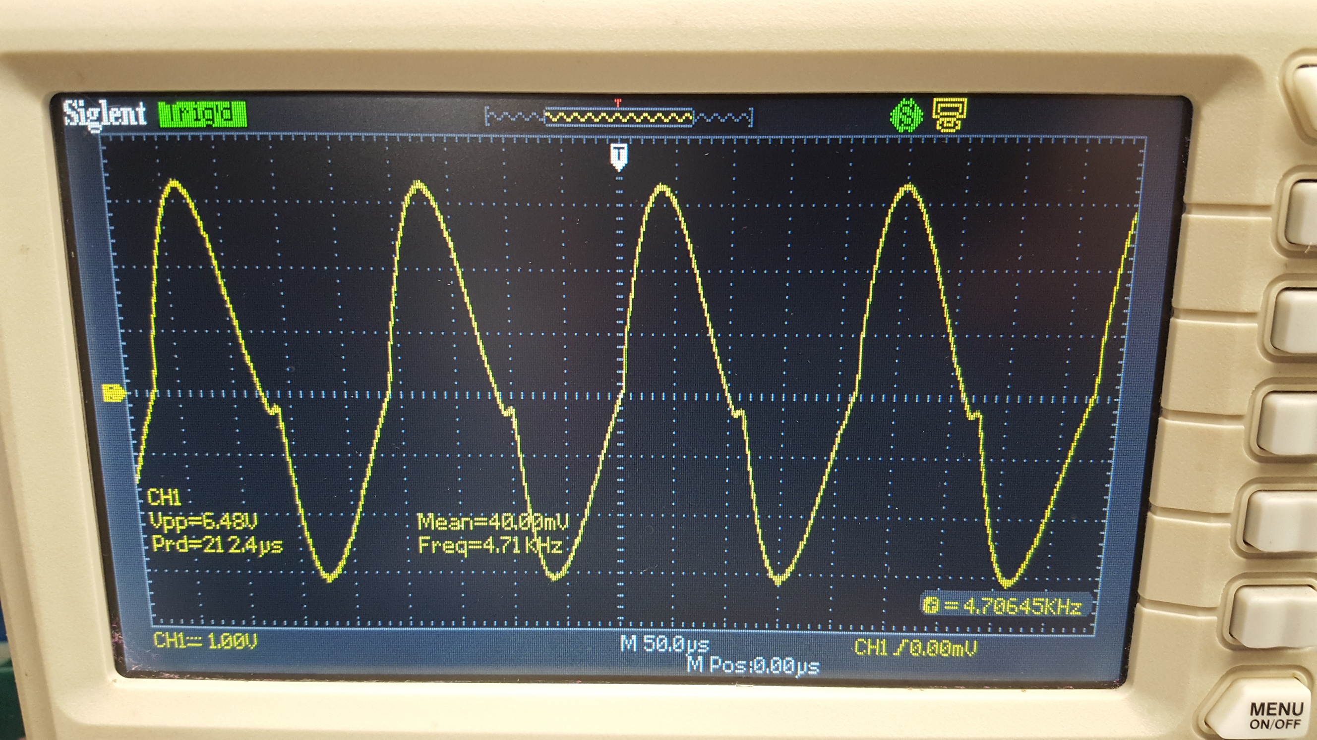

Could be a push pull switcher, but that frequency is pretty low. What does that 4V signal look like? (o'scope image) Can you get at the pins of an operating board with two scope probes to look at the two outside legs of the primary winding? I'd be interested to see the waveform and timing of those two signals.
Sorry for slow reply ... I'd already sealed up the last ones.
Here are 3 shots ...
First is of outer legs of primary ...
2nd is of same ...
3rd is of secondary ... unloaded
