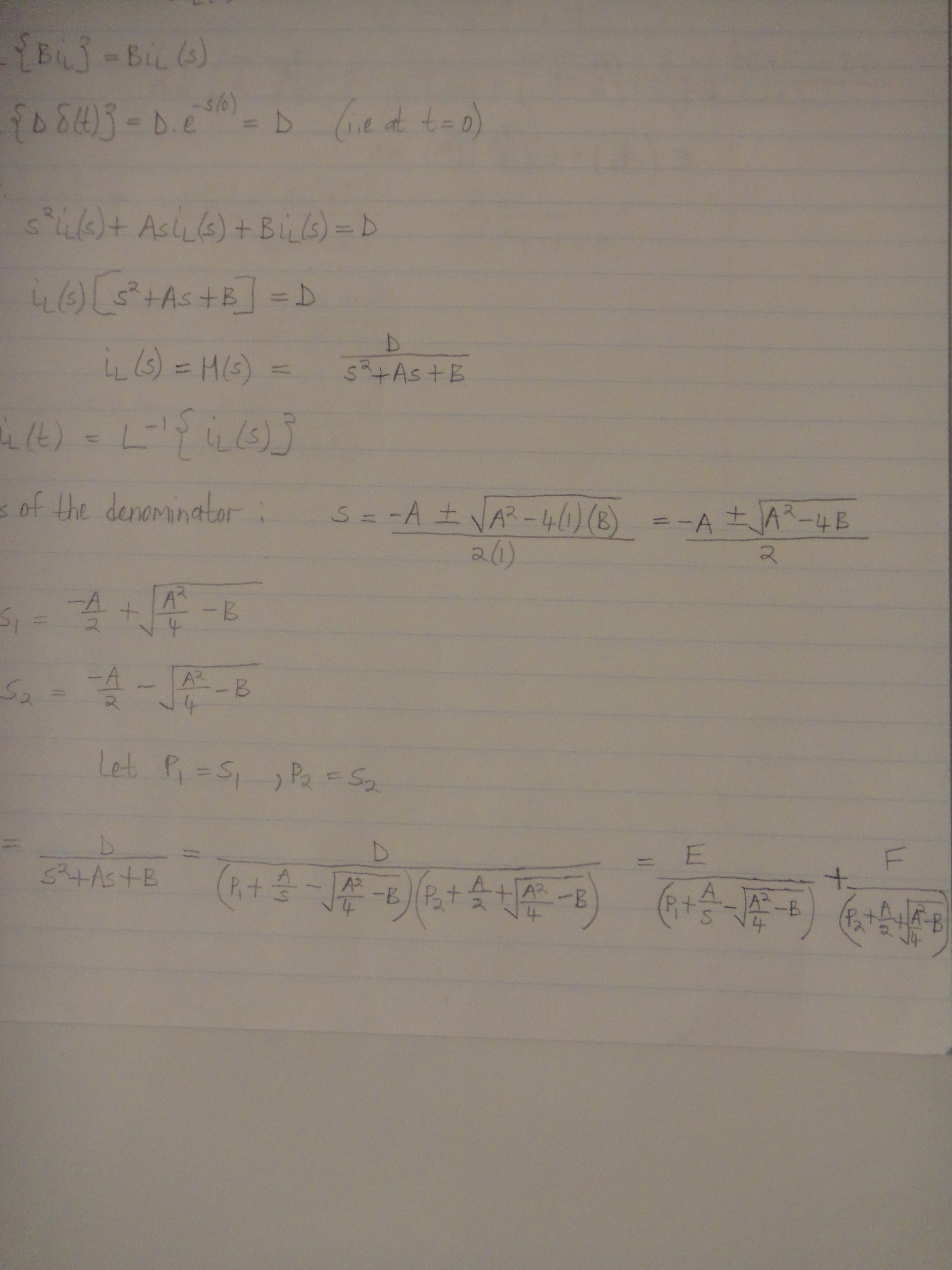

I just read the demands of exercise now carefully, They are asking to express the answer in form of A,B,D and P.
I attempted part a and b
In part a , am stuck after , can you please check and let me know if i am doing right?
That looks right so far, but it is kinda hard to read.
