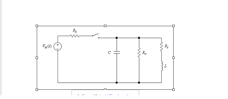

RLC parallel Circuit excited by 2 dc voltage sources
anampiracha
can somebody help me please in solving this application exercise. I am not getting it. I am stucked at the very first step. formation of equation

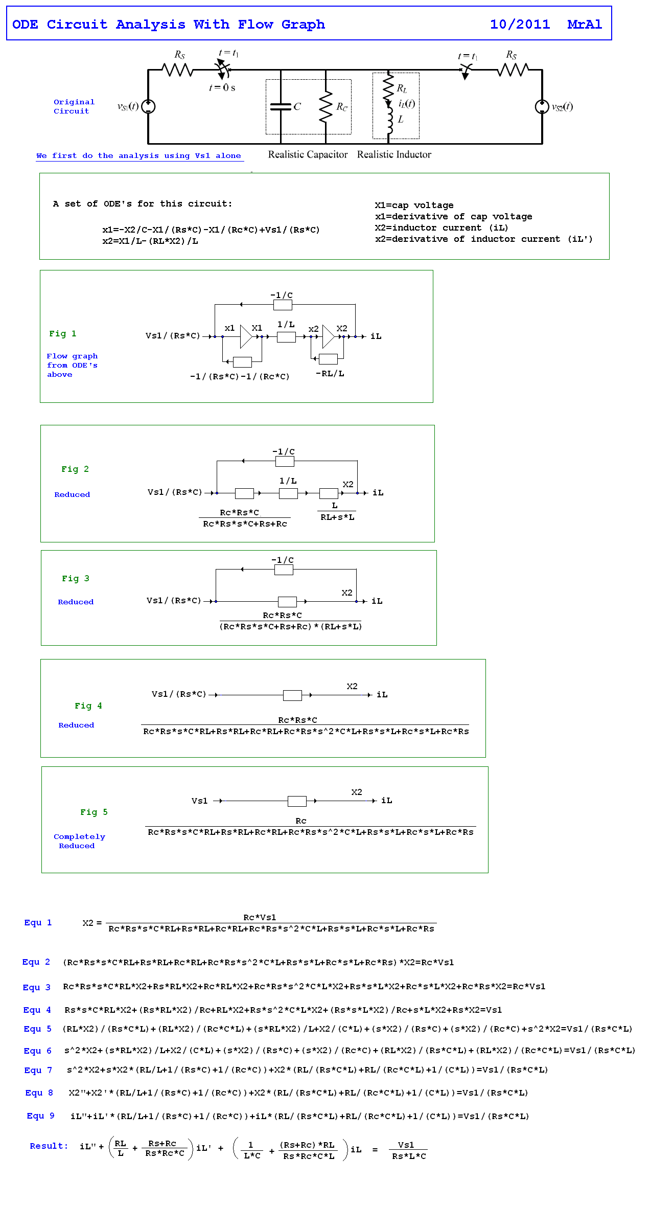

The other method was simply to use Mason's Gain Formula.
This was a little more work than i thought at first but here is the procedure i talked about...
Refer to the attachment for the figures and equations. This is a step by step
procedure following the diagrams in the attachment from top to bottom.
We start with the two ODE's, draw a flow graph, reduce the flow graph,
then factor into the required form. We end up with a single differential
equation in iL and its derivatives.
We start first by forming two ODE's for the circuit. That's shown
right under the circuit diagram in the attachment.
Fig1:
We draw a flow graph using the two ODE's. The rectangles are gain blocks
and the triangles are integrators. The output X2 is the inductor current
iL and we keep it that way throughout the reduction process. There are
a total of three feedback loops in this flow diagram.
Fig2:
We reduce the two loops with the two integrators in them. The result leaves
us with only one remaining feedback loop.
Fig3:
We reduce the three forward path gains to a single gain. We still have one
feedback loop.
Fig4:
We reduce the remaining feedback loop to a single forward gain.
Fig5:
We include the denominator of the input in the foward gain and leave the
original input as the input signal.
Now from Fig 5 we form the equations...
Equ1:
We equate the flow graph to X2, the output.
Equ2:
We solve to get Vs1 on the right in some form.
Equ3:
We expand to get all terms by themselves.
Equ4:
We divide by Rc to get rid of Rc on the right (it's not supposed to be there in
the final equation).
Equ5:
We divide by Rs*L*C because that is supposed to be on the right side in the
final equation.
Equ6:
We group terms according to their powers of the variable 's'.
Equ7:
We factor in terms of powers of 's' and 'X2'.
Equ8:
We interpret powers of 's' as derivatives, s^2 is second derivative, s is first, no
's' in the term means just the variable itself (no derivatives).
Equ9:
We replace all X2 with iL, so X2 becomes iL, X2' becomes iL', X2'' becomes iL''.
Result:
We factor each term to get into the same form as the desired equation and we're done.
Comparing the result with the equation shown in the paper, we see that they are
the same.

This will be the circuit for Vs1? and capacitor initially will act as a short circuit and inductor as an open circuit?
Hi again,
Yes that's right, and you're welcome :)
