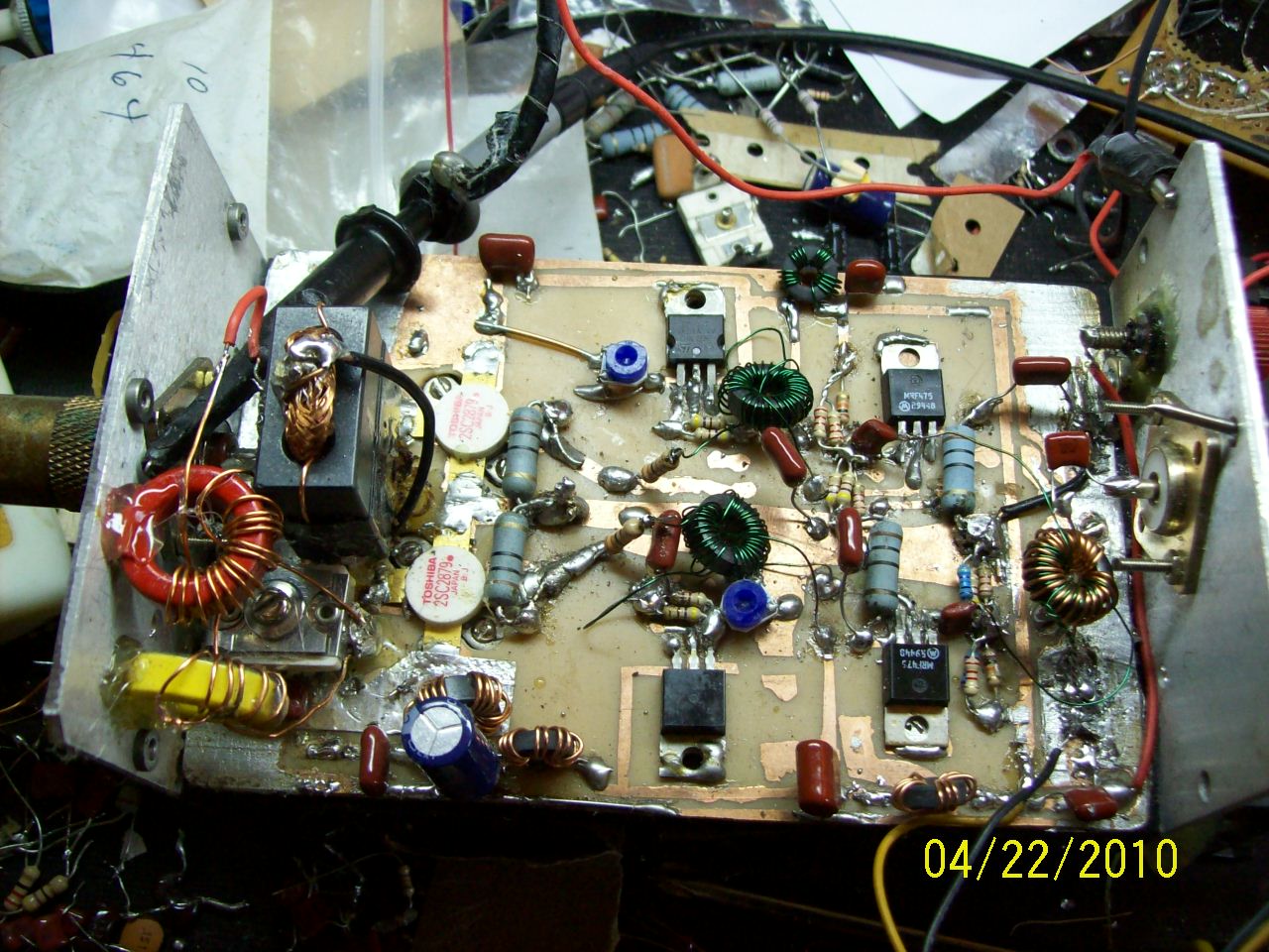

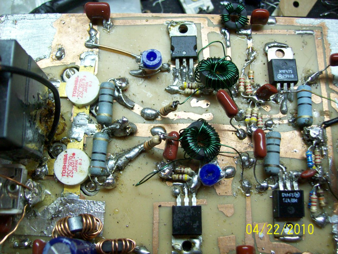

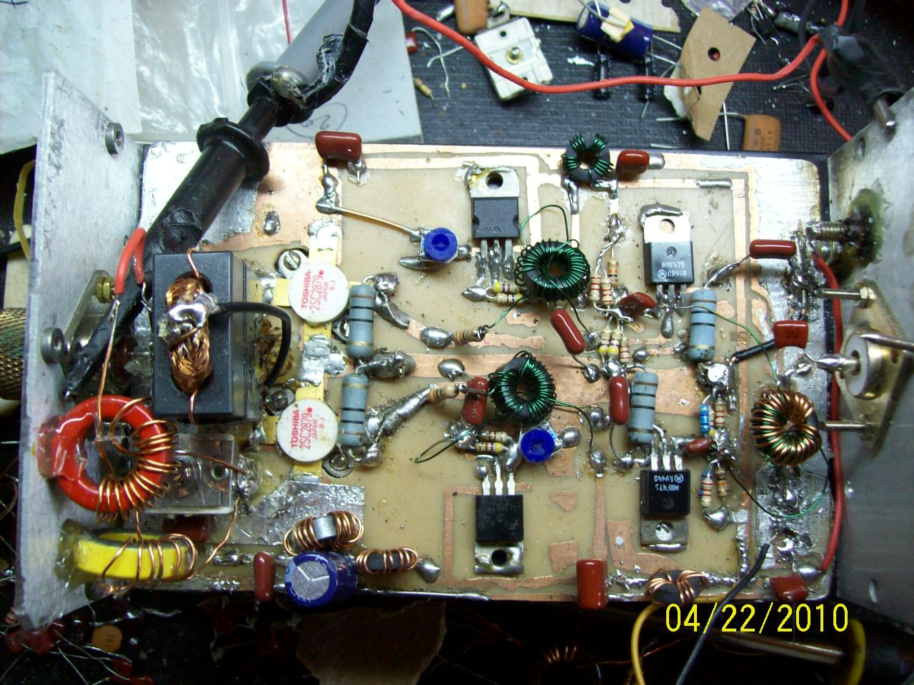

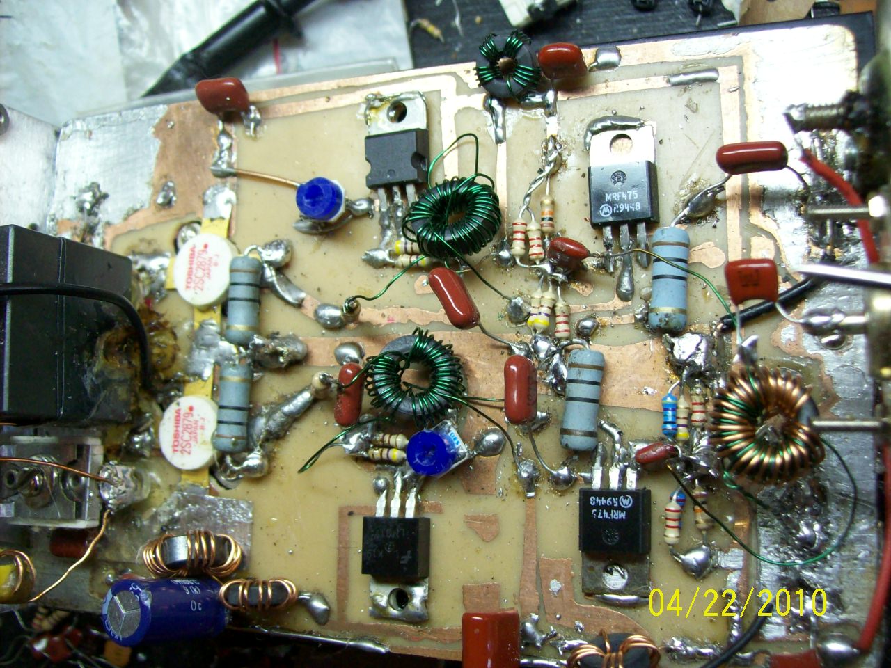

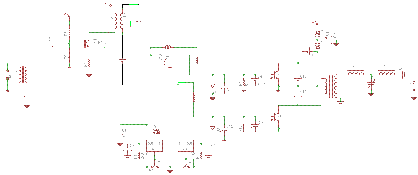

I really appreciate you all's help. I pulled the resistor and got about 8 watts right off. Then I was looking at the output network which you see I'm using a T network and something didn't look right so I changed it and I'm at 15 to 20 watts. One you get here they start popping up exponentially but that resistor was holding me back. You guys were right on. I wonder is those two 33 ohms resistors are killing my base current? It's so hard to adjust with only 10 ohms because one each transistor turns on the load changes on the LM317's. I'm slowly bumping up the driver's biasing too. I'm sorta concerned with heat so might run it shy of full 200. The broadband characteristics are pretty good. Through a frequency span of 2.5MHz under PLL control it jumps 15 to 20 watts right now. Probably the output network.

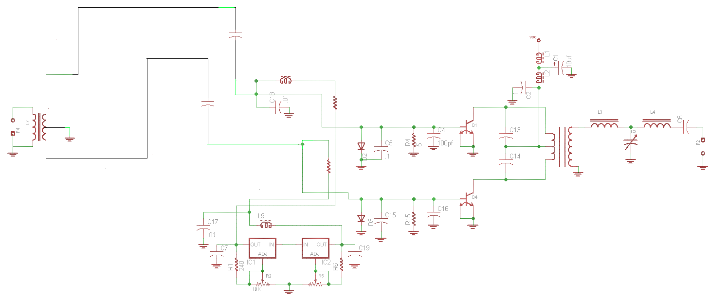

i have edited ur design for more saving components

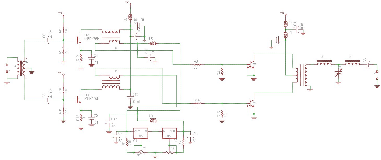

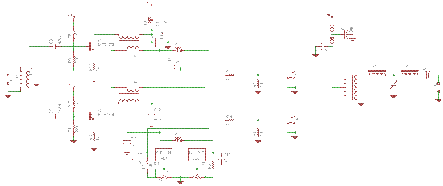

Good call. I already did that 2 days ago and found one in the frequency control box so a rearranged the whole output string ending up with a 1 watt output transistor (MRF473) in it. But I finished it finally. The dummy load I was using was throwing off my power/SWR readings. I put it on antenna and saw 220 watts on one frequency. Supposed to be 200. It almost fried a 300 watt dummy load. It took over an hour to cool down. So it's working. Let me see what this guy did with the schematic. Should be interesting.

It's OK but you left out the other driver. I will do a final update once I button it up. I got to mount the fan and other stuff. I bumped up the bias on the drivers so those resistors changed which forced me to change the emitter resistor power ratings. The 1/4 watts fried fast. That was stupid anyway. Don't know what I was thinking. So I better send new pictures too.

Nice try, but L6 now connects the two bias supplies and short circuits them both to ground.
You have removed the values for R8, R9, and R12 so the bias is unknown. Even if the bias is correct Q2 will probably be much worse with second harmonics (which is why a lot of linear amps are push pull).
You took out the Vcc filter at L7.

u r right becauze this is large signal. Class A using in this case is uncomfortable. using transformer directly is good for quanlity.

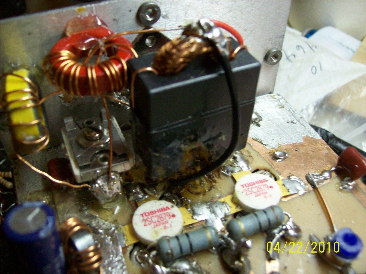

I think he is toying with me. Here, this is the final design. Not much changed, just that resistor and I raised the current on the driver's base and changed some transformers you can see in the pictures. Oh, and a missing filter cap that was all the way in lower left corner. It removed itself in my face. I should have checked the voltage on it.
