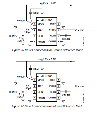

    Looks like your trying to make a RF detector. You should have a look at Analog Devices, they make quite a few RF detector IC's which will perform much better than your proposed circuit. The AD8361 might do what you want and it is very simple to connect. https://www.google.com/url?sa=t&rct...4wTuV35qMlagNGbxMV9RUg&bvm=bv.133700528,d.cGc
    If you go over to the Analog Devices web site, you can do a parametric search on RF detectors, they have a whole slew of parts to choose from.

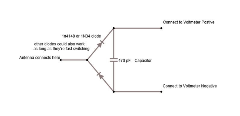

    I'm very interested in detecting biological electromagnetic signals guys.
    I want to determine whether EEG signals can be detected remotely. Most EEG systems use electrodes that have to be on the surface of the skin. So I want to determine whether such signals can be detected from further away.
    I've got a masters degree in computer science and am thinking of doing a PhD in human computer interfaces where someone does not need to be connected with wires.
    I'm certain that this is already possible. The Italian scientist F. Cazzamali achieved the remote reading of EEG data in the 1920's.
    He transmitted radio waves towards someone which interacted with the electrical activity in their brain to produce a modulated waveform that could then be received by a detector further away.
    So what I want to find out is, what normal biological electromagnetic activity occurs that could be detected and whether experiments such as Cazzamali's could be used to receive EEG data without the use of electrodes.
    From experiments that I've been doing using the basic RF detector that I mentioned, I've determined that it can detect electromagnetic energy from myself from reasonably far away, further than a meter. So it seems to be detecting a far field energy.
    The way I determined this was to move closer and further away from the detector, noticing the change in energy levels detected.
    I find this fascinating that energy is being radiated from us that can do that.
    The electromagnetic energy of house current seems to make this detector more sensitive. I'm thinking that it may get the diodes to their working point, that is so that the energy radiated from myself can exceed the voltage drop of the diodes and be detected.
    So I want to connect amplifiers to it so that house current or any other electromagnetic energy is not a factor.
    If you guys know a way of biasing the diodes to also achieve that (voltage divider?) then let me know.
    There's also something called a resonant frequency that I would like to do experiments with. The idea is that different organs have an electrical resonant frequency. The brain for adults is around 450 Mhz.
    A radio wave then at your resonant frequency would create oscillating electrical currents in you, this would be affected by the electrical activity in your mind, EEG signals. Those oscillating currents would in turn create another radio wave modulated with this EEG data.
    So a signal broadcast at your resonant frequency would effectively be re radiated containing EEG data that could be detected from further away.
    So I would like to research these things and to do that I need to build an effective RF detector.

    How did you distinguish that change from the change you would expect as your body blocked or reflected radiation from other sources in the environment, e.g. radio and TV signals?

    In your previous experiments, you were using a diode detector. These are notoriously insensitive compared to a good radio receiver, so if you did indeed measure radiation from the body, then the field levels must have been fairly high. But others don't find such high field strengths as you do, so I wonder whether your detector was, in fact, responding to the ability of the body to affect the field strength of electro-magnetic fields that originate elsewhere. I am interested to know what kind of antenna you used for those initial tests with your detector. Can you provide a photo or description? I think the effect you see is most likely that your body is distorting the EM field around your detector antenna when it is close, simply by virtue of having a very different dielectric constant and conductivity than air.
    It is worth mentioning that many spectrum analyzers have relatively poor noise figure and require external pre-amps for sensitive work.
    It is commonly done to bias diodes with a bit of DC to improve their sensitivity as a detector, so you are perhaps on the right track thinking that house AC may be helping you. On the other hand, by adding an amplifier in front of your diodes you may be creating new trouble unless there is some sort of band limiting filters to help exclude undesired EM from outside sources. Adding an amplifier to a diode detector is the first step in creating a radio receiver, and I wonder whether you want to re-trace the steps of many radio pioneers, as this would be a long road to follow.
