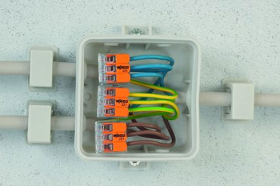

They can usually be self-supporting within a junction box, something like this found via google:

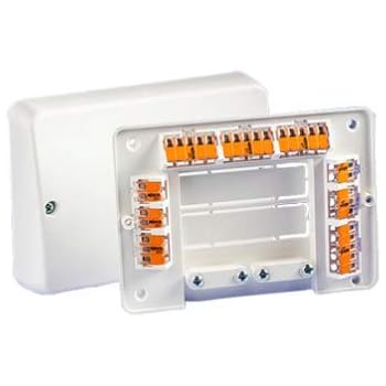

And a larger box with a set of fitted terminals, apparently intended for use as a "wiring centre" for typical Honeywell Y Plan or S Plan etc. central heating setups as commonly used in the UK.
