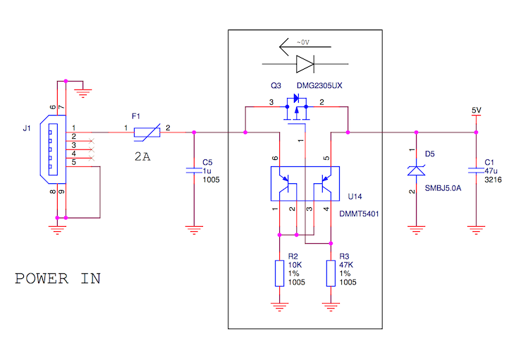

I don't see a problem with putting a Schottky diode in series with the emitter of the Q2 series regulator transistor to protect against voltage feedback.
Don't see how that would interfere with the current limit. :confused:

This is the circuit that they use on the Raspberry Pi for reverse voltage protection:
