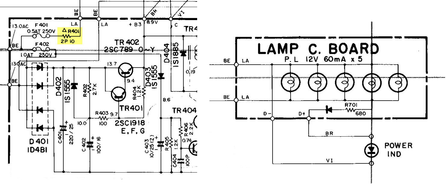

Unable to see what the value was of the resistor was, I referred to the wiring diagrams for the Amp, found out its a 10 ohm resistor but thats all I know, so no idea what wattage?

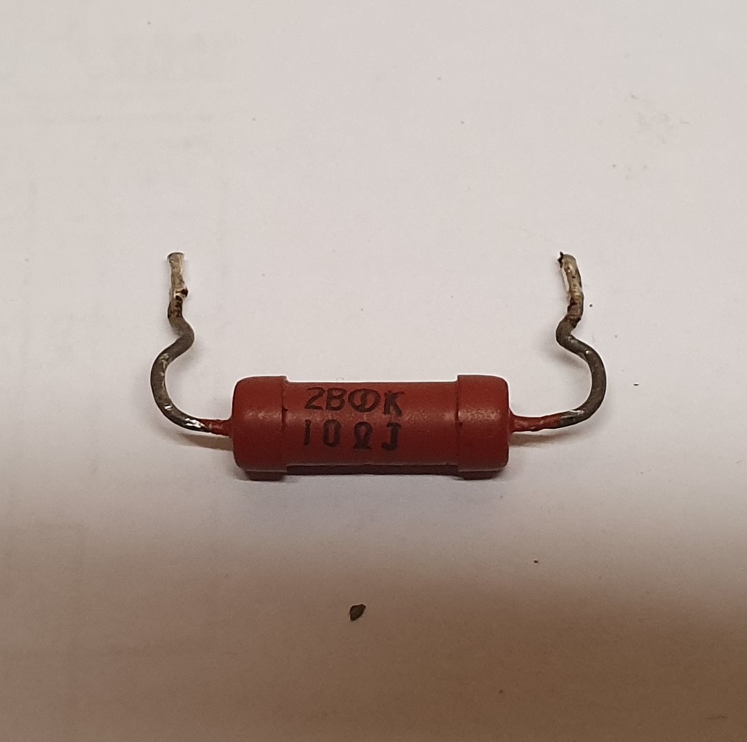

I have attached a screenshot of the diagram and the resistor highlighted in Yellow.
Can anyone identify the resistor? in context to the diagram, take into account that its more than 40yrs old, what would be the modern equivalent?
before anyone ask's, the photo of the resistor is not the one blown, I took it out of another identical Amp.

There are five lamps, each rated at 60mA, so the total load will be 300mA after the initial switch on surge.
300mA through a 10 Ohm resistor will dissipate 0.3 x 0.3 x 10 = 0.9 watts
So a 1 watt resistor would be adequate.
However, for good reliability it is better to run components at no more than half their power rating, so it would be better to use a 2 or 3 watt resistor as a replacement.
Also consider that someone may have installed lamps with a higher current rating, that would cause burning of the existing resistor.
Agree on 2W, but why did it burn and the fuse blow? Check carefully for any shorts in the lamp wiring, and be sure the installed lamps are the correct ones.
I'd say it was around 2 watts as well, however the one you pic'd looks Ok to me, are to you able to meter it and see what it reads?
The schematic shows '2P' for that resistor: another indication it's a 2Watt one.
Thank you all for your comments, especially JimB for a easy to understand comment, 10 ohm 2w wirewound resistor now ordered.
thank you also to the others who confirmed the resistor size and to commented on other things to check.
I checked the bulbs on the lamp assembly, they are not like the other I have for spares which I know are 12v 60mA but unknown value as nothing written on the bulbs, so that could be the problem? after installing the correct bulbs, I checked with meter all the way back to lamp board and all is fine, will double check again after fitting new resistor when it arrives.
The photo was of a good resistor I took out of another fully working CA-2010 just to take the photo. Sorry brain fade, hadn't thought of testing with a meter!
