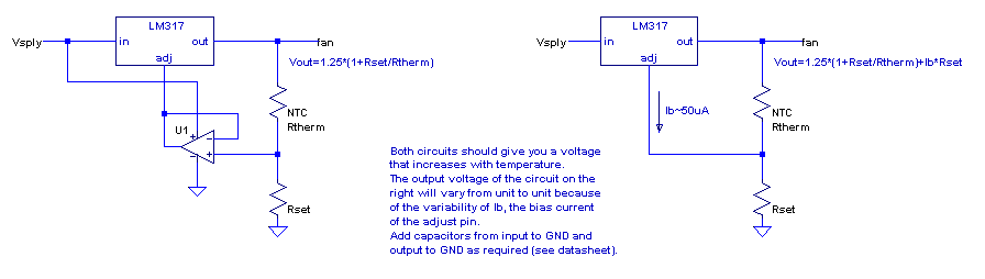

I have a 10K thermistor that is about 10.5K ohms at 75 degrees F and about 7 ohms at 100 degrees F. Is there a way to combine resistors or other components so that the total resistance of the circuit goes higher as the thermistor resistance drops?

In the end what I'm trying to do is drive the adjustment pin of an LM317 with this NTC thermistor to control a fan. The datasheet has an example with one 240 ohm resistor connect across the out and adjust pins and one POT connected from adjust to ground. When the POT is changed to a higher resistance, the voltage out is also higher. What I was looking to do is somehow replace the POT with this NTC thermistor so when the ambient temp goes higher (resistance goes lower) I still get a higher resistance in place of the POT, and also a higher voltage finally compensating for a rise in temp. I've seen several circuits on the web to, control fan speed, though none with an LM317 and a thermistor.

Yes, I was looking for a replacement sub-circuit that would replace that lower fixed resistor and provide a higher resistance as the thermister resistance dropped. I tried many different series-parallel resistor combinations only to discover that no matter what, the drop in resistance from the thermistor would always drop the overall resistance. I did think up one circuit which worked with a pot where pin 1 and the center pin where each connected to ground through equal resistors, and the resistance was measured from the 3rd pin to ground. When the resistance dropped across the parallel resistors, the resistance at pin 3 increased. Now if I could only figure out how to make the same thing happen with a thermistor instead of a pot.

To clarify Ron/Dean's suggestion:
Phasor put the thermistor in the wrong line. The circuits below should work. I simulated them, but I haven't built them.
Solving for Rset in the circuit on the left,
Rset=Rtherm*((Vout/1.25)-1)
For example, if you want Vout=12v when Rtherm=7k,
Rset=60.2k
Solving for Rset in the circuit on the right,
Rset=(Vout-1.25)/((1.25/Rt)*Ib)
If Vout=12v when Rt=7k, and Ib=50uA, then
Rset=47k
However, if Ib=60uA and Rset=47k, then Vout=12.5v.
Probably not a problem.
