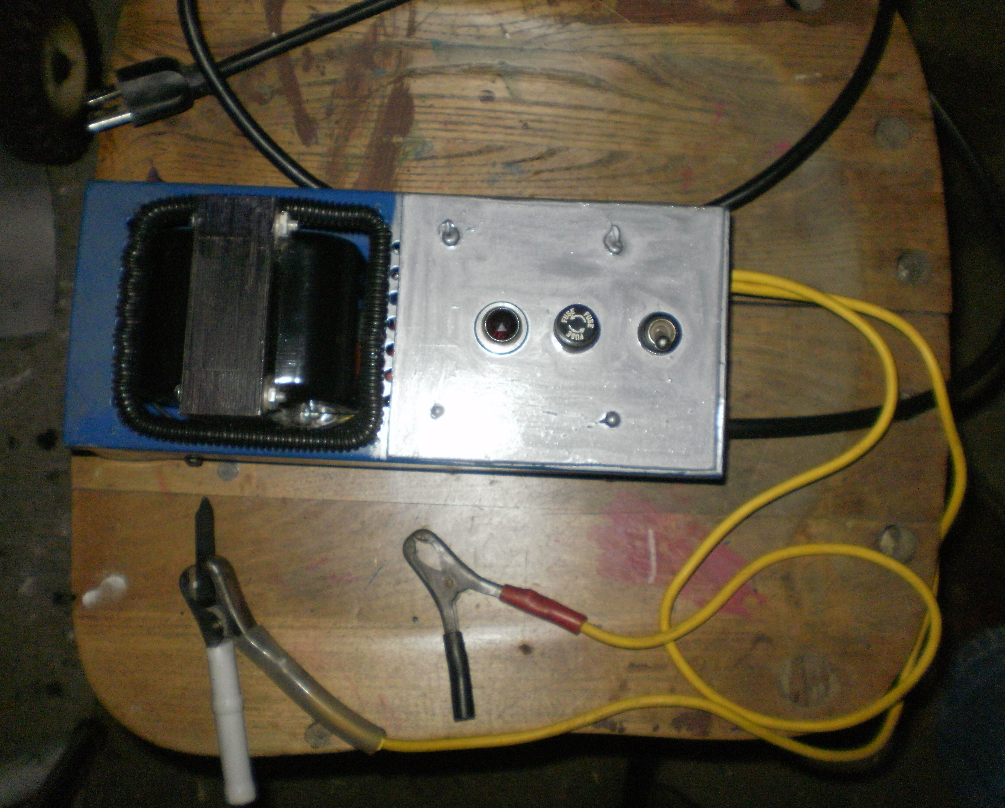

I built a resistance soldering device out of scrap parts.
It works 100 % , but I would like to vary the secondary voltage.
What should I use ?
I have tried a lighting dimmer switch , and that does not work.
Any suggestions ?
My transformer is 120 volt primary and 16 volt secondary.

I would have to draw it out , but for now I will just describe it.
Line - 120 volt in ... through a line switch, an indicating light and a 15 amp fuse.
The secondary leads have each an alligator clip.
One clip is clamped on to the metal that has to be soldered , the other clamp holds a carbon rod.
Get the picture?
I just hold the carbon rod to the other part to be soldered , and the area between gets hot immediately.
I just apply the solder, then break the contact from the carbon rod.
Like I said, it works great.
But I would like to have more control.
Eventually I will use a foot switch.

I may have jumped the gun on the success of my variable resistance.
B T W , I wrote variable resistor, but I meant variable resistance.
It is an Ohmite Rheostat ... 588-RKS-1K RKS1KO.
On further experiments , I realized it is not giving me the control that I would like.
The other part of the problem may be the carbon rod that I am using.
It is the core from a zinc carbon D Cell battery.
I will try all your suggestions , but first I will try to get a carbon arc rod from a welder friend.
Here is a pic of my device.... Sorry if it is not too clear !

I would not mind seeing some pics of the complete setup, the resistor, and even a joint before and after soldering, especially 'after'. I dont like resistance soldering but if i see a nice joint i might be convinced otherwise.

That looks prensentable.
