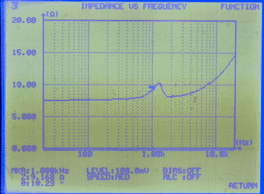

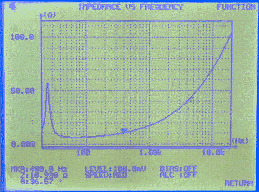

It's not that tiny; it's a 4" midrange from a junked out Japanese 3-way system.
It's an exaggeration to suggest that "most speakers" have a resonance at 33 Hz; "most woofers" maybe, but not "most speakers".
I've attached the impedance vs. frequency characteristic of the 12" woofer and the 1.5" tweeter from that same system.
The general shape of the impedance curve is the same for all three drivers.
The impedance is not much more than the DC resistance for several octaves above resonance (the woofer has 5.9Ω DC resistance) for all of them.
