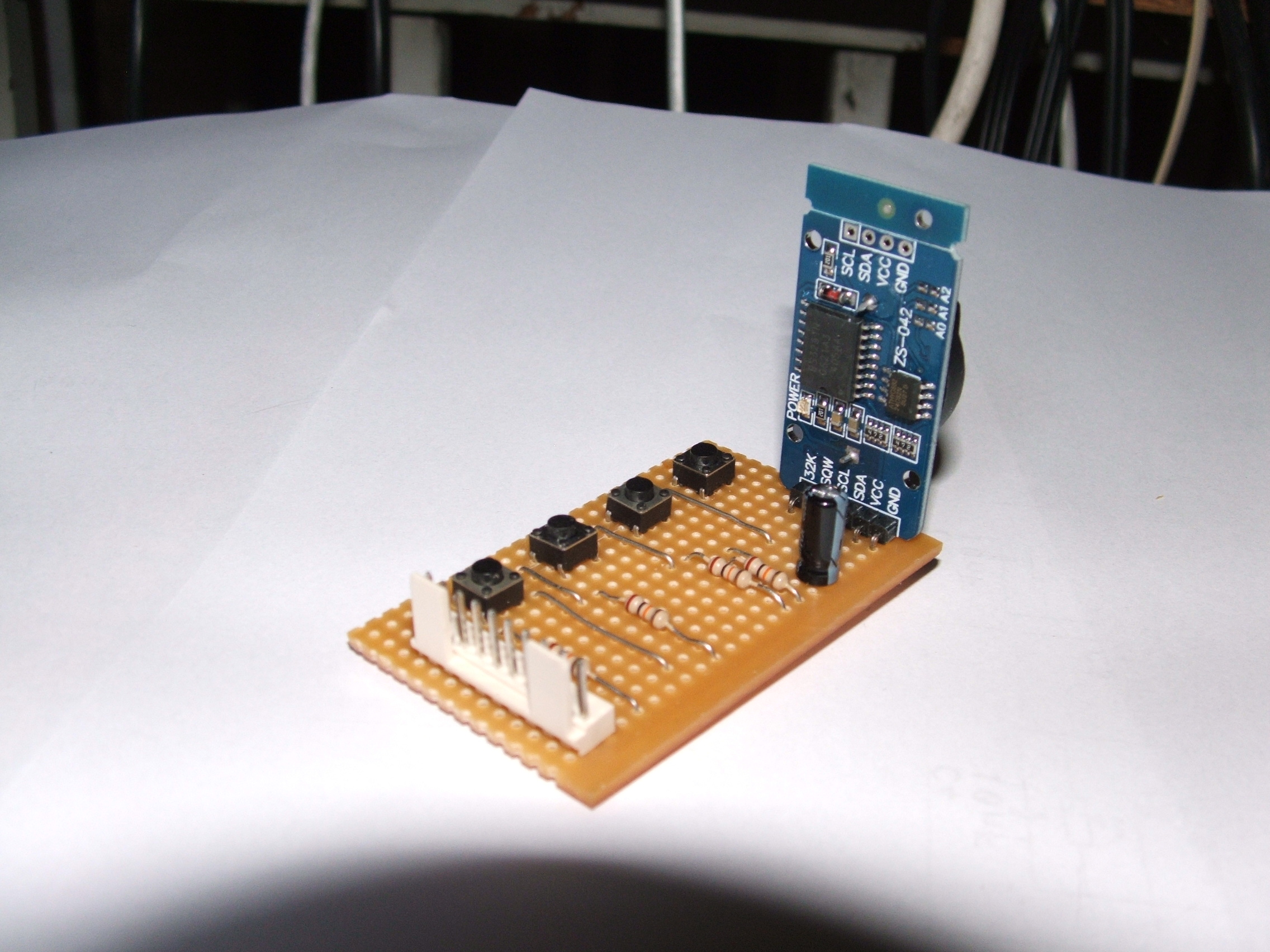

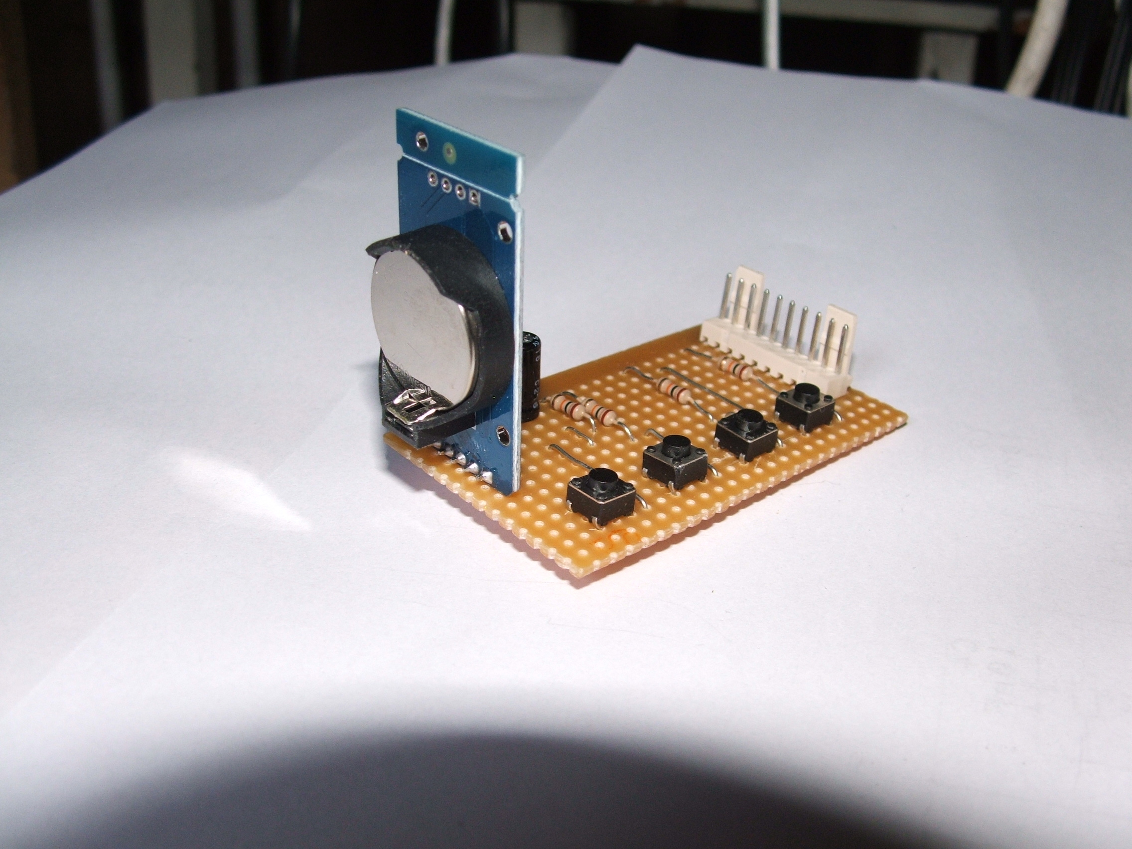

Just to keep things updated, I've EVENTUALLY started playing with one of my RTC's (after the first delivery of them got 'pulverised' on the way from China - even the batteries were damaged and bent).
I've just put it on a board with four push-button switches, so it plugs in as part of my usual tutorial boards.
The software I'm using is written in XC8, and I found it on the net, for an 18F4520 - and I simply changed the code for my new PIC of choice the 16F1827, and changed the LCD pinouts to match my tutorial boards, and used the hardware I2C MSSP interface of the PIC.
It all went quite nicely, and it's sat running a nice clock at the moment :D

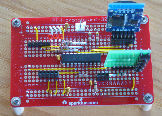

Glad the second shipment arrived safely. I have been busy learning some interfaces and have now put everything onto one board. The open socket on the lower left is for a WWVB (USA) receiver. My program to capture the "zero" second transition is working -- just TMR0 counting transitions. And my sync (I2C) with the RTC is also working. My project now is to integrate them into a 16F1829 so I can see in ms how much drift the RTC has per day. Spring is seemingly early here, so that will afford me the opportunity easily to see what effect ambient temperatures have on that drift.

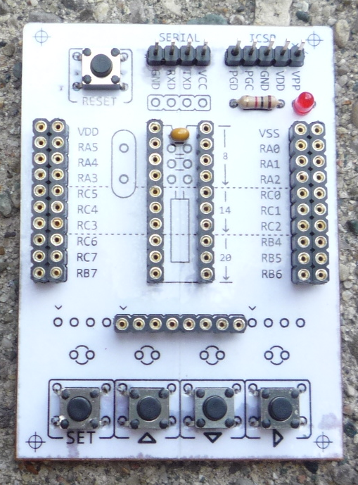

Just FYI, here's my board:
Upper left is ICSP, lower right are some switches for "doing things," upper right is the RTC. The three LED's help me troubleshoot programs, since MPLAB doesn't simulate some functions, such as capture on all chips. Top center is the power plug. When programming, I use the USB 5V source. On my bench, I use a couple of LiFe batteries in series with a little regulator and an MCC charger.
John

It is my first time with a solderable breadboard. The SparkFun version ($4.95) looks nice and has plated through holes -- some versions from other vendors don't. The only thing I don't like is that the power rail holes do not line up with the 5-hole signal traces. That completely disrupts my sense of symmetry and accounts for all of the dog legs. Actually, working on a solderable board was not that bad. I switched to 24 AWG Kynar ( wire wrap) wire from 22 gauge. That gauge was easy to work with, and the Knyar was more stable to soldering heat than PVC insulation. The picture I posted already had one rip-up and re-routing to get my switches in different pins.

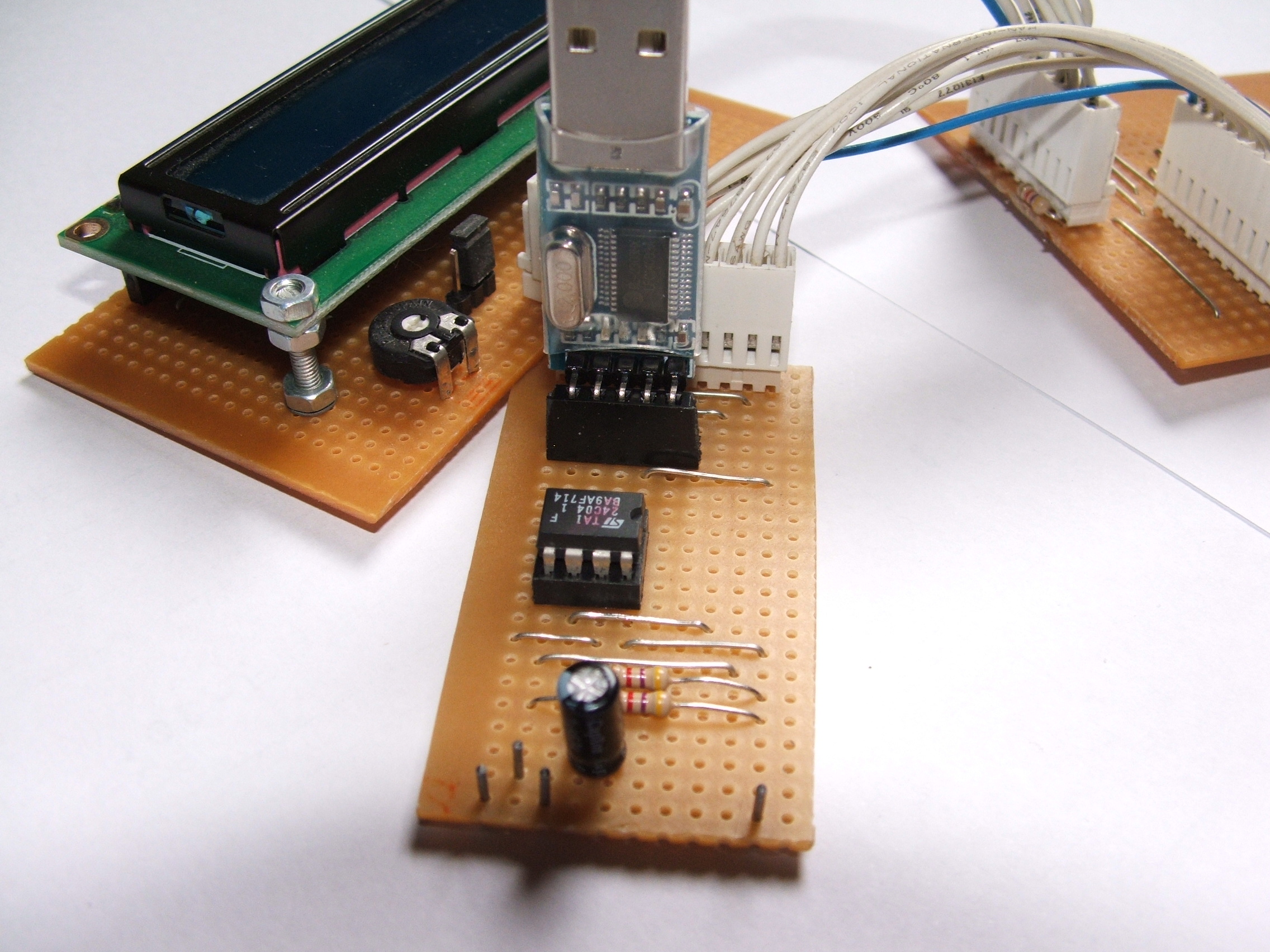

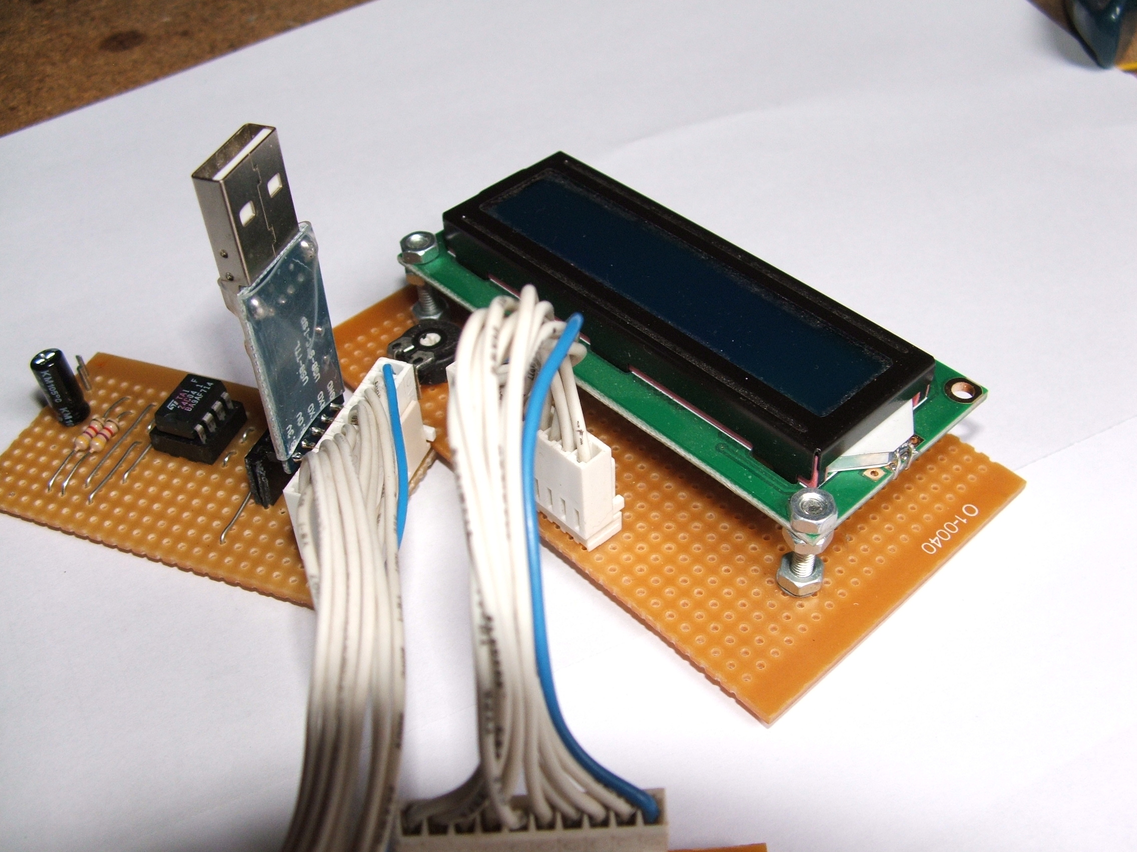

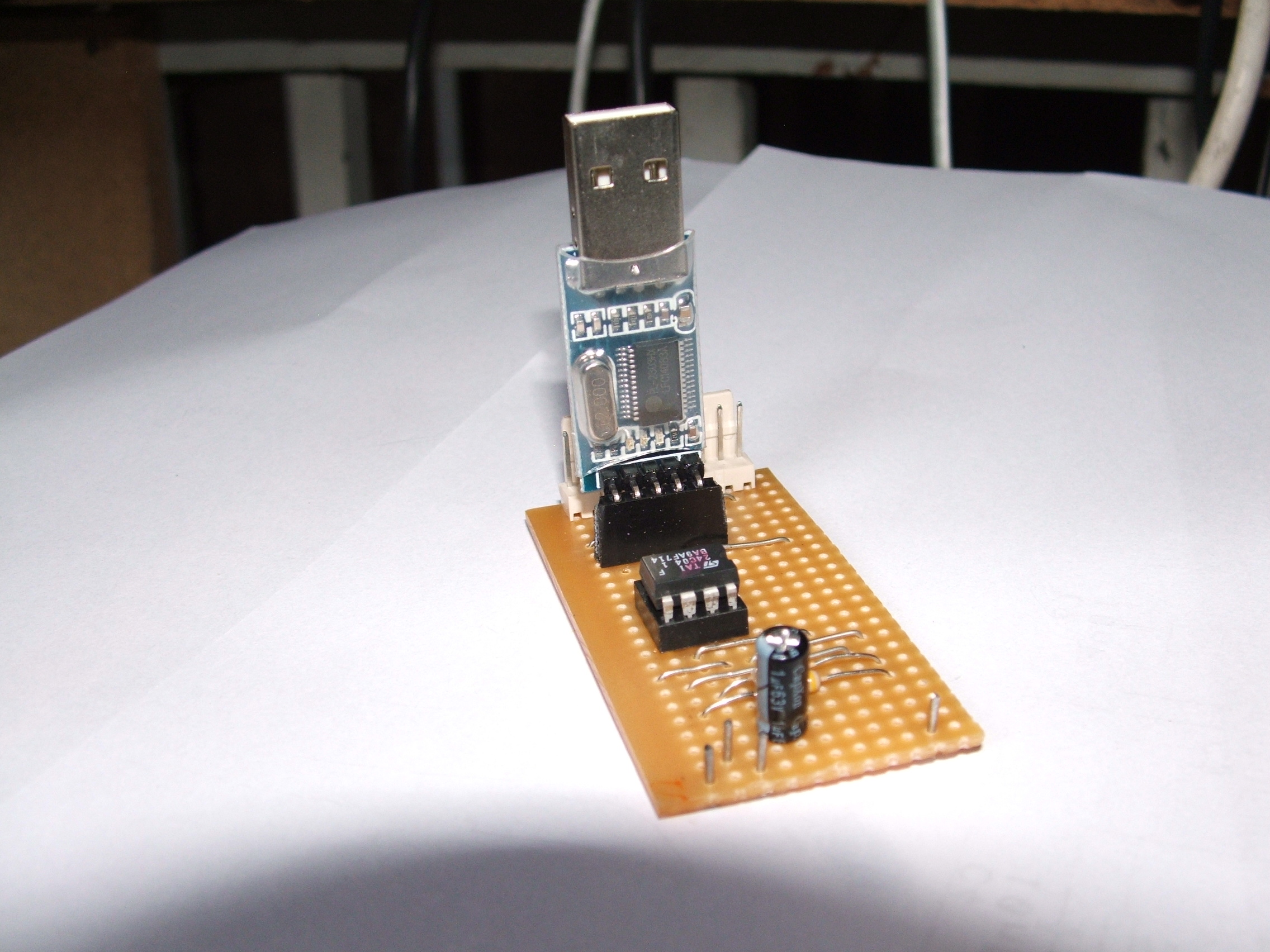

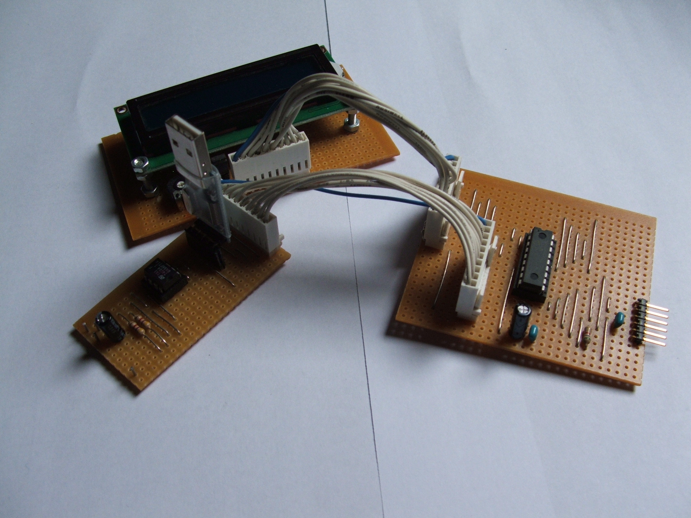

OK, I promised pictures, so here's some of the tutorial boards I've recently constructed - the EEPROM_USB one just this morning in fact.
So there's a new LCD board, which connects to PortA (usually) of the tutorial boards. An EEPROM board with a TTL/USB serial converter on it - for obvious data logging purposes. And finally, an RTC board with four buttons on it as well.
The main board I'm using is a 16F1827 board (my new PIC of choice), and I'm using XC8 for the software.
I wonder if that's a good choice, Nigel? It seems Microchip isn't doing much with the 18-pin devices. All of the new and exciting 1500, 1600, 1700, and 18000 series devices are coming in 8, 14, 20, 28, and 40 pin packages. Also worth mentioning, the 8, 14, and 20-pin devices share a somewhat common I/O pin organization (see below).
Oh, BTW, your tutorial boards look very nice...

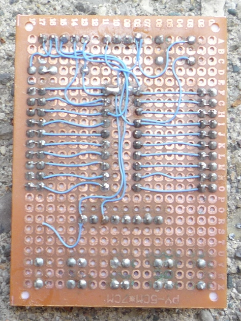

View attachment 97825 View attachment 97826
That's very nice, although I was a bit shocked to see the bottom - as I presumed it was a silk-screened PCB from the top picture :D
