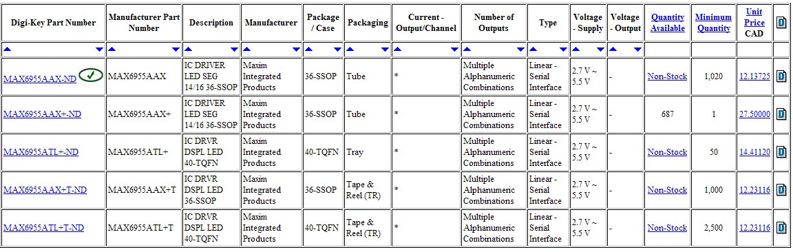

For the Max7221, I was looking at these to see if I could create a 16x48 led scrolling matrix as my next project. Also thinkig of the Max6969 or Allegro 6279's
Ok cool Now what exactly do you mean by "jittery action when I re-write the PIC with the updated code" ?
EDIT: The MAX6969 looks promising for the scrolling matrix. The only thing is its has 16 Constant-Current LED Outputs meaning you are going to need quiet a few to get a large display like that. the A6279 is really similar to the MAX6969.
Im not sure but i might consider getting " MAX6955 " for the matrix project.
Specs:
# 400kbps 2-Wire I²C-Compatible Interface
# 2.7V to 5.5V Operation
# Drives Up to 16 Digits 7-Segment, 8 Digits 14-Segment, 8 Digits 16-Segment, 128 Discrete LEDs, or a Combination of Digit Types
# Drives Common-Cathode Monocolor and Bicolor LED Displays
# Built-In ASCII 104-Character Font for 14-Segment and 16-Segment Digits and Hexadecimal Font for 7-Segment Digits
That looks like a keeper!

Here's the only problem(s) I see with the 6955:
I didn't check prices anywhere else, but $27.50 each (in hobbyist quantity)?!?! Ouch!
EDIT: $22.86 at Newark.
And no DIPs available. SSOP and TQFN only. That's not such a big problem though. Doesn't really bother me at all. The high price might be.
FUTZ: wow i didnt notice that. But remember its MAXIM meaning free samples. Im sure they will gladly send out 2-4 . I order samples from maxim like crazy mainly because if i build something that uses it and make money from it ill be sure to buy in mass quantity.
