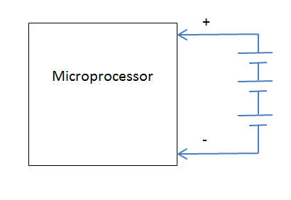

Hello Dr_Doggy,
This is what I would recommend for your micro power supply:
The three batteries are AA NMH
Here are some links for them. The Eneeloop types are recommended (you would have one spare battery):
cheap AA
https://www.amazon.co.uk/BTY-Rechar...3194&sr=1-37&keywords=battery+aa+rechargeable
eneloop AA
https://www.amazon.co.uk/Sanyo-1900...d=1447623627&sr=8-33&keywords=battery+eneloop
eneloop AA
https://www.amazon.co.uk/Panasonic-...=1447623879&sr=8-118&keywords=battery+eneloop

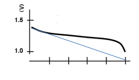

The graph shows the discharge voltage characteristics of NMH batteries which seem to be designed for your application. They probably have a more stable voltage with discharge than the batteries you have been using.

You might be interested to see the graph below which shows why the capacitor is a bad choice for this application. JimB pointed this out. Once again I have made the assumption that the micro takes a constant current. This is way off at the lower voltages but it illustrates the principle and to analyse it would serve no purpose. The black line shows what the battery would do and the blue line shows what the capacitor would do. Once again I cheated and changed the scale for the capacitor to illustrate the point. If I didn't the capacitor characteristic would be invisible because on that scale the capacitor would be discharged probably within the thickness of the y axis line.
