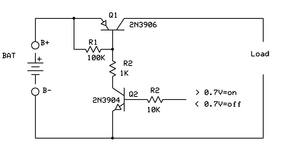

Possibly an NPN and a PNP transistor and two resistors, to switch on above 0.6v input. What's the voltage to the"other circuit"?

Not knowing what the voltages or currents for the "other circuit", this it a version of a power switch that is turned on and off by a low voltage. The values for the resistors and transistors depend on your outher circuit's requirements. More specific details would help.
Ken

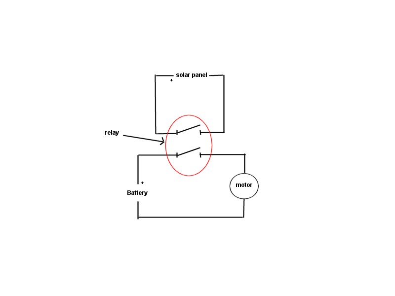

I tried to make one simple drawing of what i want to do.
i dont want to power my other circuit. Just switch it on. I see it just like when im using a relay to power up the fog lights on a car.
the drawings are almost like another language for me. i hope you can see that this is hard for me to understand. thanks.

Your circuit has to have power to turn on. ;)

Ok the other circuit have some other things to it and cannot be touched. so have the first circuit but i cannot explain it in details. i just want to have the first circuit to power on the other one without modifeing any of the circuits. cant there just be a simple switch or relay or something. i dont want to mix up the two circuits. i just need a "bridge" between them. a little switch that turns on the other one when it gets some low voltage and no amps. its that simple. i cant see why i need to do all kind of things. its just a signal to turn the other circuit on with a switch.

You're making this more complicated than it needs to be. That's precisely what a transistor will do.
In the circuit above, the photoresistor pulls the base of the transistor down to ground when there is light present. This turns the transistor off and interrupts the circuit's connection to ground, thereby switching the circuit off.
When it goes dark, the photoresistor's resistance goes high and the base is then pulled up to the supply voltage via the base resistor. This allows base current to flow, which then turns the transistor on. The transistor supplies a ground to the circuit it's switching when turned on.
Once it goes light again, the base is pulled down to ground, which turns the transistor off and interrupts the ground to the circuit, switching the circuit off.
The only thing common to the controlling circuit and the controlled circuit is the emitter of the transistor, which is tied to a common reference. This will not affect circuit operation.
