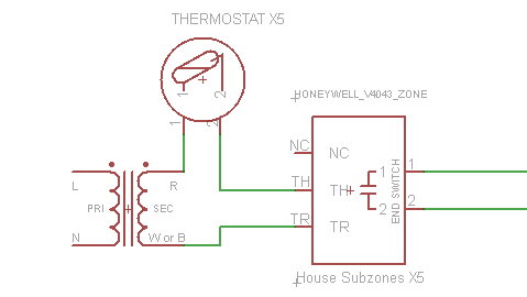

Domestic hot water (DHW) has priority over house zones. The house zones are all wired in parallel (OR'd). If only one zone calls for heat, the furnace turns on. It is the latter fact that can lead to frequent cycling of the furnace. Original thermostats were Honeywell 87A's and had mercury switches, and by carefully setting them differently, I could reduce cycling a little. Some have gotten a bit funky and unreliable. Of course, direct replacements are no longer available. Honeywell's digital replacements do not allow adjustment of the spread (i.e., hysteresis between call for heat and satisfied). They do have an adjustment for number of cycles per hour. The values vary from 1 to 9 (i.e., 1,3,5,9). I am not 100% certain what the number represents. It appears from blogs that the duty cycle is set at 50% and that, for example, a value of "3" means the furnace is on for 10 minutes, then off for at least 10 minutes, until the demand for heat is justified. It is not clear whether the furnace will stay on for more than 10 minutes to satisfy the demand for heat. However, if the demand is met before the 10 minutes elapses, the furnace will turn off. (I am currently testing one I installed yesterday.) The alternative is a thermostat that has an adjustable spread. I have tentatively decided on using a Honeywell version, modelRTH6350D.

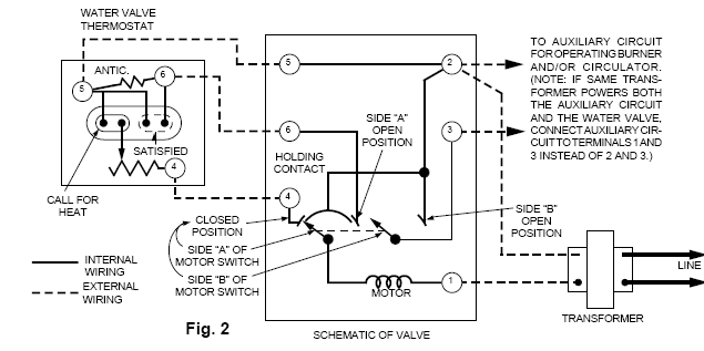

Here is the wiring for the house zones:
When the "End Switch" is closed, the furnace comes on. Since there is no interconnection between the thermostats, it is possible that one will cycle until satisfied, then another and so forth, which will lead to frequent cycling of the furnace regardless of the cycles/hour setting for each thermostat.
QUESTION:

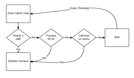

The purpose of this post is to get opinions on prioritization schema for the in living space . I am considering inserting an MCU between the household zone end switches and the furnace relay that will prevent rapid cycling by sequential calls for heat from each zone. Here is a tentative scheme:
Any comments or suggestions?

My plan, for which I asked comments, was to develop a simple logic that would avoid rapid cycling. A secondary or future purpose is to redesign the whole priority system with an MCU. The system I have now uses White-Rodgers Type 1311 zone valves to set the house vs. DHW priority:
There has to be a simpler way to do that today. So, if the MCU house-zone priority system works, I will likely rip out those old valves and go to simple on/off valves with a switch as shown above.

Thank you fellas for the suggestions. Perhaps my question was not clear. My question for this thread has almost nothing to do with thermal mass of the entire house nor sizing of the furnace. The furnace is properly sized for the house, which has 3 baths with showers, and Winter weather in Northern Ohio. For example, a single shower using 3 gpm with a heat rise of 65° (i.e., 5o° to 115°) requires 97,461 BTU/h (Source: Weil-McLain: BTU/h = gallon/h * heat rise (°F) * 8.33 (factor for water density)). Heating needs for the house will depend on outside air temperature (OAT), wind, humidity, heat-loss factors, etc. A local contractor has agreed that the furnace is not too large. It may even be a little on the small size, if the house were fully occupied, which it isn't.
1) The furnace is not adjustable.
2) The new thermostats (X3) do not have adjustable hysteresis. They only have adjustable cycle time (Post#1) per Honeywell's current philosophy.
3) I cannot find anywhere in Weil-McLain literature a recommended minimum "on" time and "off" time, i.e., minimum cycle time, nor can I find that information on the Internet. All of the comments I read just punted on the specifics. In my opinion, and on/off cycle of 3 min on, 3 min off is too short for a hot-water system like mine. A cycle of 10 min on, 10 min off is OK. During cold weather (OAT <35° or no sun and temp <45°), I would like to see a longer on time. Aside from wasting fuel gas, a short cycle time does not allow the flue to heat sufficiently to minimize condensation.
Let me rephrase my question. If I had just a single thermostat in the house system, using cycle time for the house and a prioritization system for the domestic hot water (i.e., the W-R Type 1311 zone valves, Post#8) is pretty straight forward. But, I have 5 thermostats for the house. Each of those thermostats controls an on/off zone valve that is not a Type 1311 valve, but is simply an on/off valve with a set of contacts that control the circulators and furnace. If each simple valve were set as described by KISS, there would the possibility that each thermostat would follow its own 20-min cycle time with on-times shorter than 10 minutes. Sequentially, however, there could be short off times as each thermostat (no hysteresis) called for heat.
My proposed algorithm is intended to reduce that possibility by introducing prioritization and AND'ing lower priority zones. My question was a request for comment on such a scheme. I guess one could compare the AND'ing to increasing the thermal mass for those areas.

I think your idea is sound, but being me I'll overthink and simplify.
You have the safety asspects are a priority. Some circulator movement should occur. Not sure if your dealing with an AC. Prioritizing hot watermakes sense. Keepin condensation from forming in the flue is a good concern. Then there's cost.
The VP series has a wireless hanndheld gizmo which can be used as "where you want to be comfortable".
I think it would be cool to know which zone is the furthest from compliance and base priority that way or even fixed by time of day. Integrating occupancy sensors or even say a particular light being on could alter priority.
e.g workshop could be eliminated entirely unless occupied, but then there is freezing issues.
It really looks like the lack of hysteresis would have to be satisfied by minimum run time. I'd probably consider a minimum time per zone, possibly fixed in yor program, but variabe per zone. Time takes the plce of hysteresis.
