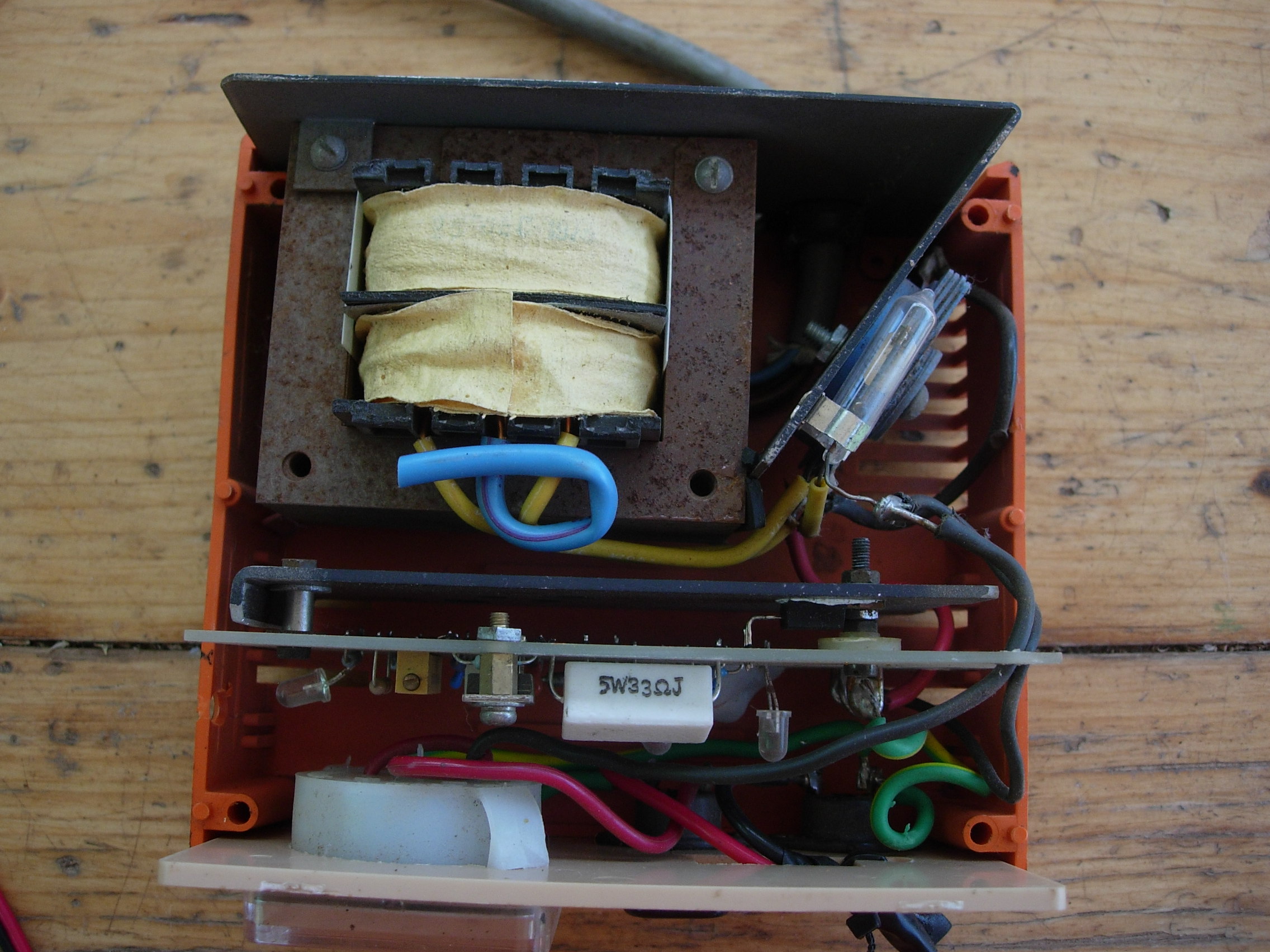

I attach a picture of a charger I intend to replace a transformer in . I see three wires out of the secondary and assume perhaps a center tap middle wire with an output wire each side fed to a rectifyer . I don't understand how this works and wonder if anyone can explain its operation for me please.
The rectifyer has 4 plates
It has a switchable high/ low out put and on the front panel has a plug for 12 Volt and a plug for 6 Volts

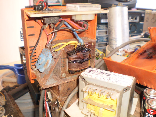

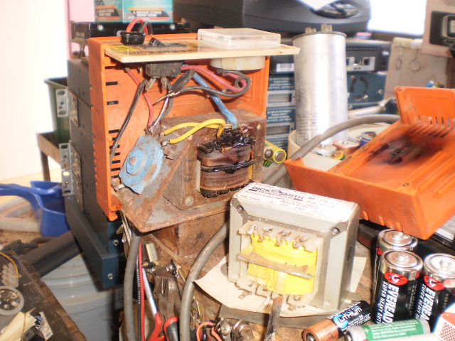

Transformer has obviously gotten quite toasty :woot:...

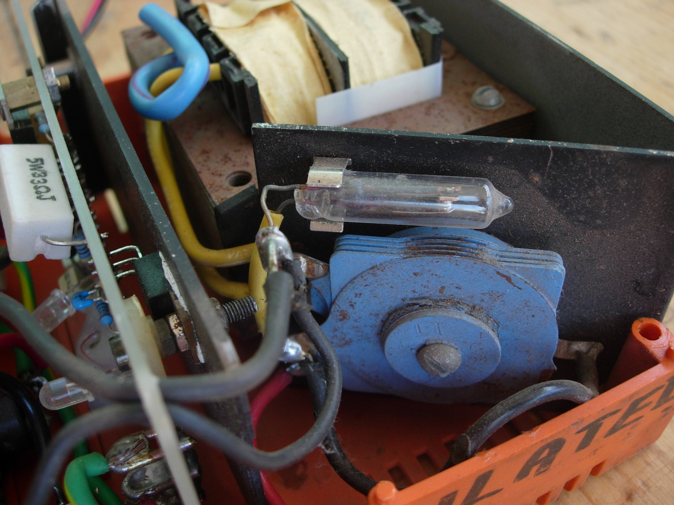

It had a bi-metalic overcurrent cut out and it physically fell apart so I replaced it with a polyswitch but I didn't get that right so it overheated the transformer which I wish to replace now .
So how would I wire up the new transformer to the present rectifyer? do you think I would be best to switch to a diode bridge type .? I'd like to keep it fairly original if I can . I prefer to use the old equipment if it will still work

What is the range of the ammeter? That will give you an idea of the current specs needed to replace the transformer (which appears to have a center tap on the secondary).
The "bi-metalic overcurrent cut out" (or its equivalent) should be replaced as well.

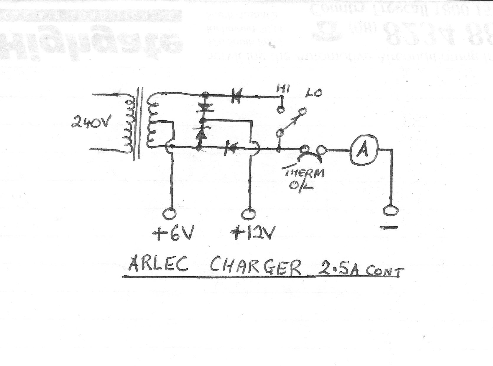

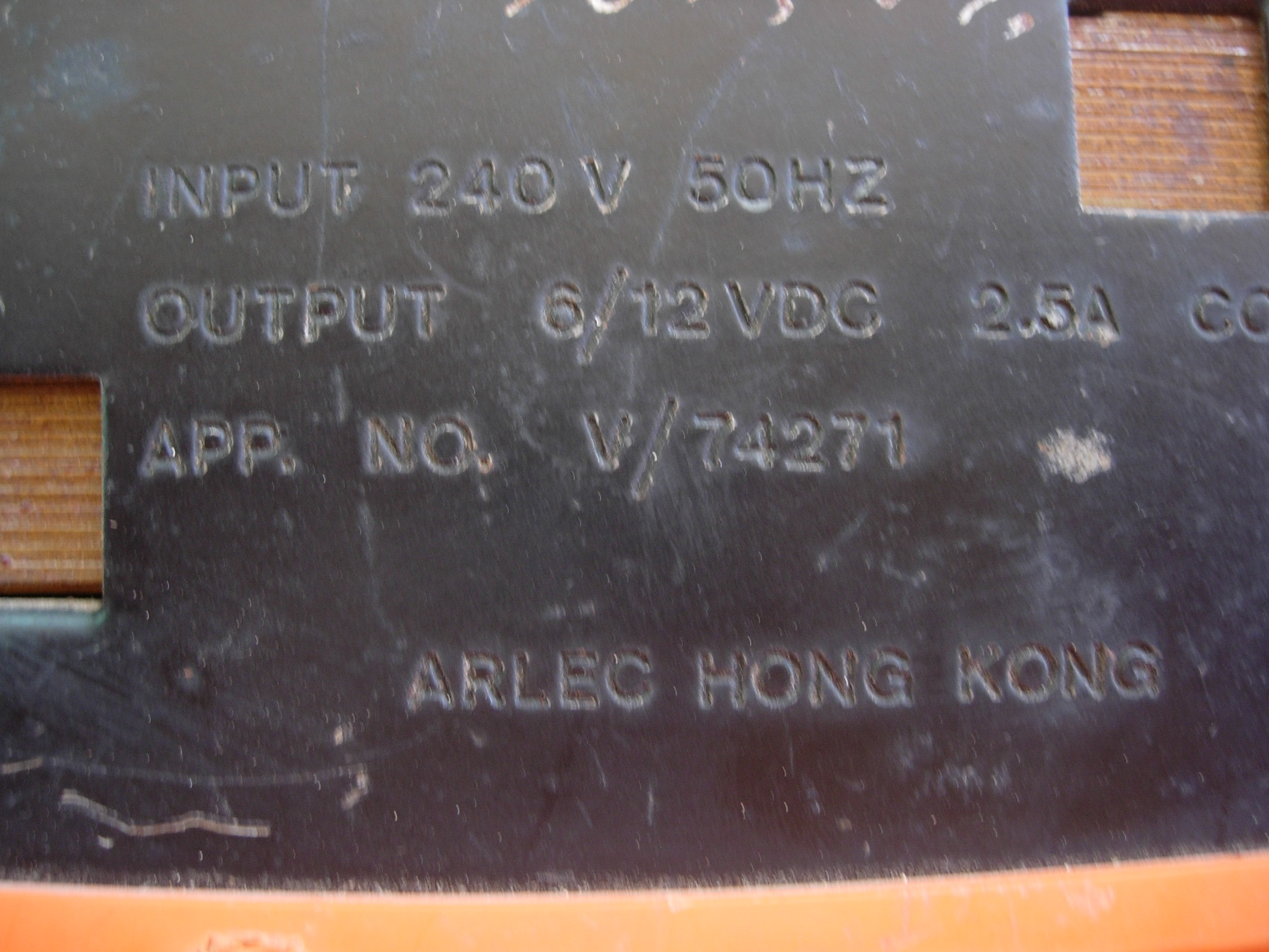

This is probably the same charger which ive had since around 1976. It gets used a lot & the extra circuit board is an SCR voltage regulator which I built years ago & added to it, & it now is only used for 12V battery charging & is used fairly regularly. It is rated at 2.5Amps continuously. The circuit diag is the original circuit. I wouldn't be keen to use it with out the thermal over load, as if a battery is fairly flat it is capable of about 4 Amps & get fairly warm.

It's probably more likely to be a copper oxide rectifier, they seem more common in battery chargers than selenium.
Thats the one thanks for the circuit and pics debe ,Very helpful I'd like to save it
