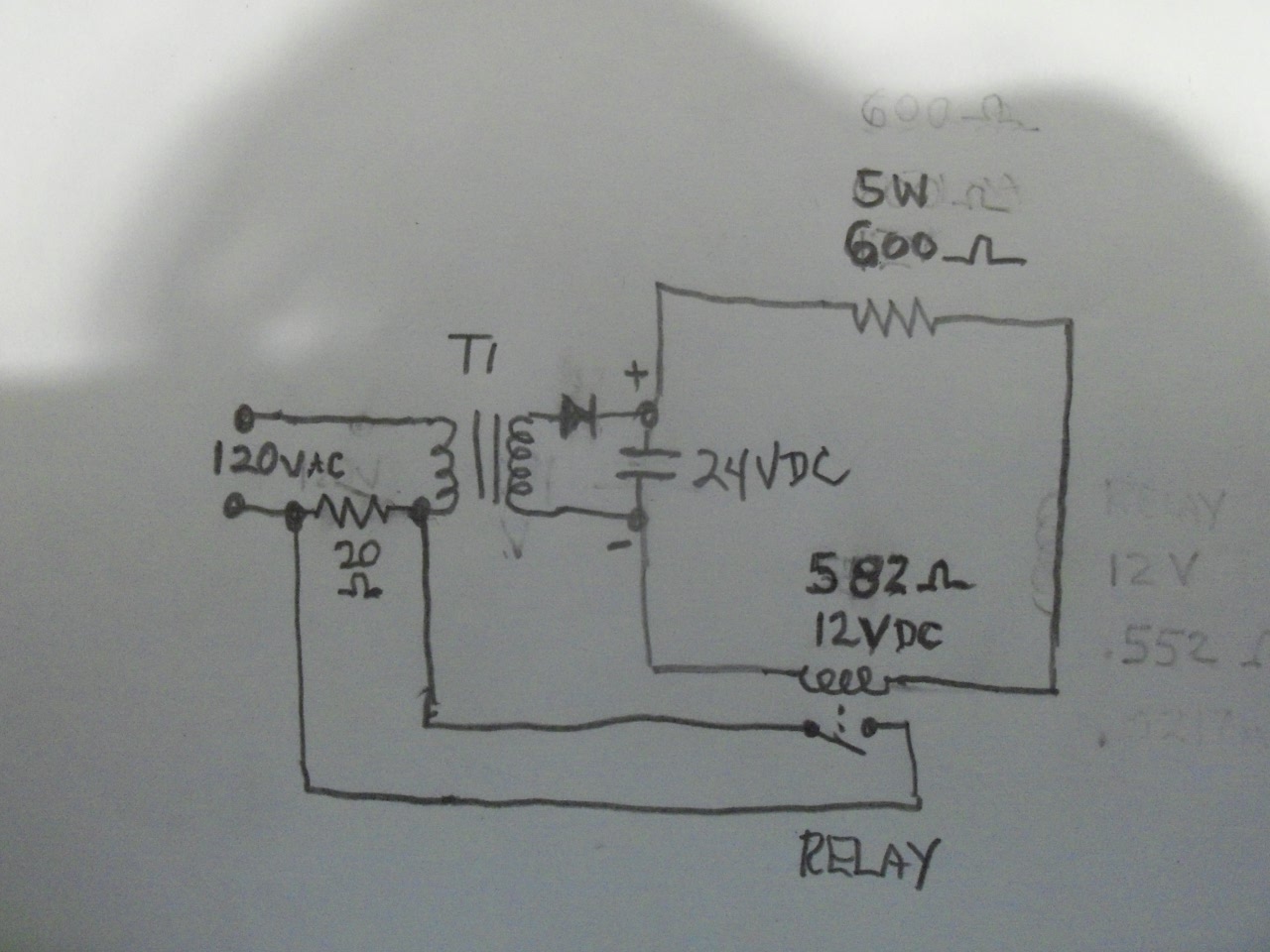

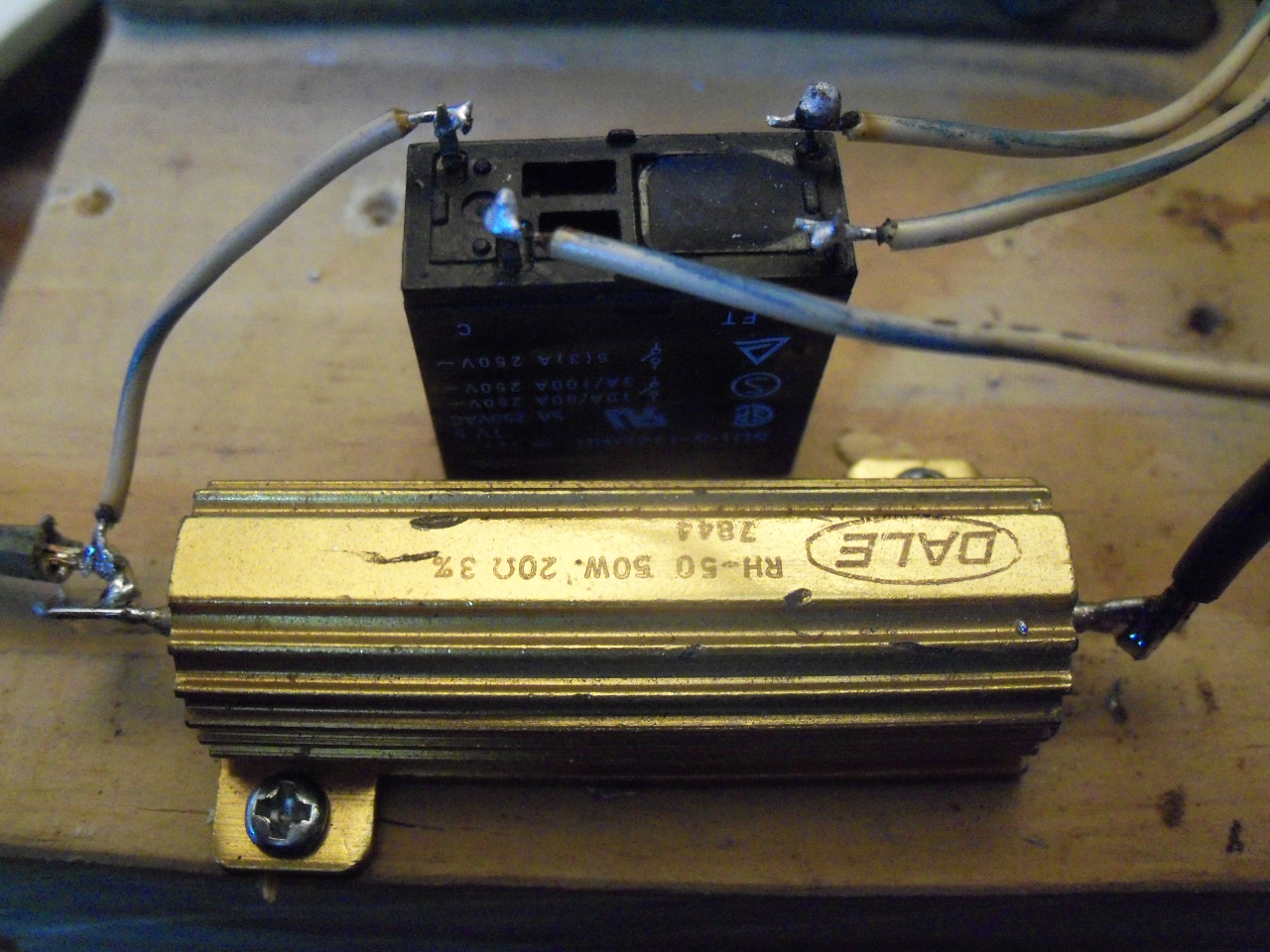

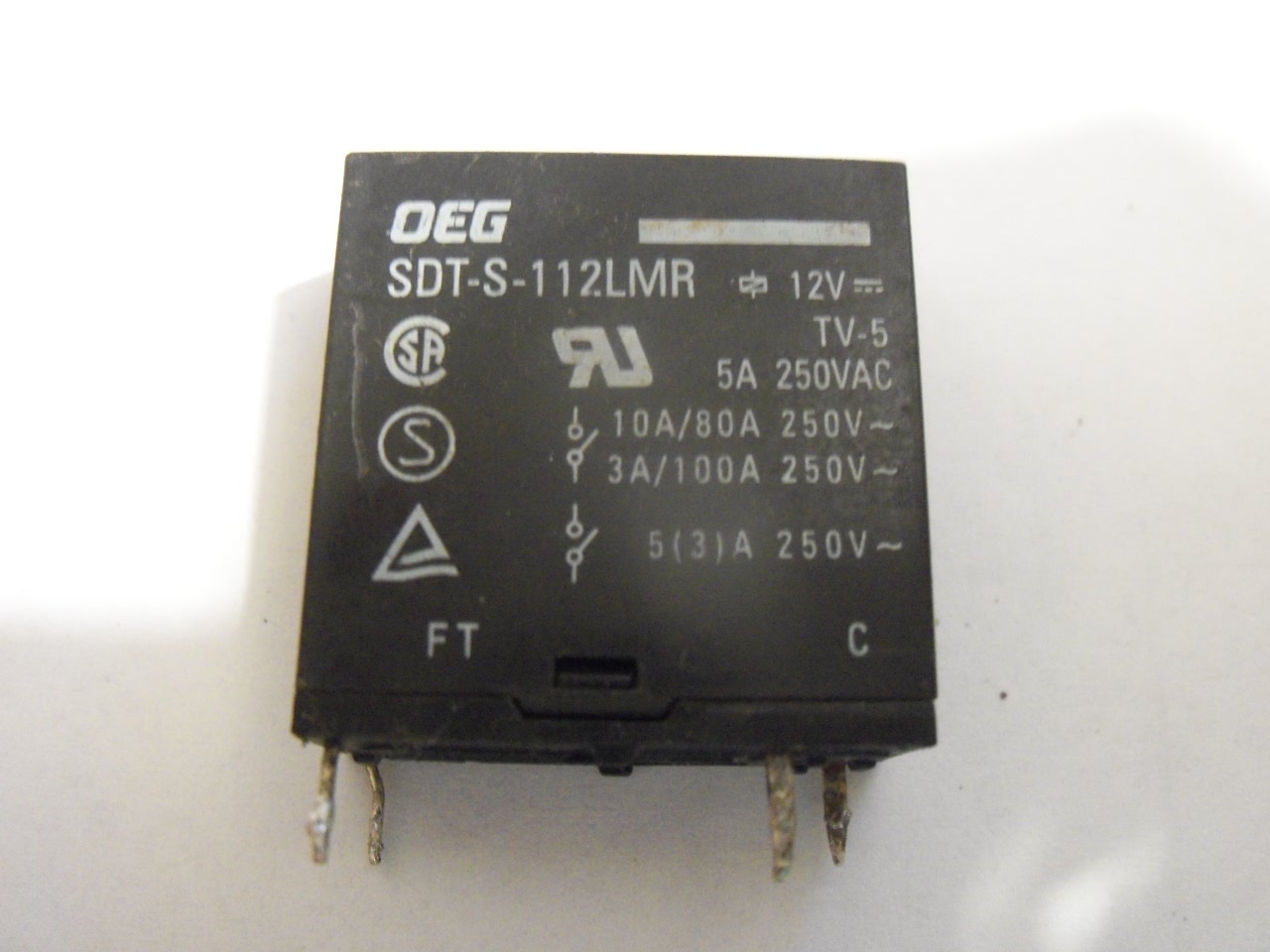

I experimented with several 50 watt resistors in the primary winding transformer circuit. I tried 5 ohms and 20 ohms. I tested relay coil it is 582 ohms. I used a 600 ohm 5w resistor in series with the relay. It takes about 1¼ seconds for the 24vdc PS to come up to 24VDC with a 20 ohm 50w resistor. I repaired the mosfet circuit then turned it on/off several times and never blew any more mosfets. Circuit appears to be fixed.
