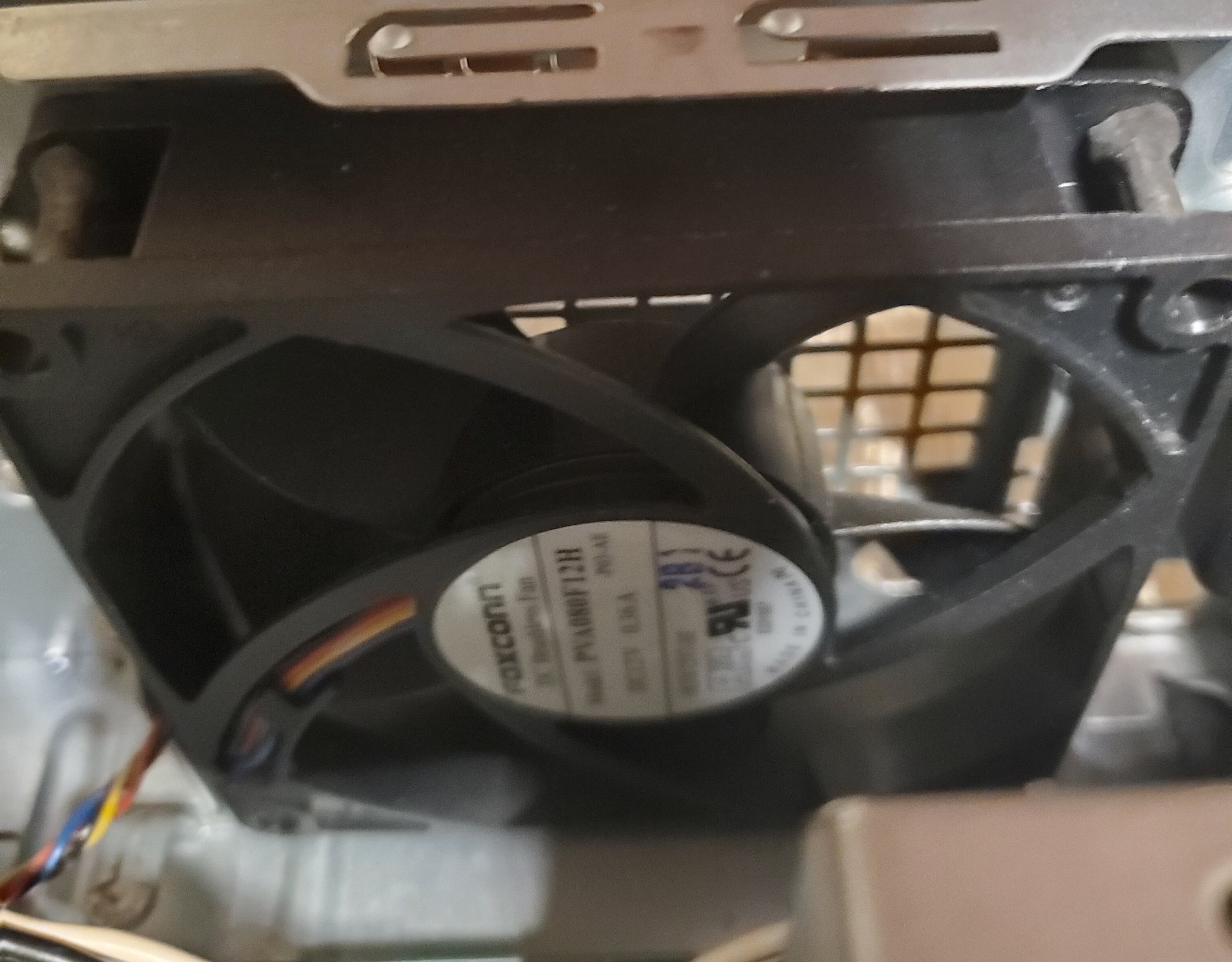

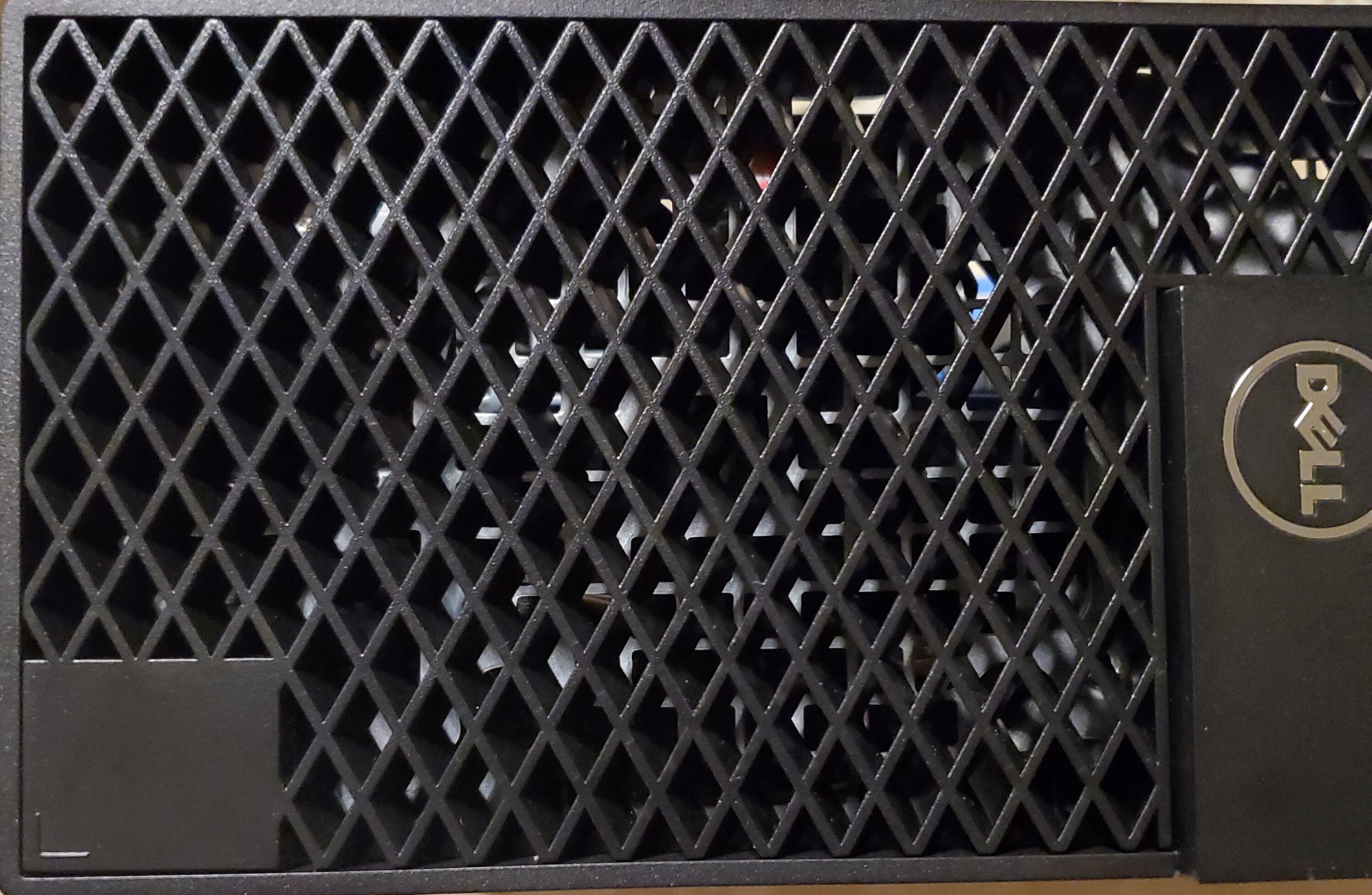

There is a set of mounting holes right behind the front bezel (which is generously perforated), into which a Dell fan from other SFF models fits perfectly,
AND

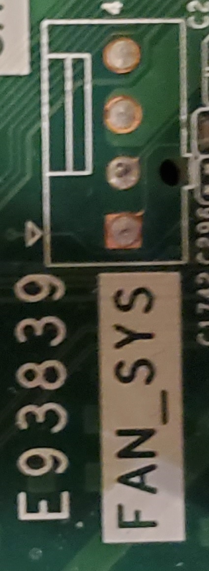

There is a set of 4 solder points on the motherboard with the printing "FAN_SYS". The pads are lined up, but there is no header (plastic rectangle), and there are no pins.
Now if that's not an opportunity/disaster waiting to happen, I don't know what is.
I know the fan fits because I got one and installed it. The fan has a plug on the wires that would fit into a header.

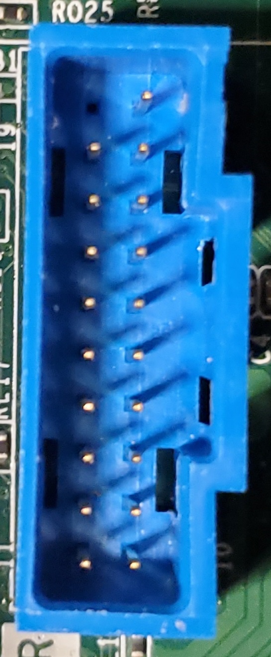

I have a header of the correct size.
I can even harvest pins from a different board.
What I need is
1) to know if there is actually any juice available at those solder points, and
2) helpful hints on attaching the header frame and pins without destroying the board.

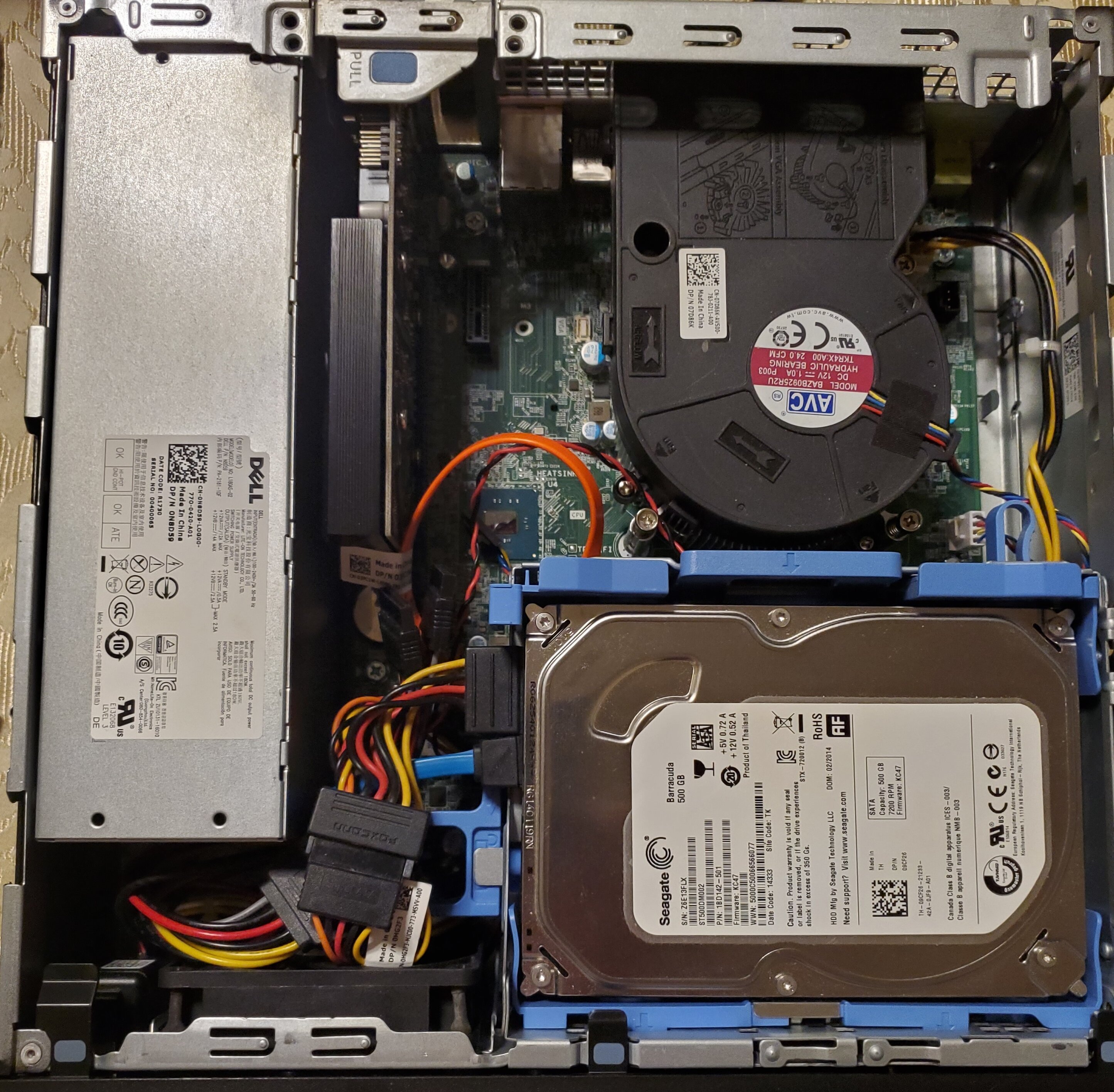

Pics:
Generously perforated bezel
Packed interior
Mounted fan
Solder points missing header and pins
What I want it to look like

As it's a four pin header, it could have a permanent 12V supply & ground on two pins?
Looking at the the four pads as in the photo, the top should be 0V and the second one +12V.
Third is speed sense, lowest PWM for four-pin fan.
A three pin one will also fit, omitting the PWM signal.
If there is power there, a fan should work. A four pin needs a PWM signal so that is more dependant on the hardware - though it's possible the +12 is also PWM controlled and relies on the components being fitted.
If there is no power there, you could use an adapter cable from a four pin drive power connector to run a fan.
