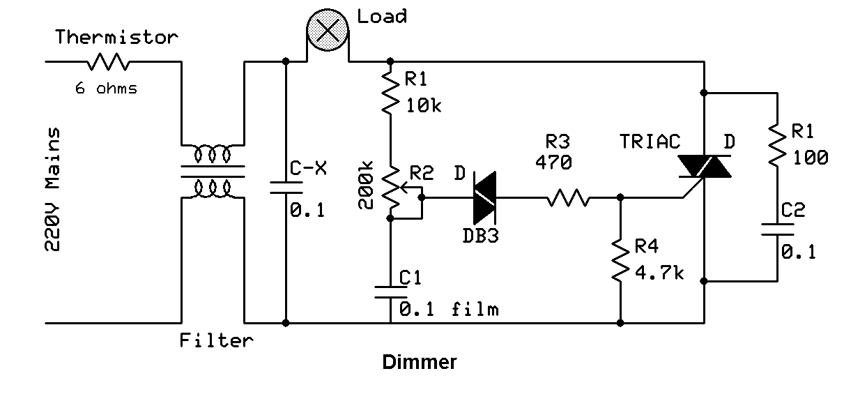

OK, now I made a conclusion circuit from the suggestion of yours. Learned some critical points of triac too. Any comments still?
One question: look at the R1, it's connected to the right side of the load here. I found in some circuit, R1 is connected to the left side (mains) of the load directly. What would be the difference?

Wow, that is the best dimmer circuit of that type I have seen- full belt and braces military design.:)

I would still add a suitably rated varistor in parallel with C-X. This should clamp transients to a level thet the SCR can withstand.
Interesting question.:) If R1 were connected to the left side of the load, the DIAC trigger phase angle may be a touch erratic, because after the DIAC fires, the capacitor will start charging again and will have some voltage across it when the mains changes from one polarity to another.

That circuit looks a lot better now.
The connection to R1 affects the current into the gate, limiting the current once the triac turns 'on'. The peak current is still higher, but the average current is a critical design point of most triac designs...it can not be too high or the gate gets too much power. In a more modern circuit the average current (and thus average power) is limited by using a pulse instead of a constant 'on' signal.
That brings us to the question, why are you not using a more modern circuit? Modern circuits eliminate the requirement for a diac which is another design point for some applications. With a diac the 'lamp' may not be able to be dimmed all the way down to near dark, but with a modern design the triac conduction angle is adjustable over the full range from nearly zero to nearly full on.
A modern design syncs the gate drive pulse to the line zero crossing, creating a pulse after a short time delay set by the user control. It fires once every half cycle. That maintains a steady conduction angle that determines the total power output, but it can be adjusted to nearly zero output.

Light was not totally dark with sensitive gate 2N6073 but I got totally dark with BT136. However PWM driver seems safe and good controller as your saying.
Maybe I can use a 555 chip to generate PWM and can drive the triac. The controller would need little more parts. And I think I need to protect the gate because it's connected to critical PWM chip. Maybe need an isolator.
