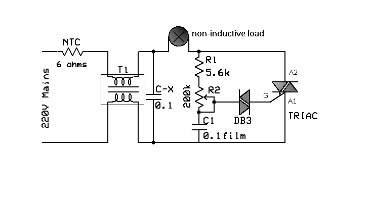

I prepared a dimmer for colorful lights which includes some transformerss colorful LED lamps and some (approx 100) colorful tungstan small bulbs (total wattage is around 80W). Thus I think the entire load is not 'inductive'. So I didn't add RC snubber to protect Triac in the dimmer. It would be compulsory if I used inductive loads instead. Look at the attached circuit.
Problem:
1) First I used 2N6073A (sensitive gate 4A, 400V) triac and it worked one night, but failed to another night. Failure: I am not being able to dim the lights, their brightness are full always. The damaged triac has unusual 'G to A1 short'.
2) Then I replaced with BT136 triac and it worked one night, but failed to another night again. Failure: I am not being able to dim the lights, their brightness are full always. The damaged triac has unusual 'A2 to A1 voltage drop of around 600mV' as diode.
What would be the reason of the frustrating problem? I used NTC, mains induction filter (T1) and X capacitor just for fun there. :) Do you think the T1 causing some inductive effect to destroy the triac again and again?

I am not good with triacs. Try R2, C1 and see what happens. (across triac) That should help with inductive kick.
I don't think your filter adds "kick" because Cx should keep that side from flying up.
Hi Willen,
You need a 470 Ohm resistor between the DIAC and the TRIAC gate to limit he TRIAC gate current when the TRIAC fires. This will also protect the DIAC from conducting excessive current
You should also connect a 4.7K Ohm resistor between the TRIAC gate and neutral. Otherwise the gate is floating when the TIAC is not conducting and this can lead to odd TRIAC behaviour.
The TRIAC needs to be mounted on a heatsink. An A1 to A2 short is a typical symptom of fusing caused by overheating. The TRIAC and heatsink need to be in free air. (the maximum junction temperature of the 2N6071 is 110 Deg C and the BT1216 maximum junction temperature is 120 Deg C)
You say that the load is 80W and that includes tungsten lamps. The cold resistance of tungsten lamps can be only one tenth of their hot resistance so you need to take this into account when calculating the TRIAC peak current. Also are you sure that the load is 80W. Connect the load to the mains without the dimming circuit and measure the actual current that the load takes. Observe safety precautions.

If you have transformers in the circuit then its definitely inductive, rons suggestion is a good one.
Something else important if your using transformers is to have a circuit that triggers symmetrically, the circuit above isnt much good for transformers in that respect.
T1 in Willens circuit is a losey anti phase EMI transformer, intended to absorb energy. Although it looks lie an ordinary transformer on the schematic its inductive effect is negligible.

OK, yes maybe it can work without failure as suggested, with RC snubber, Gate to neutral and diac to Gate resistors.

I Believe your 5.6K resistor is TOO LOW in Value, Supplying Too Much Gate Current.
Try the Circuit in Post 2.

A 400v rating on a triac used for 220vac is not really good enough either. That would be better on a 120vac system I always used the highest i could get even on a 120vac line like 600v.
Try a 600v or higher rated triac instead. There are sometimes surges and spikes on the line that we dont often think about. I worked briefly at a company that made high quality power line monitors and the tests for those things you would not believe.

The circuit of post #2 will also overcurrent the DIAC and TRIAC. The relatively high value phase angle capacitor is like a zero ESR battery. The current will be a short pulse but still enough to do damage. The problem may not be apparent for a while but as the overcurrent occurs 50 times a second sooner or later there will be a failure, especially as the DIAC and TRIAC junction temperatures increase.
To sort this circuit you need to increase the value of the 5.6K resistor, but you also need two additional resistors, as stated in post #3.

The NTC resistor does not protect against external spikes. It limits the current taken by the device at switch on. This occures with switch mode power supplies as the main input capacitor has to be charged at switch on. It can also occure with transformers (Particularly toroidal transformers.) if the instsntanious voltsge at switch on is trying to magnetize the core in the same direction it was left magnetized in when it was switched off. The core will be near saturation so there can be no flux change to generate a back EMF. I had to fit one to a 200 VA lighting transformer to stop it from tripping the 6 amp MCB on the lighting circuit. The NTC resistor has a high resistance at switch on and is heated up as a result of the current passing through it. After a second or two it's resistance drops so it does not drop the voltage to the equipment very much. Adding a varistor after the NTC or an ordinary resistor would provide better protection from external voltage spikes.
Les.
The antiphase lossy transformer/inductor on the input also protects against spikes on the mains.

Hu Willen, I remember you saying your supply is very limited, its quite possible a 3 phase motor on the same grid is generating noise problems.
Maybe try a transorb to clean up the mains.
