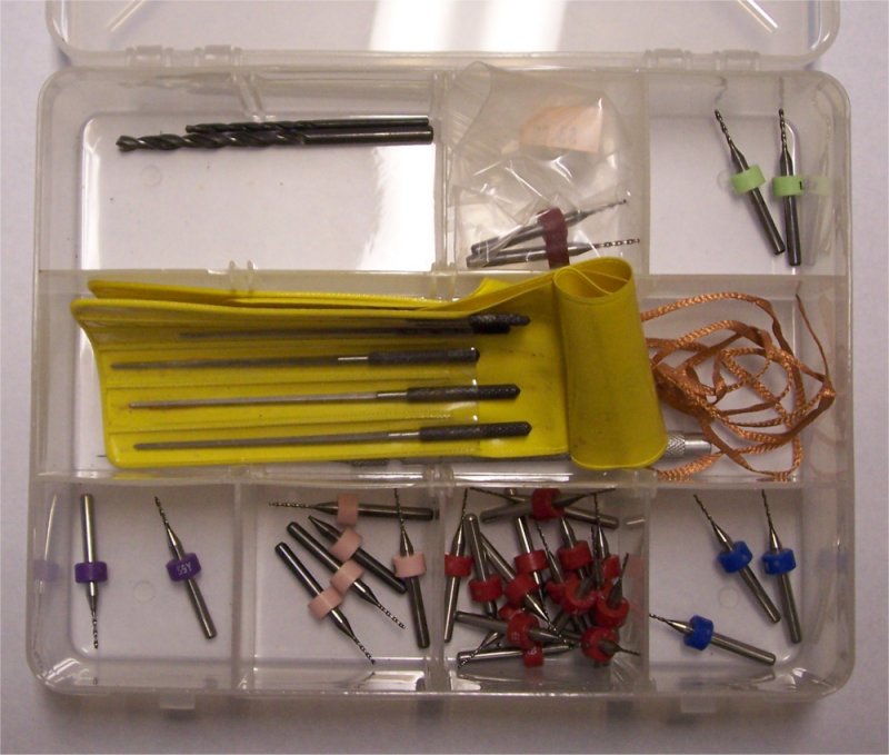

You will need some drills to finish your PCB. You will have to be very good to make these holes just holding a dremel in your hands. A holder that convert it as a drill press is better.
Before I was using my big drill press that spin at a maximum of 10 000 RPM. It was working pretty well. Never broke a bit. Now I use a small CNC machine that I assembled from parts found here and there and I drill my holes as the first step, before toner transfer and etching.

what kinds of drill bits you recommend for drilling PCBs? recently i bought a titanium coated one...because the usual black drill bits don't last for more than 2-3 boards... if i don't brake them...they become less sharp and they don't drill as fast as they did...
i have also ordered some cobalt ones...

These are carbide drill bits. You can find them easily on EBay. Just look for PCB drills. They are often used and resharpened but I think they are still very good.
Mine are comming from a local flea market. It is possible that they have been resharpened too. As far as the size, I use almost only the bit #63. It is the smallest that I have. I use that size for all the PCB holes and I use the reamers that you see in the picture if some holes are too small.
#63 is very small but sometimes, not small enough. I think that the #68 would be better for IC's.
