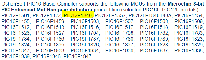

Oshonsoft doesn't support 12F1840, 12F683 can be bought for about £0.50 if you buy x5. Although a difference of £0.50 wouldn't necessarily make me chose the cheapest version.
Direct fro Oshonsoft site (https://www.oshonsoftbasiccompilers.com/pic16basiccompiler.php ):
John
But Oshonsoft PIC basic and PIC16 basic support different chips. It is possible to have one license only.
"OshonSoft PIC Basic Compiler supports the following MCUs from the Microchip 8-bit PIC Mid-Range architecture product line (selected PIC16F, PIC12F, PIC10F models):
PIC10F320, PIC10F322, PIC12F609, PIC12F615, PIC12F617, PIC12F629, PIC12F635, PIC12F675, PIC12F683, PIC12F752, PIC16F72, PIC16F73, PIC16F74, PIC16F76, PIC16F77, PIC16F83, PIC16F84, PIC16F84A, PIC16F87, PIC16F88, PIC16F610, PIC16F616, PIC16F627, PIC16F627A, PIC16F628 ..."
etc.
