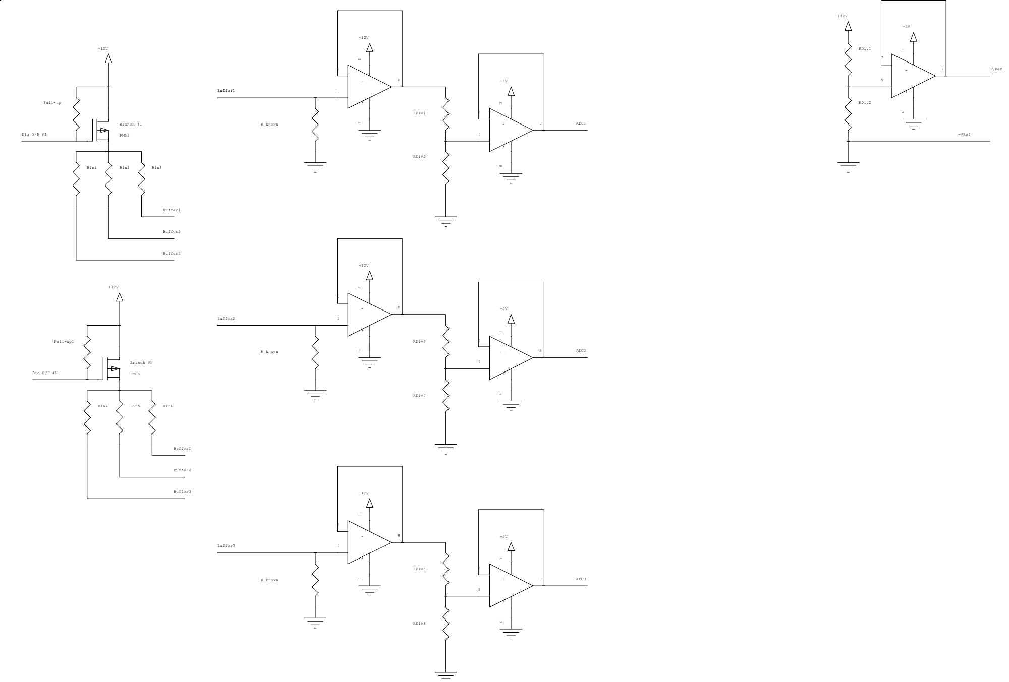

Now for the fun stuff... Since I apparently meet all the requirements for a project bound for failure I am going to post my circuit/application and I am seeking feedback on any/all aspects.
Application Description:
-We have a matrix of bins (in the case of the schematic 3x2=6 bins -- but this could be expandable too 50x50 if need be).
-Each bin can hold zero or 1 object at any given time
-There are 300 hundred objects, but only 30 unique types so duplicates are available
I want to be able to identify which object is in which bin when a button is pressed.
Schematic: **broken link removed**
The schematic shows Row1/Column1 'On'... So essentially I am reading what is in bin1. Bin2 is an empty bin.
I added the diodes because I dont want the current represented by the red line in the schematic.

What is the mechanism for differentiating one object from another? Does the object complete some kind of circuit inside the bin with a varying resistance or something? Can I assume that the bins are actually just component sockets, and the objects are resistors, with different values of resistors being different objects?
1. What is the purpose of Q1-Q3? and Q37-Q38?
2. How did you plan on separating the readings from bins 1-3 and 4-6? It looks like all 3 are always feeding into the same ADC input.
Assuming that the bins are, indeed, resistive, it appears that you are using the transistors (and an unseen uC) to matrix the bins. This is much more complex than needed. I would simply make a voltage divider with each bin. then read the voltage via a seperate ADC channel (or use a switch like Nigel said).
From your circuit, it appears the bins have a wide resistance range (0 to >.5M). The input impedence of most uC ADCs is around 10K, so you may have to use an op amp to meet the input impedence requirements.
For me, I would make transistor-switched branches. Each branch would contain 8 bins (or however many channels the ADC has). Each bin in a single branch would have it's own ADC channel...but this channel would be shared with other bins in other branches. By only activating one branch at a time (ie. with the digital output pins of the uC), the ADC only sees a particular bin from one one branch. You could then switch branches sequentally and record the readings. There would be a buffer before each ADC input, and just before that a resistor gong to ground (to form the resistive divider). I can draw a schematic later....just not now.
You can always add on more bins by adding on more branches- the requirement being that for each new branch that is added on, you lose another digital output line (used to switch that branch on and off). But digital lines are more plentiful than ADC lines anyways...on PICs at least....(I'm assuming you are using the ADC and digital output lines in a microcontroller since it is way more convenient and easier than learning to communicate with a stand-alone ADC.)
As others have suggested, I would try connecting the bin and the sense resistor in series across the 12v supply, then connect the bin/sense resistor junction to the input of an analogue multiplexer, the output of the multiplexer to the ADC. Use the digital outputs of your microcontroller to address the analogue mux.
That way you should lower the parts count, do away with your unknown volt drops on diodes etc.
Also the 12v supply to the bins does not need to be 12v, it could be a more managable 5v, or even Vref from the ADC stiffened up by a voltage follower. That way you are just looking for the ratio of Vref to Vbin to measure what is in the bin.
Here is what I would do (see image attached).
This if for an ADC with 3 channels (therefore 3 bin resistors per branch). If there are more ADC channels, just stick add more bin resistors in parallel onto each branch and connect the end of additional resistor to an additional buffer-ADC channel.
Each bin resistor in the equivelant location among the branches connects to the same buffer-ADC channel. The MOSFET switches the entire branch on or off (high-impedence will switch the branch off, while a low will switch the branch on...a high will also probably switch the branch on since a logic high of 5V is smaller than 12V enough to switch the MOFSET on.) You switch one branch (and only one branch at a time) on and then take the ADC readings across all ADC channels, and then switch the branch off, and move onto the next branch. You move through all the bins this way.
The VRef divider-buffer scales down the 12V to a readable level by the ADC to serve as a reference. You want the resistive ratio formed by Rdiv1 and Rdiv2 to reduce 12V down to about4.5V...a little less than the maximum of 5V for saftey reasons. It provides the ADC with an equivelant voltage reference for the 12V whose fluctuations do not follow the microcontroller's own fluctutations in it's 5V power supply (which the microcontroller uses as the standard voltage reference for it's ADC).
THe ADC buffer circuit is just really a half of a voltage divider (the other half is formed by the bin resistors) connected to an op-amp configured as a voltage-follower to act as a high impedence buffer. This is then connected to another voltage divider that has the same ratio as the Vref divider and is used to scale down the bin voltage so it can be read by the ADC. THis divider then feeds into the final buffer which goes to the ADC channel. The reason for the two buffers is that you cannot cascade two voltage dividers directly since voltage dividers do not necessarily have a high impedence input and need to drive a high impedence load. They can only drive a high impedence load because a low impedence load introduces resistances that are in parallel to the divider output, thereby distorting the divider's ratio. The buffer provides a high impedence input and low impededence output between the dividers (and the ADC).
The +5V and +12V Op-amps are DIFFERENT. They handle different voltage ranges (the supply voltage being the maximum the op-amp needs to be able to handle).
Hope this helps.

I told you a matrix of bins because thats what they are. I dont know what a 'resistive sensor' is... I am not using one (maybe I should be) but the schematic is my actual implementation.. The bins have two contacts and the object with the resistor completes the circuit.
MAJOR OMISSION THAT I TOOK FOR GRANTED: The objects contain a resistor, which can be 1 of 30 values.
For what its worth I'd be using an ATMega16... I wanted an external A/D because I wanted more channels and I wanted a larger range on the analog input pins. I didnt want to deal with switching 'banks of 8' because I felt the switch would have its own loss associated with it and I am aiming for accurate readings.
I apologize for this omission... You are correct in assuming the bins are just sockets and the objects complete the circuit via a built-in resistor
Q1-Q3 turn 'on' the colums, and Q37-Q38 turn 'on' the rows.... I want to be able to switch off the colums so I can read individual bins, I want to turn off the rows to reduce power consumption
If Q2 and Q3 are off then only bin1 is being read... I think answers question 1 actually answers question 2.
Well it doesn't really matter what ADC voltage range is used...I'm just saying it's easier to handle everything if the digital outputs to control the branches and the ADC channels are all on the same microcontroller. If you want accuracy try a dual-slope ADC (the price for accuracy is loss of sampling speed which probably isn't an issue here since you can't replace bin resistors so fast anyways)...but accurate is a relative term. How accurate do you need it? How close are the bin resistor values going to get to each other. Technically with such setups you can pretty much measure the value of the resistor anywhere between 0ohms and a maximum value rather than just "30 values".
A large analog range doesn't matter too much...it's the bits that really matter since you can step down the 12V AND the ADC input and still have the same number of bits and therefore the same resolution. There may be losses involves with the stepping down process and offsets introduced by the op-amp which can be minimized if you are careful about the op-amp you pick (it's not hard to find one with offets orders of magnitude smaller than the minimum resolution of the ADC). But this is probably moot since resistor tolerances are much higher than the errors introduced by these offsets. You just search op-amps tables on Maxim's website.
The way you have it wired up in your circuit does not allow the transistors in your circuit to be switched...they are just always at some static state it seems...no microcontroller pins or signals anywhere...
Also...you know the MOSFET switches have about the same losses as your BJT switches right? It doesn't really matter.
I edited it my last post and schematic to step-down the bin voltages so that they could be read to the ADC.
Thanks for your suggestions... I have to really sit down and try to make sense of it all before I reply... But to answer your question the transistors will be switched by a uC. I stated that the schematic is shown with row1/column1 in the 'on' state, but failed to mention that is initiated by the uC (ATMega16)
Oh, I see. You replaced the uC pins with static voltage sources to represent an output state.
You may need a darlington or MOSFET rather than a pure BJT for those switches since the uC might not be able to provide enough current from its pins.
One last thing you should consider is the part count per bin...it's quite high. 50x50! (I'm obviously biased towards my circuit in this aspect).

Isnt using a switch essentially the same as matrixing or did i misunderstand your implementation?
Matrixing must requires switches, but not all switches require matrixing applications. You are basically using the BJTs as switches, but there are many types of switches. Same thing. I prefer MOSFETs over BJTs...it's just me. Simpler switching requirements (lower current and voltage controlled). It just means larger MOSFETs can be switched directly by a uC pin. Make sure you understand how to switch MOSFETs and BJTs on and off and their voltage/current requirements at the base(BJTs) or gate (MOSFETs).
Yours goes by a cartesian grid. Mine goes by clusters of #N, where N is the ADC channels available. Mine is not quite matrixing, it's more clustering or branches. Mine is arranged more like bytes in computer memory than a table. To expand mine you add on additional branches. It doesn't have the geometric row-columns grid bin selection like yours. However, the reason I made mine was part count and expandibility cost (like I/O pins) are much lower for large scale, which was pretty much the only thing I had in mind when I was making it.

Ok I finally got a chance to think about your idea...
I am certainly going to use MOSFETs now.
I would also love to get rid of the diodes, because like you said my part count per bin is high. I also dislike the diodes because according to the datasheets the forward voltage of a diode can vary which really throws my expected analog values off.
As for rearranging the matrix into 'branches'... I understand the benefits and still need think about this some more.
