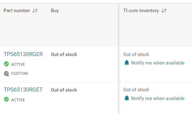

I've sighted the Texas Instruments TPS65130 too. Unfortunately they're out of stock, not to mention the time needed to spend on the PCB design and testing... and I just need around 30 units anyway so it's not worth it.
