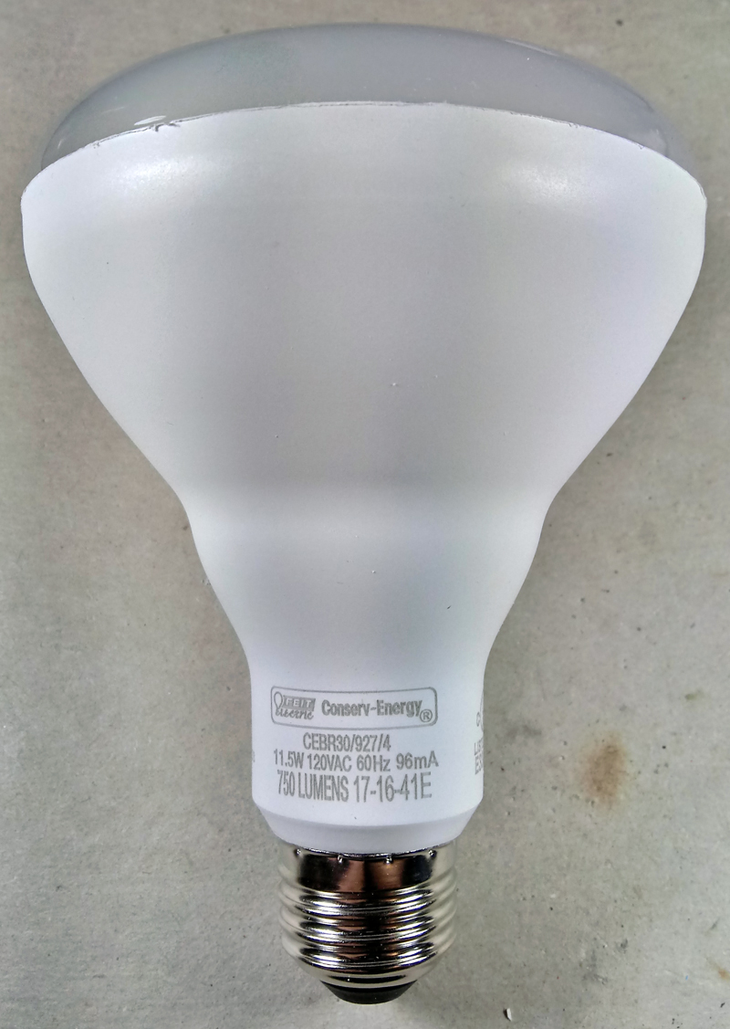

I have a set of lights with LED bulbs like this one.
One of them starting blinking intermittently. It was annoying. I switched bulbs between two sockets and the same one continued blinking.
I replaced it and there is no more blinking. But I wondered if there was anything in the bulb that might interest me. So, I took the top off.

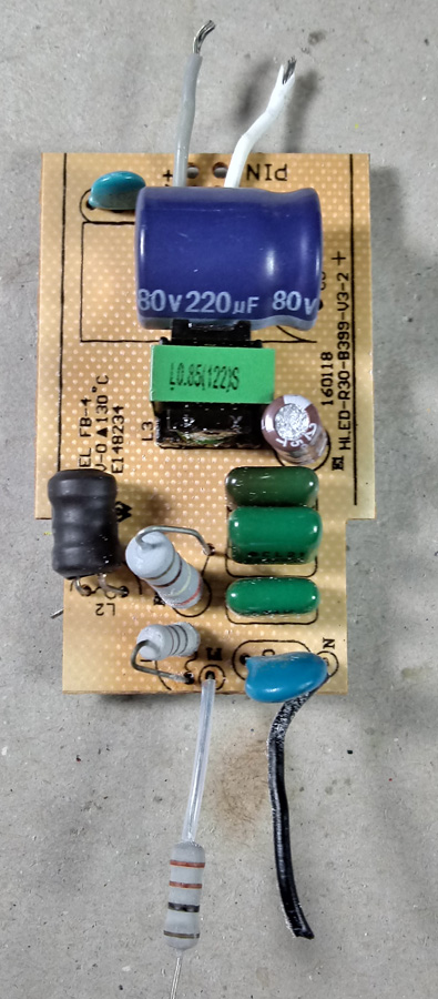

Then I took the bottom off and removed the high voltage guts (there are some smt chips on the back). There is nothink I want from that board - why scavenge a few cheap parts from something that was defective?

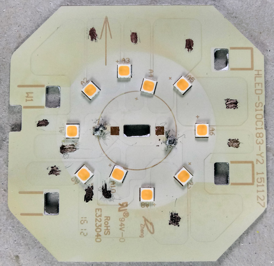

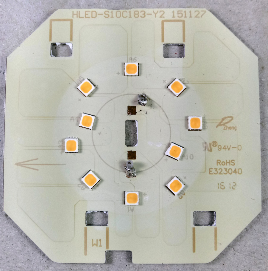

The LEDs interested me. Here is a close up of that board and it is metal (with a lot of heat sink compound on the other side).
I think you can see that the LEDs are in a serial configuration. I estimated a 3.6V drop and I really have no use for a set at that high of a voltage to use all ten in the circuit.
I scratched through the painted surface to make some "pads" and checked each LED and they all lit. I suppose I could make use of some/all of them in a parallel fashion. It has been placed in the junk box.

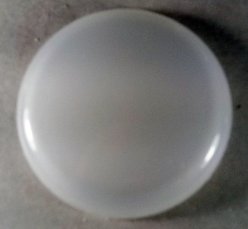

One piece that I saved and probably will use is the surface of the bulb.
It may be a decent light diffuser for some photography uses.

I think the electronics part could still be working and the blinking caused by a faulty LED. I have had a similar problem with a unit I built using seven 1 watt LEDs in series fed with a boost converter modified to give a constant current. I think that the LED warms up and thermal expansion breaks a connection inside the LED. The LED cools down again and the connection is remade and so the cycle continues.
Les.
I have also had LED lamps blink when the capacitors have degraded.
The ones that have a bridge rectifier directly on the input can be run with an external rectifier and smoothing capacitor. That avoids the need to open them up.
I've had this and I think it was one of the bond wires inside the led failing, shorting out that led made the lamp work again.
