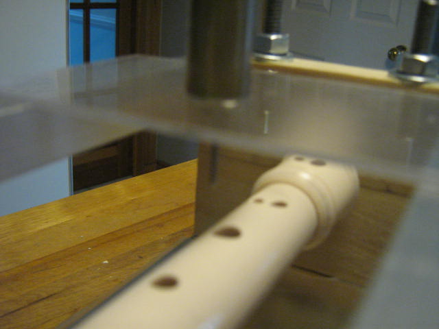

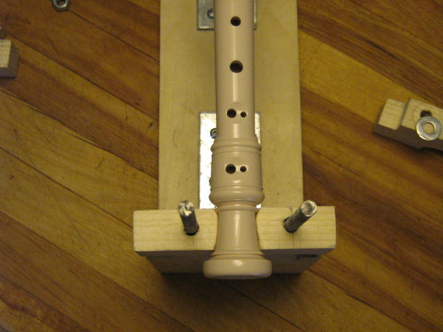

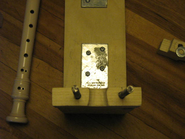

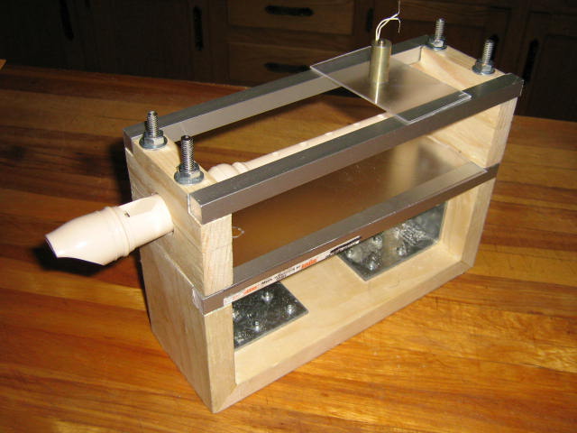

Here are a few more photos documenting my progress with RCD-1 this week. The first photo is probably the closest picture I'll get to the first concept drawing. Wooden braces to secure the recorder have been mounted on the 1/4-20 stock, themselves secured with nuts and washers.
Some scrap pieces of acrylic sheet are posing in to give an idea as to how the final project will look - yes, the sheet's a bit mucky, but it also has a glare-resistant coating on one side, in case you're wondering. Also sitting in for final-impression reasons only are four 1/2" square aluminum rods. Although not presently attached, these rods will eventually be bolted to the acrylic sheet with some brass machine screws, and the acrylic sheet will in turn be sandwiched between the wooden braces with two holes on each end of each sheet to accommodate the 1/4-20 stock.
In the second photo you can see a small piece of acrylic sheet on top with a solenoid bolted onto the sheet, again just as a trial to help visualize the final thing. From this (fuzzy - sorry about that!) perspective it looks like the solenoid pin is quite far from the recorder, but it's only between 1/4" and 1/2" away. This gap will of course be taken up by the padding and retraction mechanism mounted to the solenoid pin.
The last two photos give an idea of how the recorder fits into the wooden braces, with a custom-cut groove to match the unique contours of the instrument. I should have some photos of something close to the final physical parts of RCD-1 by the end of the weekend, and I'll be sure to post them here. Then, it's on to playing with the electronics end of things!

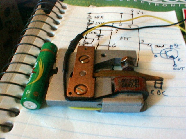

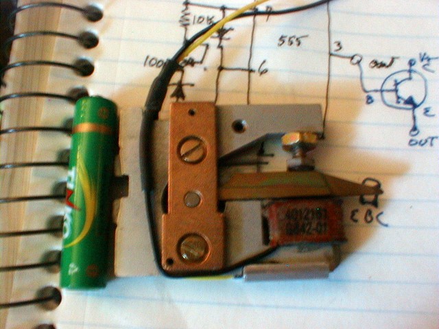

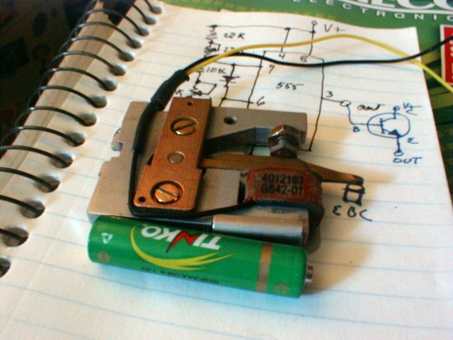

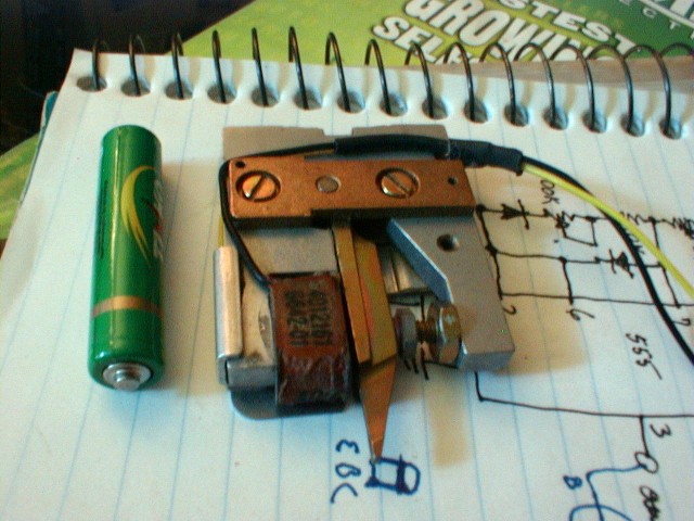

I have hundreds of these printer hammers from some old IBM printers. The coils are 5.4 ohms, and will work off 2 AA batteries, but a little weak. Work fine off 6 volts, but in the service book the control line says 60 volts. They are huge printers...
Anyway, I've got a dozen or so that have been inside the house. The rest are still on two of the printers, and one block of them in the carport. The outside stuff, I have no idea of the condition, been atleast 10 years of huricanes and severe storms, intense heat, but should be okay. If interested, PM me and I'll put some in the mail for you.
Of, work fine directly off a 555, adding a transitor driver didn't seem to have any effect. Haven't tried anything with a microcontroller. They aren't very strong, so kind of killed the millipede robot idea I had...
That's a AAA size battery for scale...
