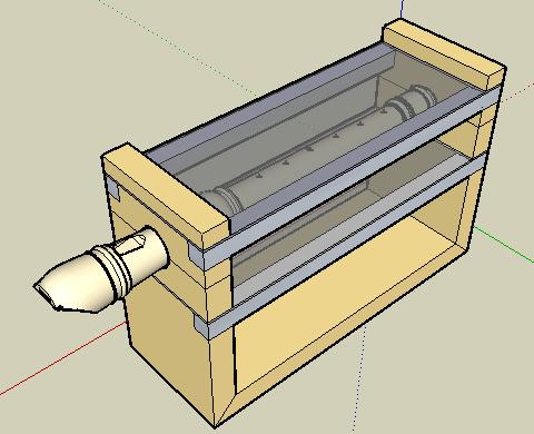

Here's a concept drawing of a recorder-playing robot I'm building. For now it's just the apparatus for holding the recorder. Solenoids will be attached to the acrylic sheet above and below the recorder to act as fingers. I'll post more pictures as I progress - I plan on having RCD-1 running by the end of August.

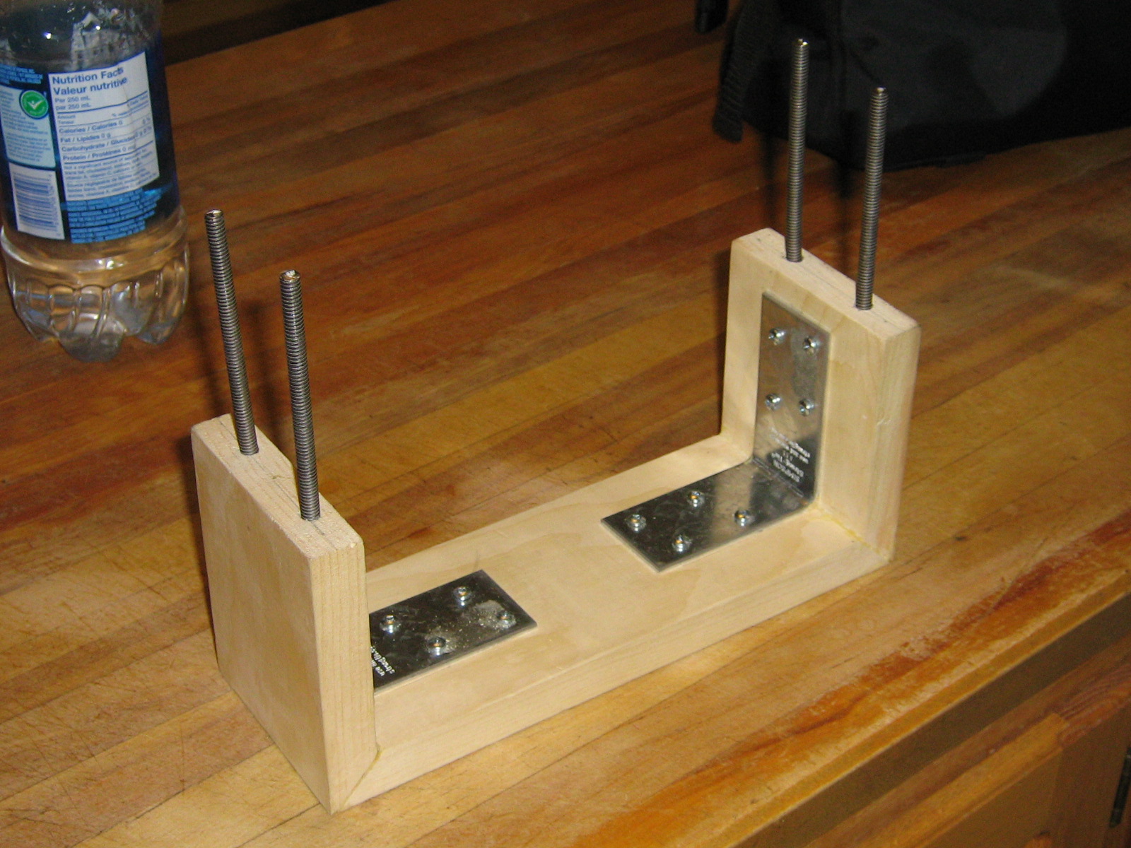

Here's what I was able to get through today. Some sturdy brackets are added (not shown in concept drawing) to support the vertical ends of the recorder holder. The wood is from a plank of pine. The four pieces of 1/4-20 bolt stock will be used to tighten down the other pieces seen in the concept drawing, but not yet seen here because I haven't made them yet!

Instead of solenoids how about something like common hobby servos's that could be used to move a sleeve on the flute up and down to allow variable amounts of the hole to be exposed? Ideally you'd want a modified hole shape to make the sleeve movement comlpetly linear but it would allow for significantly more control over the strength of the note's being played, allowing the ability to gives some 'feeling' to the music, or complex smooth note slides.
I don't know if I'm understanding you correctly, but the fingerings for the various notes on the recorder are not consecutive. Although generally lower notes use more fingers, that's only a very loose definition of what happens. In practice, covered/uncovered hole combinations can look to the untrained eye as almost random. Look up a fingering chart for the recorder and you'll see what I mean. Covering holes requires independent control of the first three fingers and thumb of the left hand, and all four fingers of the right hand. In addition, to play all chromatic notes over a two-octave range a technique called half-holing is required, which means the left thumb and right ring and little fingers must be able to cover both their entire hole and only part of their hole at any given moment.
...how about something like common hobby servos's that could be used to move a sleeve on the flute up and down to allow variable amounts of the hole to be exposed?
I get what you mean now. At first I had interpreted "amount" as "number." It's an interesting idea, but I think it's beyond the scope of this prototype. Truth is, I'm not too sure about the context for glissandi on the recorder, i.e. what it involves as far as finger placement on holes. Further to that, I can't really visualize what the mechanical means of accomplishing that might be in terms of having a way to cover the holes both quickly and at a slower, variable speed.

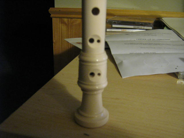

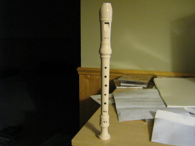

There will be eleven solenoid "fingers" on the RCD-1. The reason for that is there will be one per hole for five of the fingers, and two per hole for the other six fingers in order to accommodate the latter three holes' need to be half-holed (I'll post a concept illustration in the near future for how the half-holing business will work on RCD-1). So getting to your first question, it will be possible to represent the fingering of a note to RCD-1 at any given moment with an 11-bit number. I'm guessing if I'm doing that on an 8-bit PIC I'll have to use two bytes (16 bits) to get all the fingerings in. I think I might use the leftover 5-bits for details like tonguing* (e.g. 1 = tongue, 0 = don't tongue) or an indication that the tune is over and to shut down the robot.

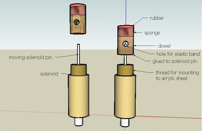

Here's the concept drawing of a solenoid modified for use with the RCD-1. The solenoid pictured is designed for only the recorder holes that are fully covered during playing, that is, the holes that don't need to be half-holed. I'll post another concept drawing of this solenoid in context as it will be assembled with the rest of the robot, and my design for the half-holing modified solenoid, shortly. For reference, the base part (thick part) of the solenoid is about 1" high and 1/2" in diameter. I make no claims for accuracy, as I'm only going by the info on the solenoid's website since I haven't received the actual thing in the mail yet.

I wonder how much noise the solenoids will make.
Same here. By far the hardest part about making automated musical instruments is the fact that most parts you can scavenge weren't designed with taking into account as a perogative how much sound they make during their normal operation. I don't suspect the solenoids will make much sound at all when activated, and as you can see from the concept drawing, their impact on the recorder will be cushioned by a sponge and piece of rubber. They're not moving very far, and they don't have to press very hard against the recorder. The thing I haven't fully taken into account is when they retract from the recorder with the elastic band - there'll have to be some sort of stop on the solenoid at the opposite end of the pin/finger to prevent the pin from jumping/falling out altogether, but again, whatever I use to stop the retraction can be spongy to limit the amount of operation noise.

If you want to limit the sound coming from the solenoids, why not wrap them in foam or somthing? What about bubble wrap? I dont know what that would do, but its just an idea.
