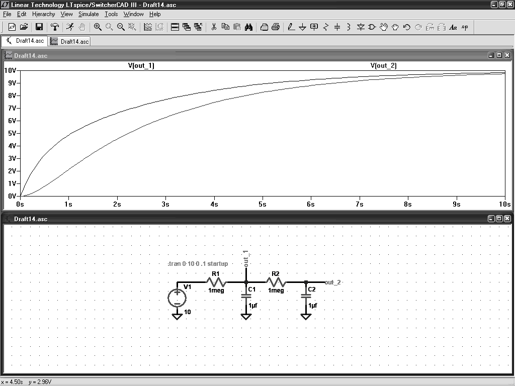

I have a fairly simple question. If a capacitor is being charged through a resistor the time it takes to reach full charge or for the cap to reach the battery voltage is 5*RC. If two caps are in series...and that is charged through a resistor will the time for it to reach full charge/battery voltage be 10*RC?
I may have my theory completely wrong. Would really appreciate some help.

in a single R-C circuit, the voltage on the capacitor varies as exp(-t/R/C) but when two RCs are cascaded, the load on the first R-C modifies its voltage so the math gets complicated. At any rate, by 10RC, the 2nd cap is nearly fully charged.

A capacitor will charge to a little over 99% of final value (the battery voltage) in 5 time constants (5*RC). If you put two caps (C1 and C2) in series, but still have only one resistor, the resulting capacitance is
C=C1*C2/(C1+C2)
As you can calculate, if C1=C2, then the resulting capacitance is half the value of the individual caps.
Calculate the new time constant using this capacitance.
