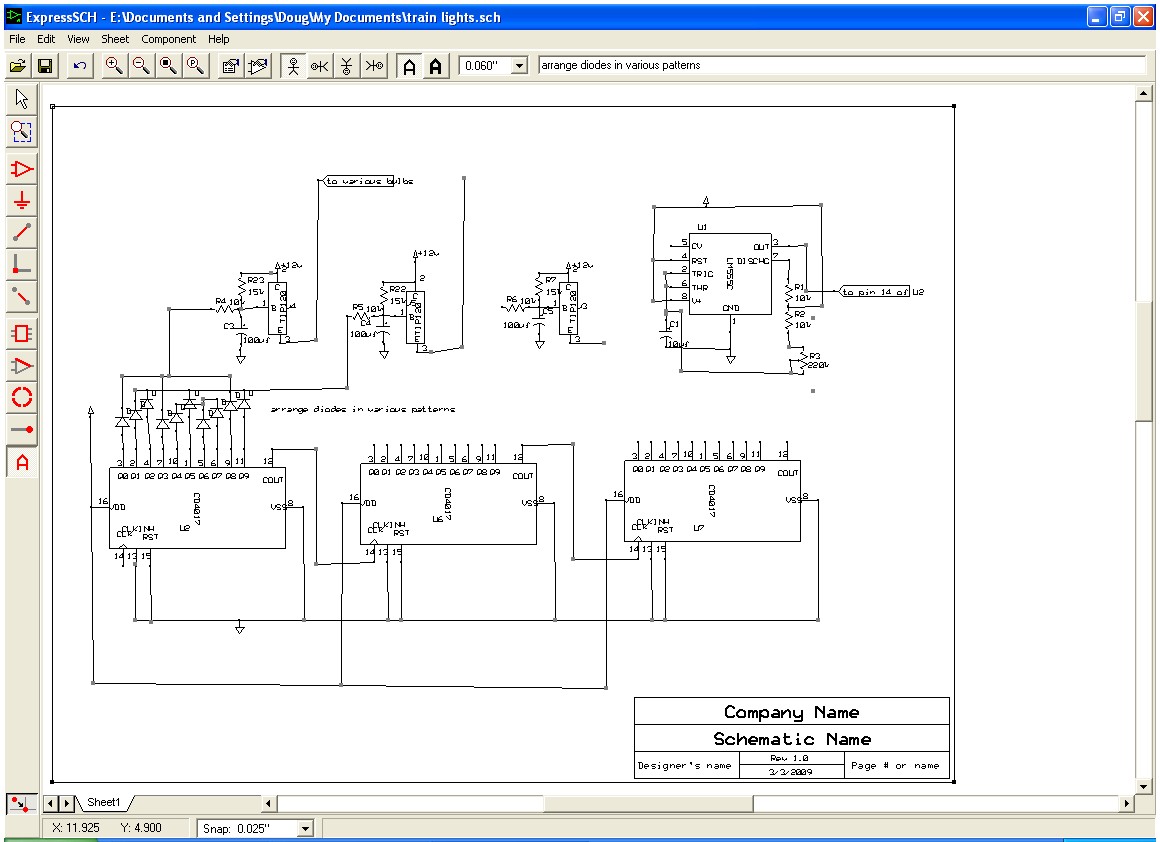

I've been asked by my local model railway club to build a circuit that will light up houses and shops randomly on the new layout currently under construction. My first reaction was to use a tested and working multi-aspect European road traffic light circuit, substituting the coloured LED's for white ones, and slow the sequence down a high value resistor.
Unfortunately, the builder is determined to use 12v grain of wheat bulbs; I don't have any design skills and I tend to build circuits from existing diagrams - but I don't have any circuits that will do this job. The only suggestion I can think of is to wire the bulbs to a series of mult-pole rotary switches and mechanically turn on and change the lighting. This seems a bit ham-fisted, though.
Anybody got any suggestions or links to a circuit?

you would be better off with LEDs but for your sequencer, you can use 74HC4017s

I was thinking perhaps several 4017s with transistors on the outputs.
use an emitter circuit for a fading effect.
will draw up something to start.
I'm thinking of a slow-latched, 30-bit random number generator with lamp drivers. I did see "random" as a requirement.
this circuit needs tweeking
here is a simple solution that should work.
the componet values may need tweeking a bit.
just arrange the diodes in various patterns etc.

Thank you for the help, folks. Very much appreciated. I'll get busy with
MrDEB's schematic this weekend and see what I can get working.

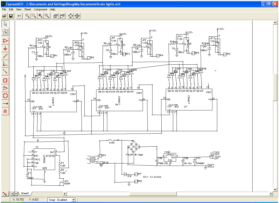

slight revisions w/ PS added
I added a regulated PS as well as an unregulated one for the bulbs.
this should work??
