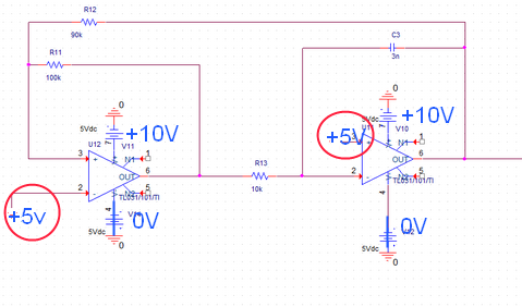

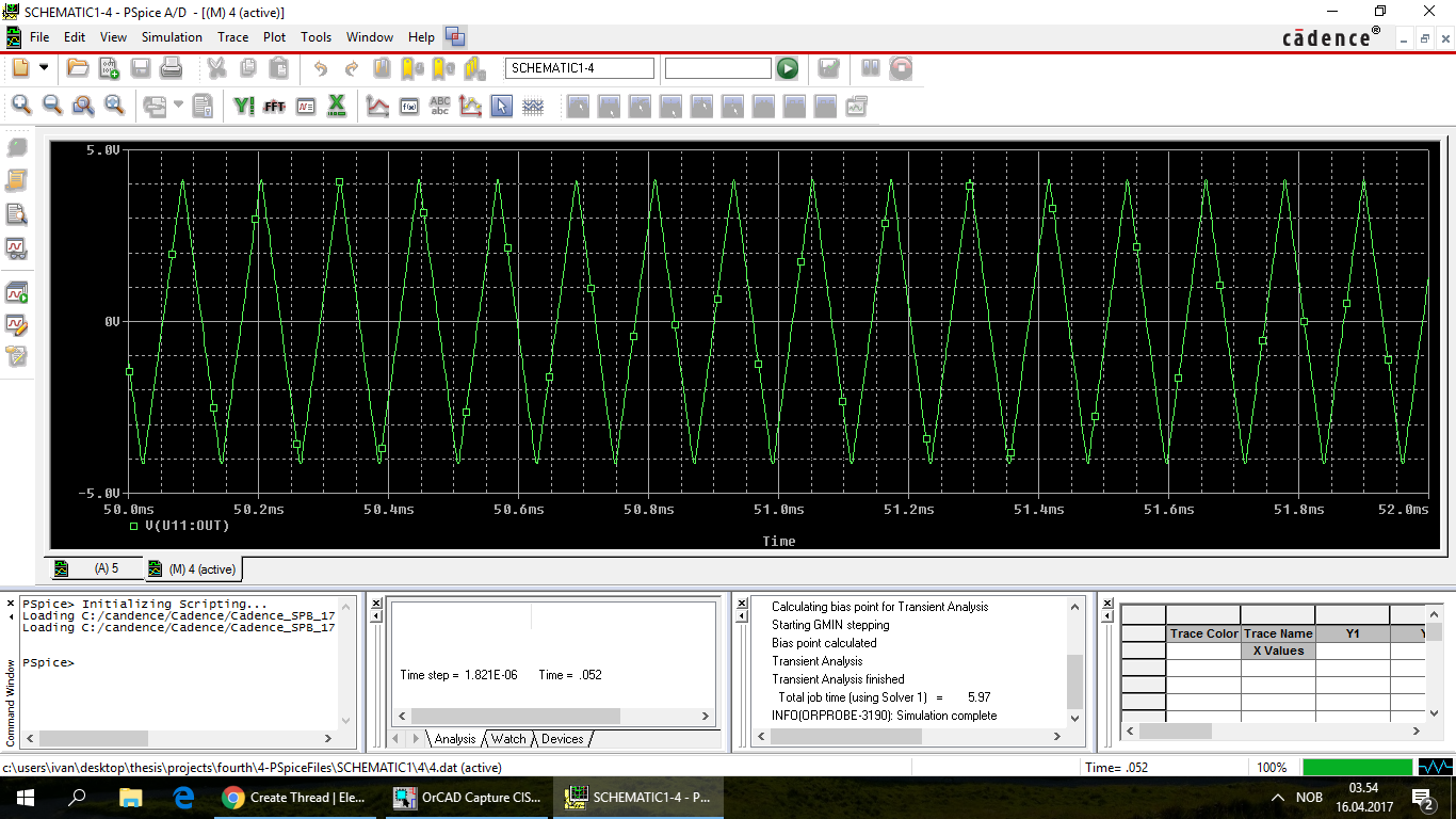

I have triangle signal in my circuit, i know how make it lower ( put capacitor), but i have no idea about opposite step.
What should i add for rise it up ( 0-10V)

The output of U11 is centered about GND, but the output of U13 is just DC at the opamp's maximum positive saturated output value. Are you asking about adding a DC component to the output of U11 before it goes to U13? This can be done with a coupling capacitor and some bias resistors.

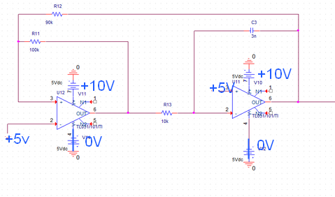

Hi. Yes, i'm asking about point with green marker. As you can see, i added capacitor, but voltage goes down, can you explain how can i raise it up?
If you made the (+) supply +10V, the negative supply = 0V, and what was gnd now is +5V.
Now your output will be from +1V to +9V.
This is close to what you want.
I would have just used a summing amplifier and an adjustable DC voltage supplied by a potentiometer.
It's perfect. How you calculated that it should be from +1 to +9 V. What is equation can i use if i need from 0 to +5 V?
The voltage circled in red sets the center of the wave form. Try setting this to 5.5V or 6V and watch.
R11 & R12 set the end points. I am doing this in my head so might be wrong. lol
Don't go much bigger. It will stop working close to 100k, and above.
R13 & C3 sets the slope. Volts/uS.
The voltage on the power supply pins (+5, -5 OR +10, 0V) should cover the output you want. (probably should be one or two volts larger in range than the output.

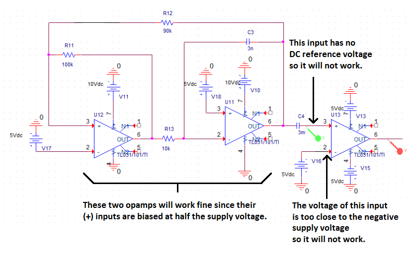

The capacitor you added prevented a reference voltage on the (+) input of the 3rd opamp.
Your SIM program did not read the datasheet for the TL031 opamp:
1) The TLo31 opamp inputs do not work if they are within 1.5V from the -5V supply but your 3rd opamp has its (- ) input directly at -5V so it will not work.
2) The output of a TL031 opamp cannot go anywhere near the +5V power supply voltage, some will go only as high as +3V.

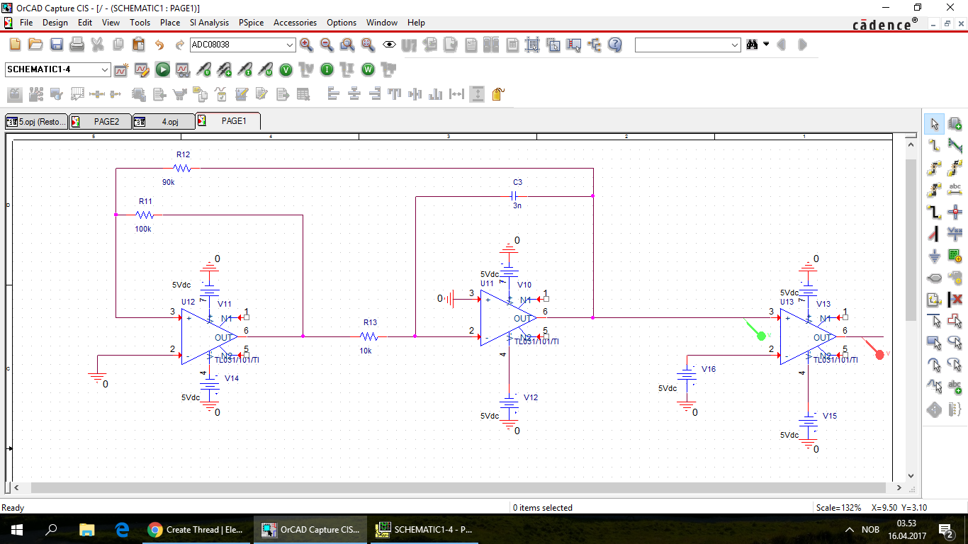

It works perfect if i have power supply -5 - +5 V

The stupid SIM might work but the real circuit will not work.
1) An opamp cannot work without a DC reference voltage on its (+) input within its common mode input voltage range.
2) The output of a TL031 and most other opamps cannot go anywhere near its +5V supply voltage.

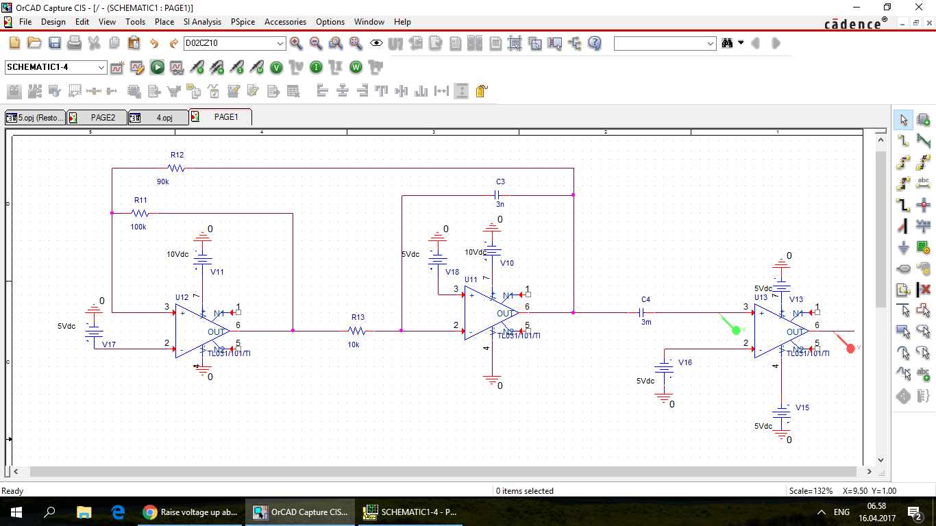

This circuit is usual Schmitt trigger+differntiator, nothing especially. I saw few videos where circuit worked
Maybe the huge value of your capacitor C4 takes a few days to charge with the very low leakage current of the Fet-input opamp.
Here are the other problems with the opamp U13:

I deleted C4 already, but can you advice something with comparator?
