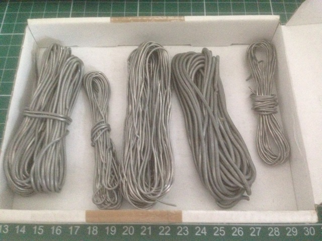

I use this:

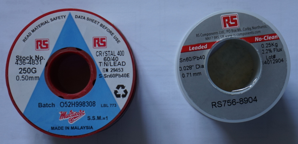

I use this .. ..

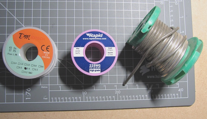

and this .. .. .. .

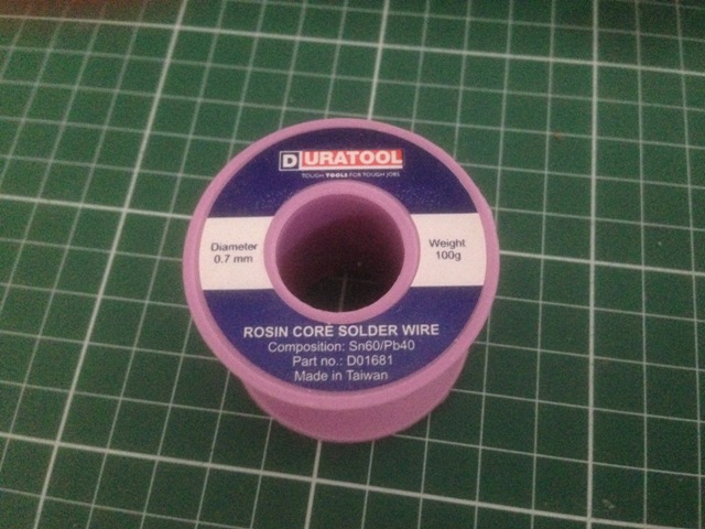

The Duratool stuff is 60/40 from my local shop; the stuff in the box came from a Sunday Market I visit now and again. There is a guy there who sells electronics gear .. .. nothing run of the mill or weird or unusual; he also has goody bags and goody boxes ... I bought a Sainsburys carrier bag labelled solder wire for £8 .. inside there were about 60 bundles such as you can see in the box ... I imagine they are very old because the flux coating left after use is dark brown and very glossy .. smells a bit too .. but it don't 'arf solder well !!

Been taking the 60/40 for 50 years . nice and shiny , the DMiotech is . 4 mm . Big stuff for 15mm copper pipe...:joyful:
