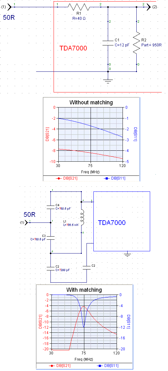

Zener_Diode said:
as I understood the tda7000 is good for 75ohm antena, I need to make it for 50ohm antena, how can I do it???
I wouldn't worry about it, I doubt it's got any low impedance matching inside the chip - it's probably only specified at 75 ohm because that's what's used for FM radio aerials.
Doing some matching may not be a bad idea as can be seen from the plots. Without matching the there's quite a bit of loss and bad return loss.
With matching the input loss is 4dB less and the return loss very reasonable in the passband. Also the added selectivity will make a difference in performance.
How did you arrive at the circuits and plots?, there's no suggestion in the TDA7000 datasheet that the input impedance is 75 ohms? - which is what I suggested in my pervious post.
The internal block diagram shows it has a balanced input, with a 700 ohm resistor from each input to a 1.4V reference. The second input is simply grounded via a capacitor in the application note.
