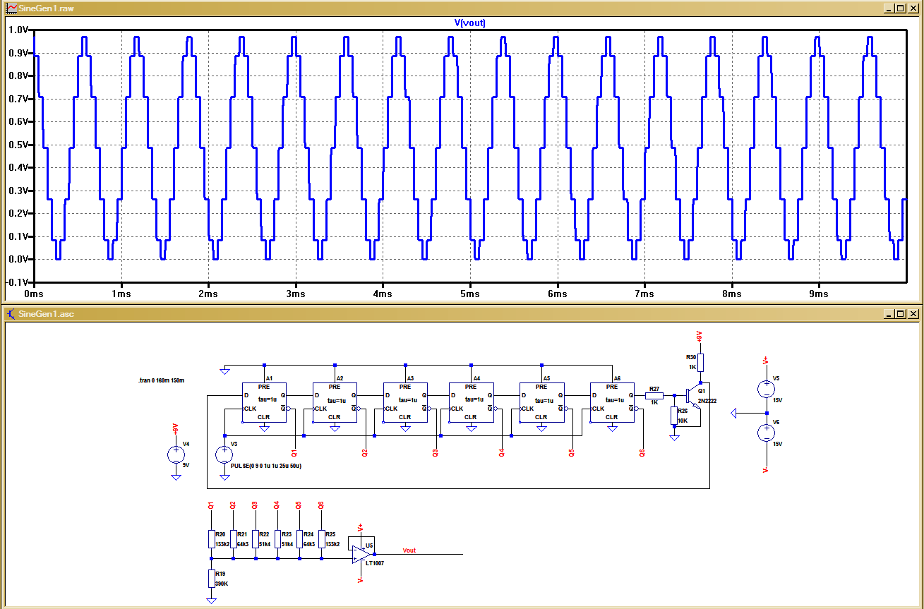

Use a 4 bit counter circuit, clock it with a pulse.
On the output pins of the counter have weighted resistors in a OPA summing amp.
but counter counts in one direction only.
sine wave needs reverse counting also :?
Look at this, add a filter.

To get a reasonably low distortion sinewave you need many bits (likely 8 or more) of D/A conversion and a look-up table to generate the proper bit pattern that most closely approximates a sinewave.

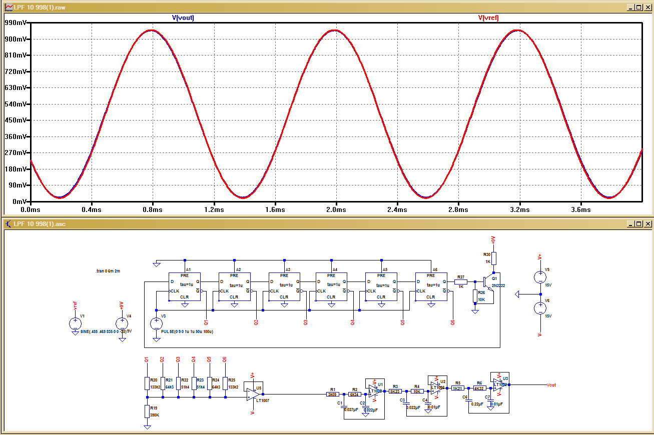

If a good quality LPF is used, a very good sine wave can be generated from a simple 6 stage Shift Register.
A 8 or more bits are not required for good sine wave generation.
This LTspice simulation was posted recently bt member 'atferrari'. https://www.electro-tech-online.com/threads/trying-to-improve-an-active-lpf.122554/
I have added a reference sine wave to the plot and superimposed it on the LPF output, IMO thats an excellent match.
I should have added to my post that you need a look-up table and many bits if you want to generate a low-distortion sine-wave over a wide frequency range without a (tracking) filter.

May i ask what these 3 op-amps are doing in series here ?
here i built this , how do we select capacitors value in filters ?

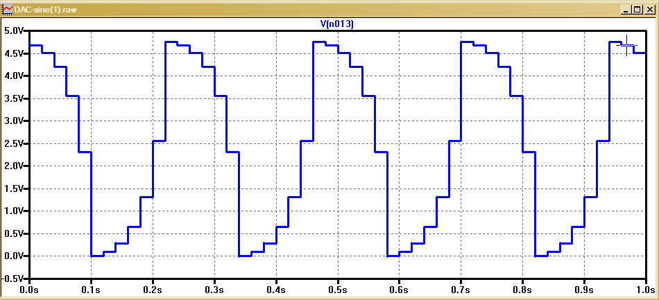

hello,
I corrected this , but why is weighted resistors are wrong , i learned them from my book !
  • DAC-sine.asc
hello,

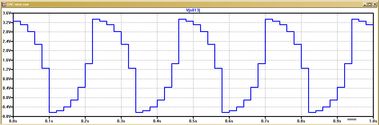

Look at this image of the stepped waveform at the input of U1 OPA, its no where like a sinewave.??
Look a the resistor values in the LPF image I posted earlier.
BTW: You still have a 9Volt input on a 5V powered 4013.!!
the value of resistance written in schematic is 3k29 what is this ?
Hi neptune,
You seem to be using an R2R resistor network for your analog level generation. If you intend to use a constant width pulse to clock your counters then you cant use an R2R network. An R2R network will give you a ramp, not a sine wave. If you want a sine wave you have to use a different network where the resistors are chosen to give different output voltages for each logic state.
Hi neptune,
oh ! So how does one choses resistance to generate sine wave ?
Consider that you are trying to create a Sine wave using 6 steps,,,, each 6 steps Up creates a sine wave section from say +Vpeak to -Vpeak and and the next 6 step down say the -Vpeak upto +Vpeak etc.....................
So the weighting of the resistors is chosen to give a +peak to -peak approximation of a sine wave at the input of the 1st OPA
Look at the LPF link I posted for guidance.. clue,, think Sine wave tables.
