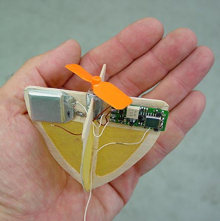

epilot said:
Well that is not so easy to be built I think. If you could make the whole propellers the same then you must consider the RPM for 4 motors (they must have the same RPM too).
If I was you and wanted to make something that just is considered to be HOVERed, I went and get some balas woods, put a low winding resistance motor (2 or 3 ohms) motor (a 4gr or 5gr, N20 or M20 is just fine), then get a GWS 2.5x1 prop( direct drive should be ok for an M20 or N20) and finally get a 3.6V lithium polymer cell (130mAh wich is less than 4gr for instance) and build this: ;)
I like this design. I was actually working on a similar one last night and then I read this thread. Does the chassis act as a stabalizer or a "wing" inself?
My biggest question that I was pondering last night was how do I get the thing down. Up is easy, run the motor. Down though? (I am reasonably new to electronics) Naturally, you can cut the power, by use of a timer / counter or microcontroller - but that would just send it crashing down to the ground.
Would you want to reduce the voltage going to the motor to bring this device back to the ground gracefully? If yes - then how would you gradually lower the voltage? I was considering a microcontroller that (using transistors) would introduce loads in series to the motor gradually, thus lowering the voltage of the motor. Is there a better way to do this?
Thanks!
To bring it down simply reduce the speed of the motor (so it comes down gently), if you're using a microcontroller for the timing you can use it to PWM the motor as well.

Well, I think the below clip which is a similar project will help you to understand it.
http://www.spyplanes.com/movies/Micro_heli.mpg
I am sure that you are able to find a suitable ESC or IR control here, Just let Google to translate it.
